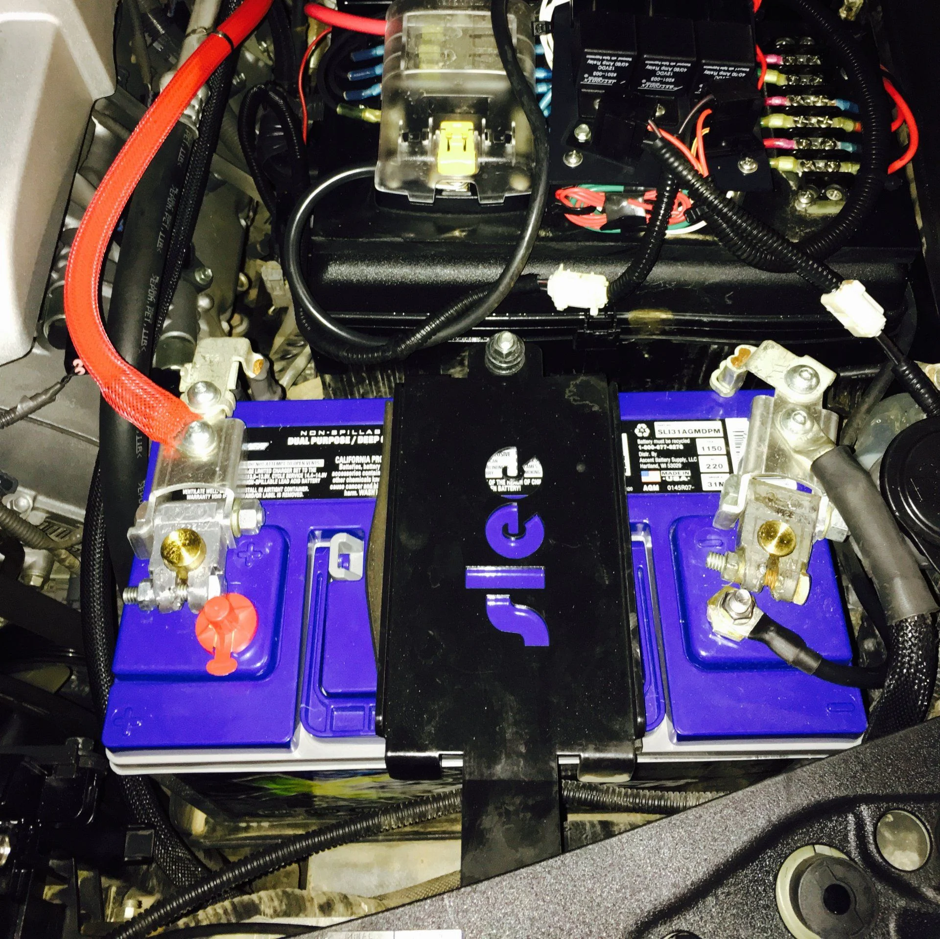

And... my OEM battery died after a year and half. I recently noticed a ton of acid creep up out of nowhere, cleaned it off, and then the battery lasted like two more days. It's technically within warranty but the local dealer was not able to do the work to replace it quickly enough (going on a little road trip this weekend) so I popped into Batteries Plus and bought this Group 31 X2 Power monstrosity. It apparently has 1150 CCA and they gave me a decent discount on it.

What's part number on battery? I am gonna switch mine when factory one die in an year.

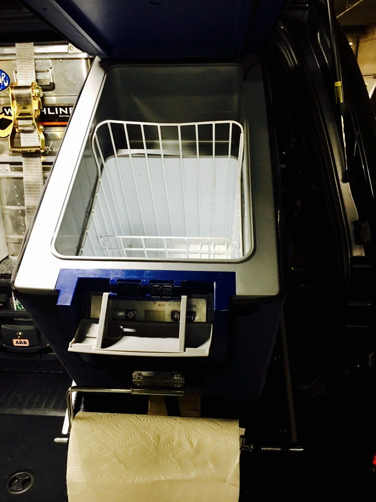

As I alluded to in another thread, I've been exploring ways to squeak out a bit more storage space in the rear cargo area. I built a small birch plywood box to reclaim some storage space below the refrigerator. However, even with a sliding drawer, actually using the refrigerator that high would be impossible... unless there was a way to tilt the fridge down.
In conjunction with the box, I installed an Alu-Cab Tilting Fridge slide. So far so good... I really like the setup though we'll see how it holds up offroad.
Anyone else ever service there battery every couple years by prying the caps off and add distilled water seems to make them last along time

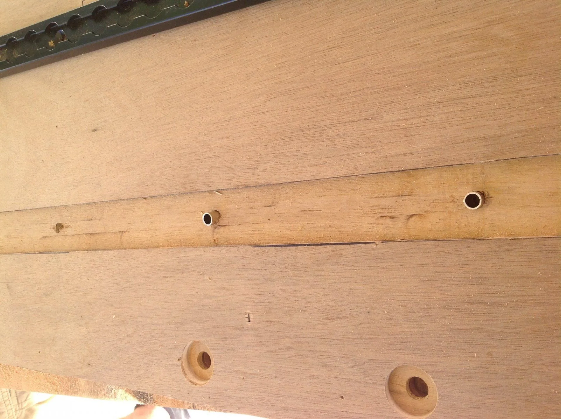

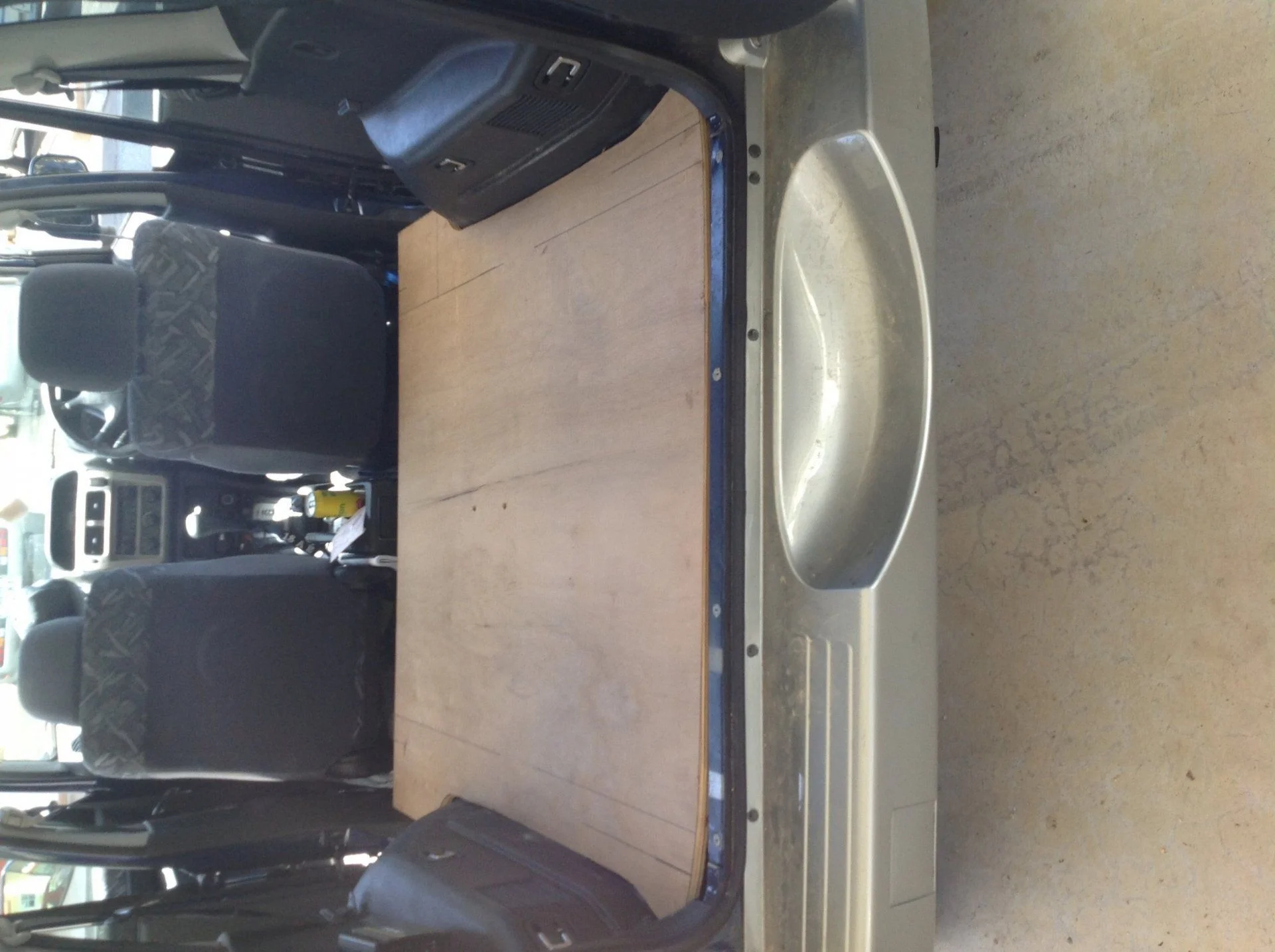

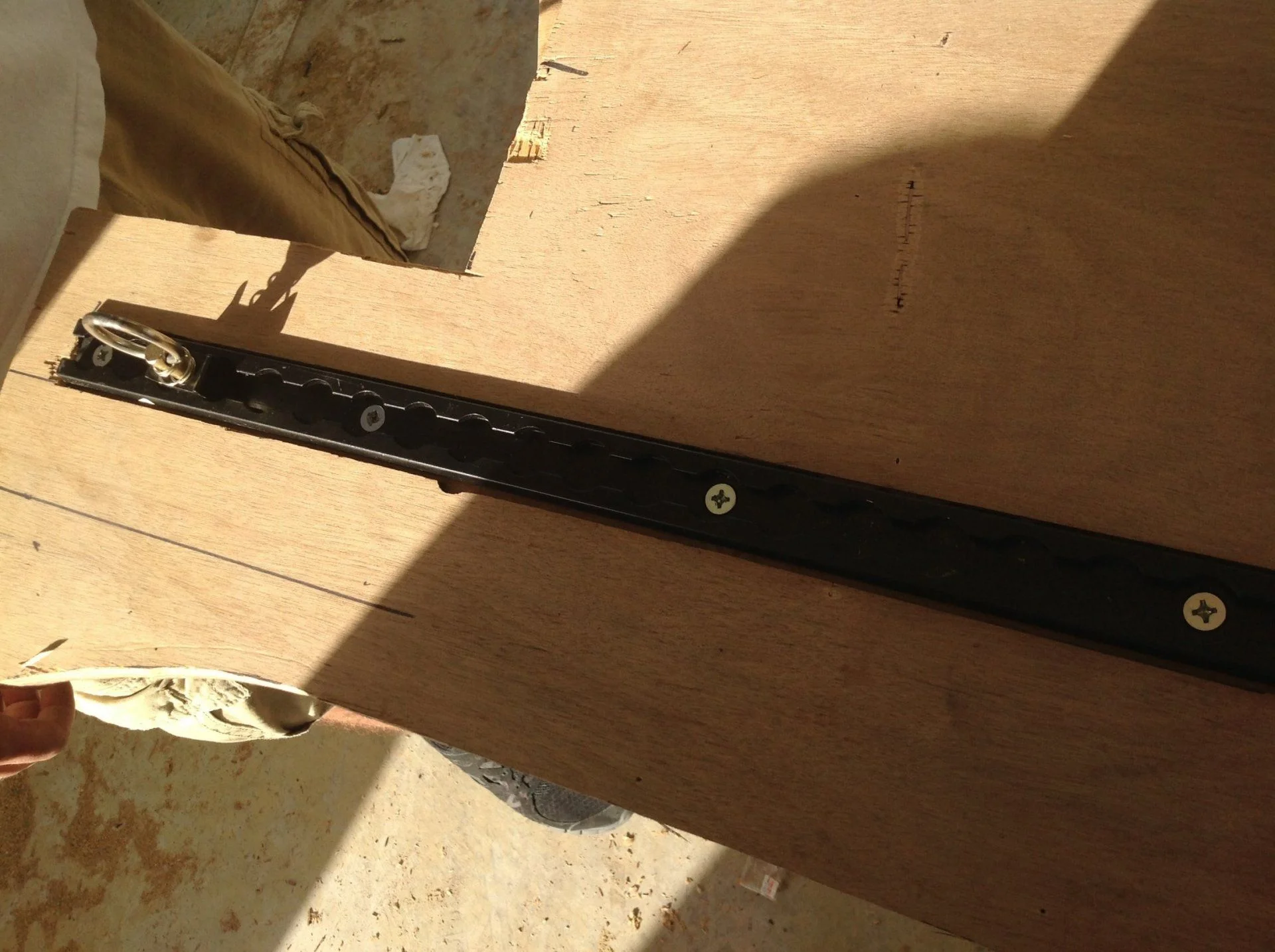

I had a Pajero iO for a bit. I ripped out the rear seats and built a deck to support camp and dive trips. The failure point would have been the bolts ripping out of the floor pan in this case. I used 1" marine ply. The seat track rails were recessed to 3/4". I used 3/4 ss shanks to "sleeve" the wood and 2" ss washers on the underside of the wood. The board itself was mounted into the seat fitting (6 points) and cargo hook fittings (4 points). I used a combination of grade 8 and grade 10 ss hardware for assembly to prevent sheering and pull forces. I was lucky enough to have access to 5k pound seat rail fittings. I felt confident that I had 3x weight of 8 steel 100 dive tanks in restraint. One can never be too safe with stuff like that. It amazed me when I saw guys toss steel 100s at 3500psi in their trunks or back seat.

Nice! The SS shanks are a nice touch. If I had to do the entire storage install over again I'd look into first building a plywood platform from which to build upon that leveraged all the frame points. Even the ARB drawers leave a couple mounting points unused.

Cole, have you thought about putting extra storage on top of the fridge instead of making the fridge sit higher. if you aren't going to access the fridge while in the truck, it would make it easier to get stuff out and lower the center of gravity having the fridge lower.
Yeah, that was initially my approach but prototypes posed some problems. However, I would still need the fridge to roll out with the shelf remaining in place and there wasn't a feasible way to do that without eating up too much room to the sides of the drawer. But, yeah, I'd definitely have preferred to keep the fridge lower.
