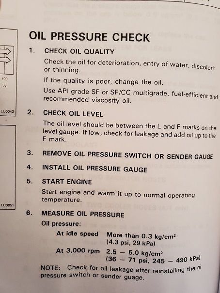

Chain slack is taken up by the tensioner, which has a spring in it for initial tension, then the oil pressure creates the force to take up the slack. If you are up to it, I would replace the oil pump AND the chain tensioner. You could also do an oil pressure check, with a REPUTABLE MECHANICAL gauge (not electric).

Oil pressure is 9lbs hot idle based off a gauge out of a professional grade test kit. Test was done on 5w30. Normally run 10w40 and thats currently whats in it.
So even if the guides are good the chain if not being tensioned properly will clatter/rattle?

Obviously 9 lbs hot idle is NOT good. I assume this was checked with a mechanical oil pressure gauge?

Nine pounds at idle is within spec.
