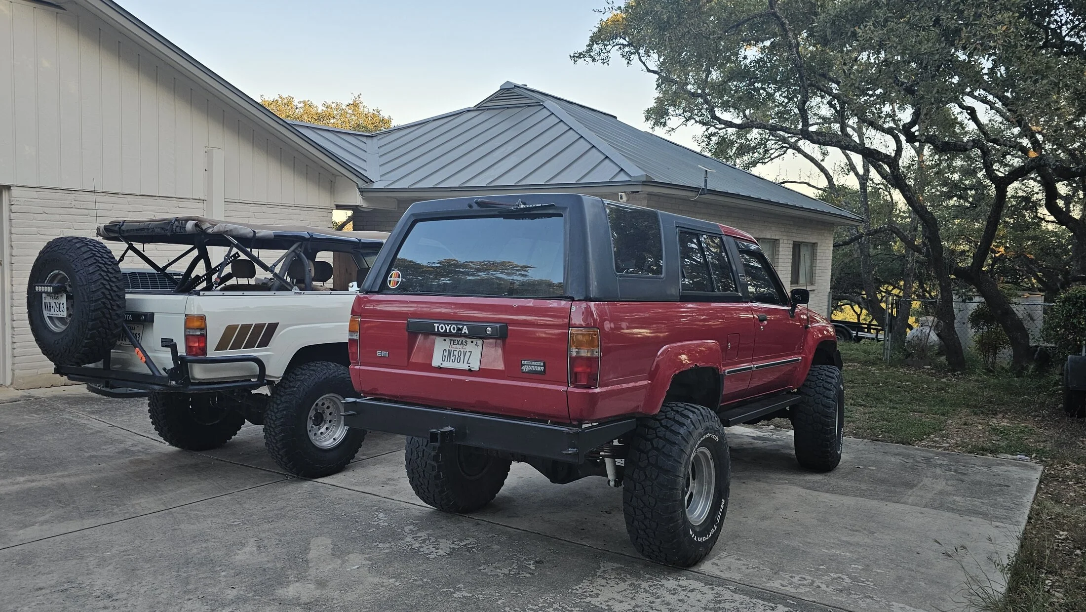

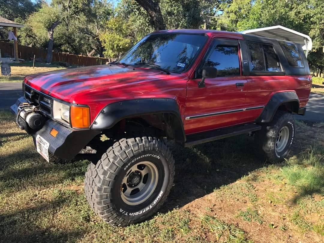

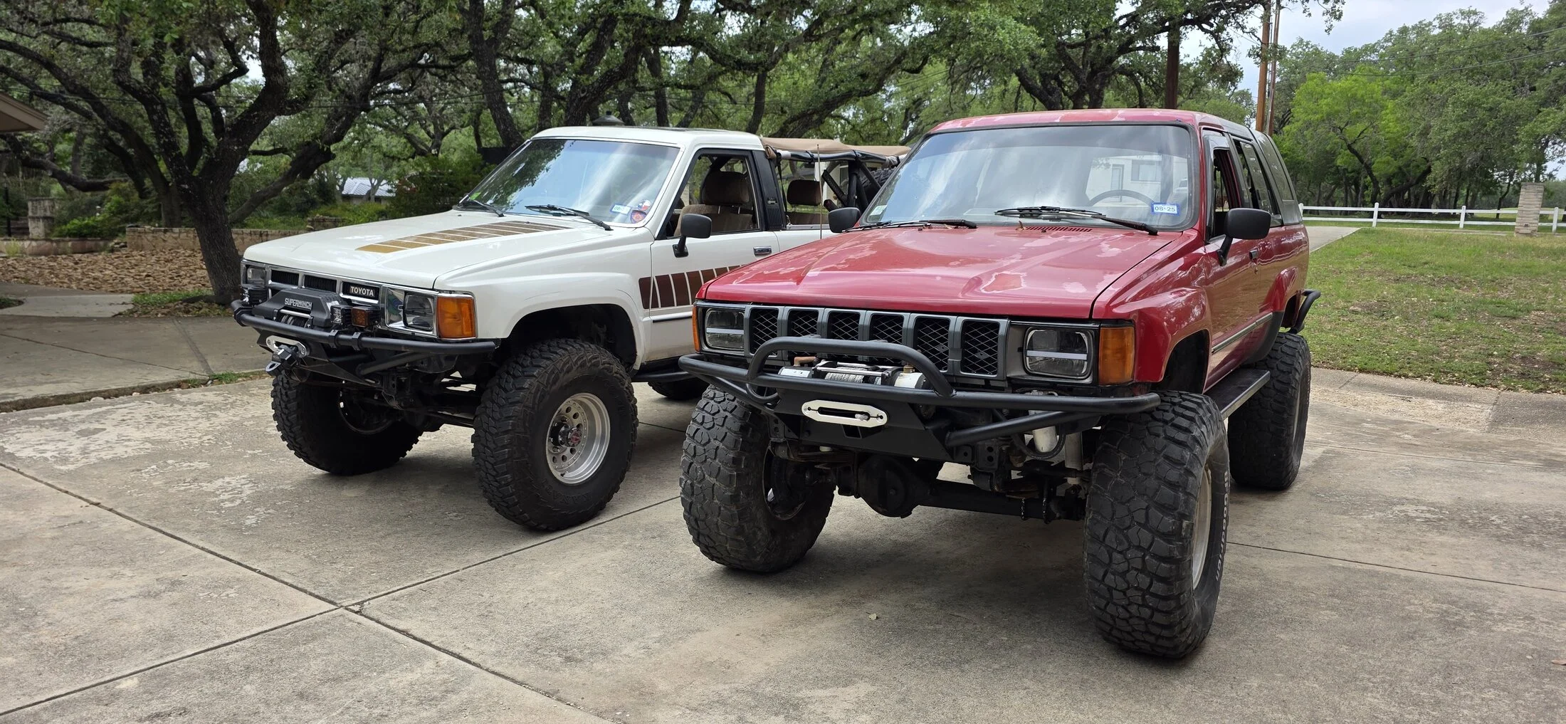

What could be better than owning a '85 4runner? Owning two '85 4runners of course! I thought I'd to start a new thread for this build, to keep the projects separated. For those that are not familiar you can see/follow my other build "Mud-life Crisis". Builds - my MUD-life crisis, 85 4runner - https://forum.ih8mud.com/threads/my-mud-life-crisis-85-4runner.1226817/
I recently came to the conclusion that damaging my white SR5 is inevitable if I keep pushing it. It'd be foolish of me to turn it into a tin can. So here we are with a rig that I can wheel a little harder and not lose sleep over if it gets a little trail tash.

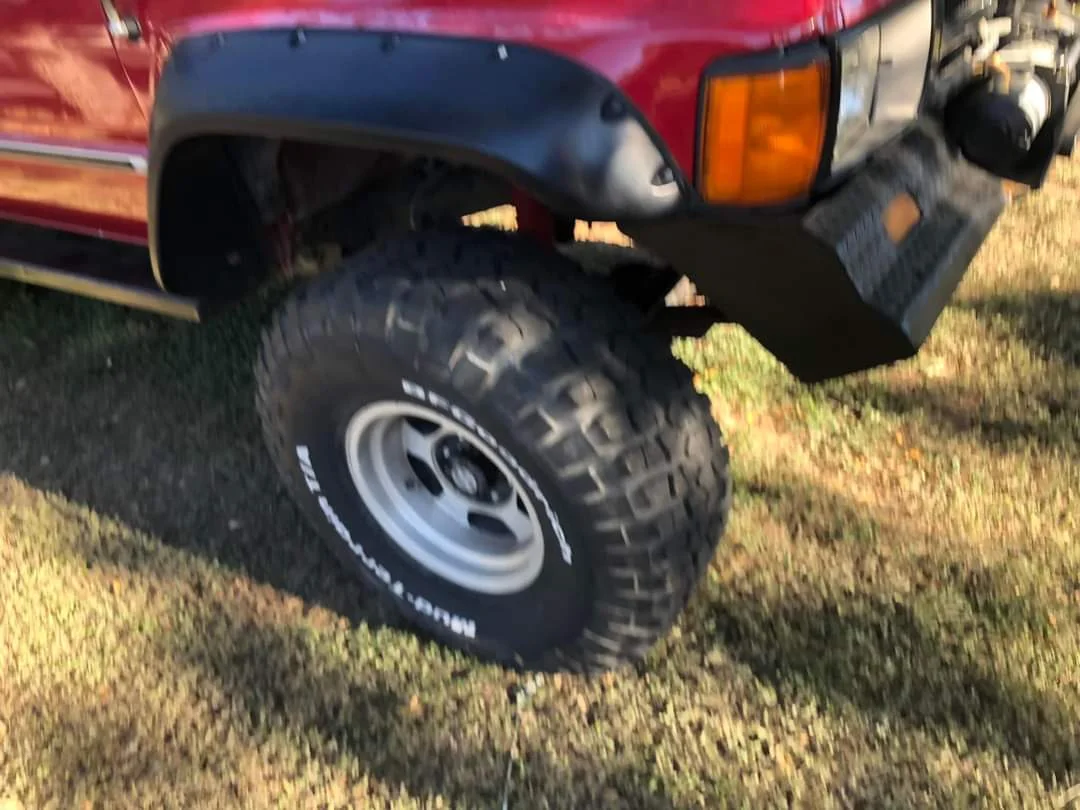

As many of us do, I was browsing FB Market place when I found this '85 DLX near me. The truck aready has a bunch of upgrades, that make it the perfect platform for harder adventures.

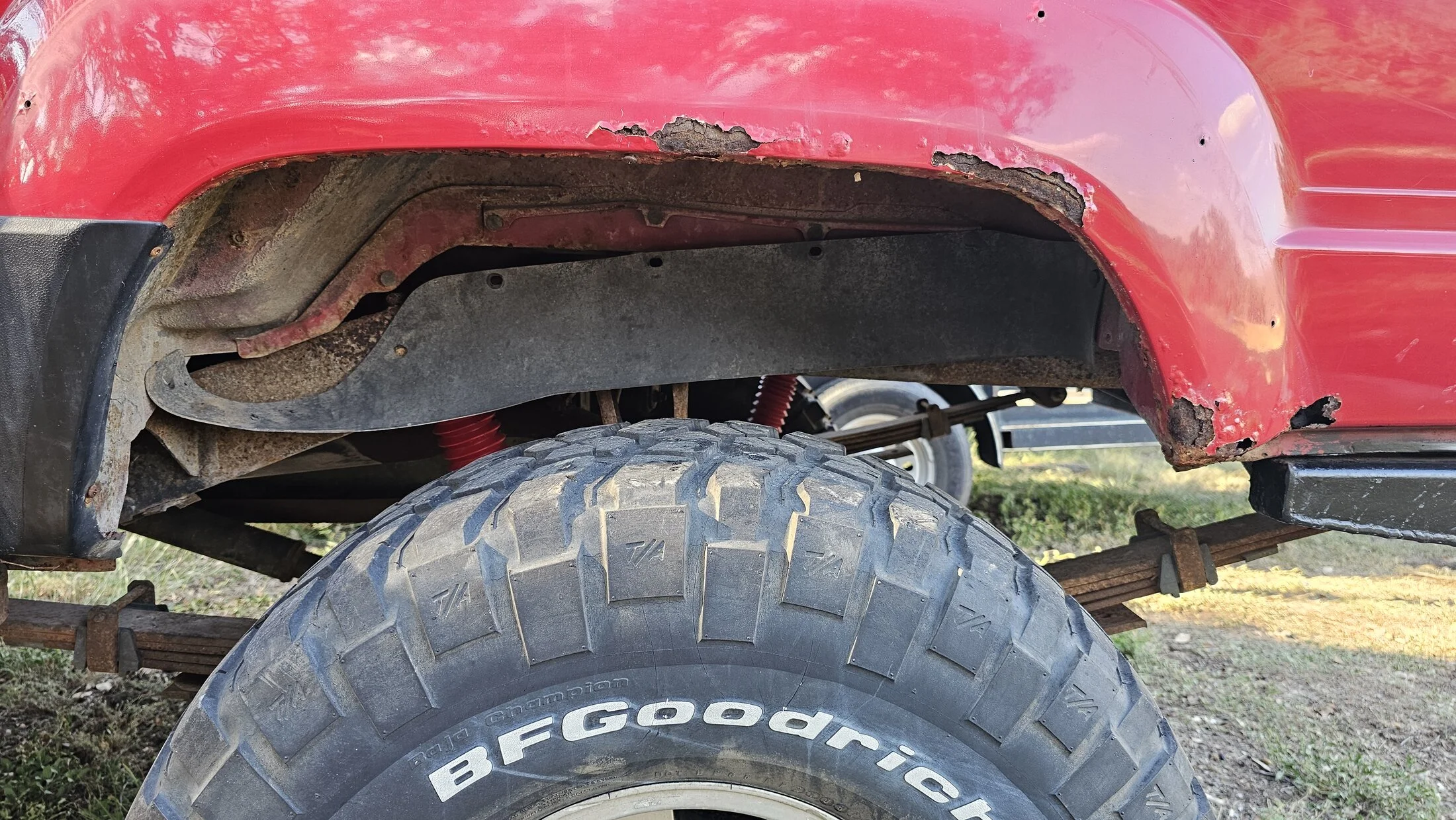

22re, AC, dual transfer cases (with one being 4.70) 5.29 gearing, unknown type rear locker, wider IFS rear axel, Chevy 63" rear springs, RUF, upgraded brakes (master cylinder, booster for sure) & cross over high steering. The work doesn't necessarily look like it was all professionally done, but it's not amateur or all butchered either. The interior is mostly there, the body is straight with a little bit of rust in the rear quarter panels. My plans are to go through it and make it my own with esthetics that mimic my white SR5.
If anybody has any information or knows who built it, please let me know. I bought it near San Antonio, but believe it's from Houston/Galveston area originally.

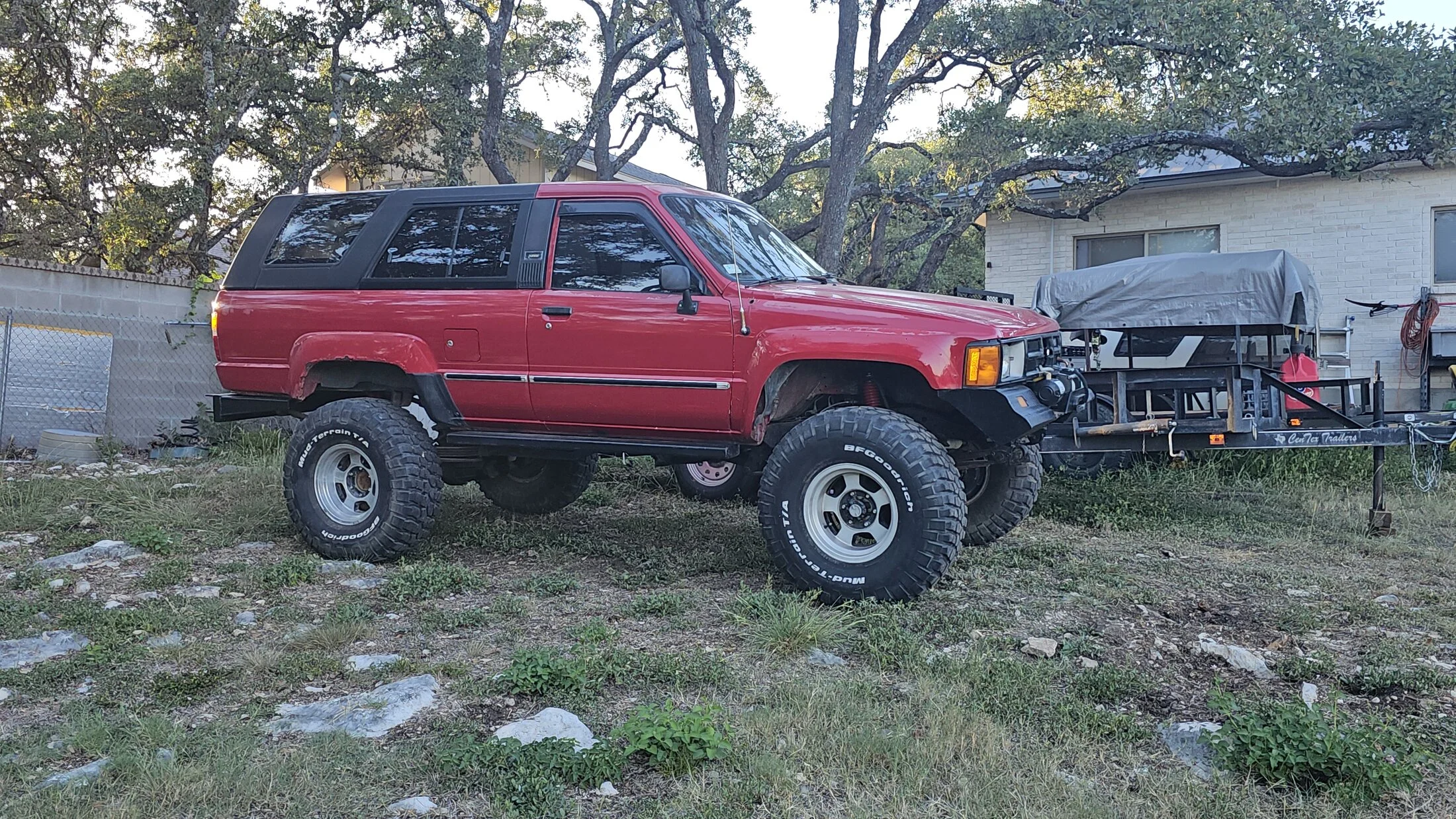

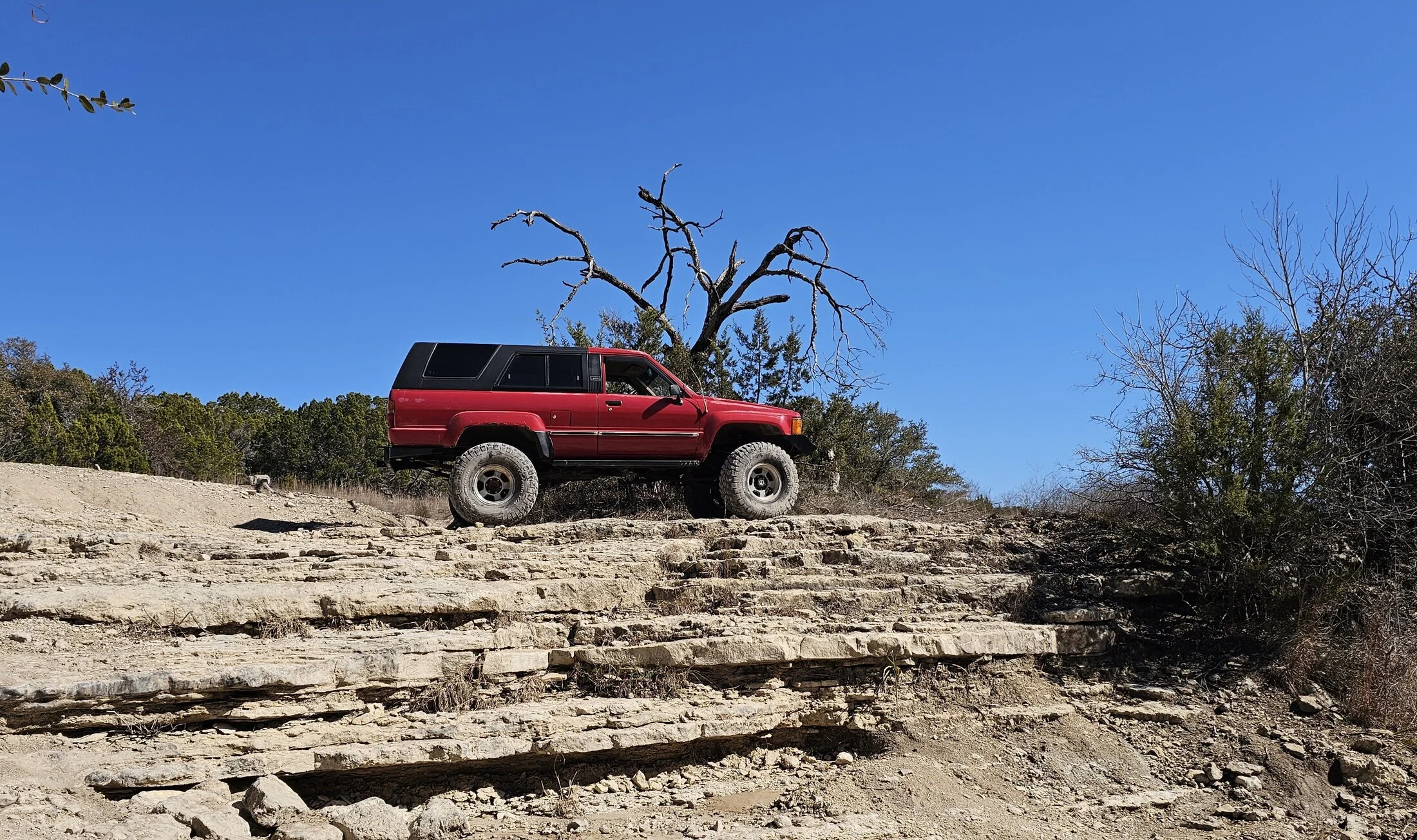

Sometimes life gets in the way of your plans, there has been little to no progress for this project... Hopefully things will be changing soon. I was able to test the 4runner offroad a little bit and am really impressed how well it did. I love the dual cases, really a game changer!

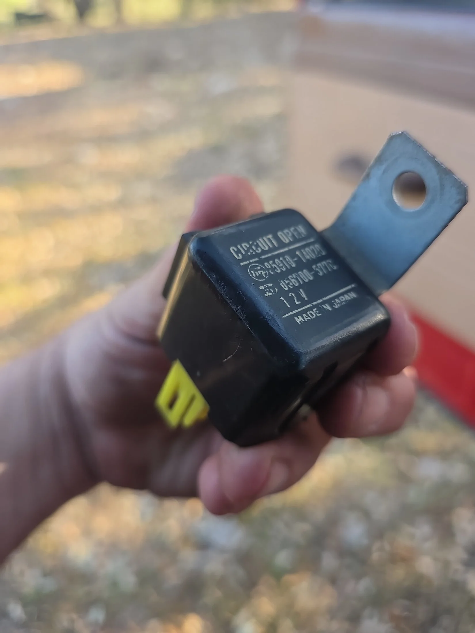

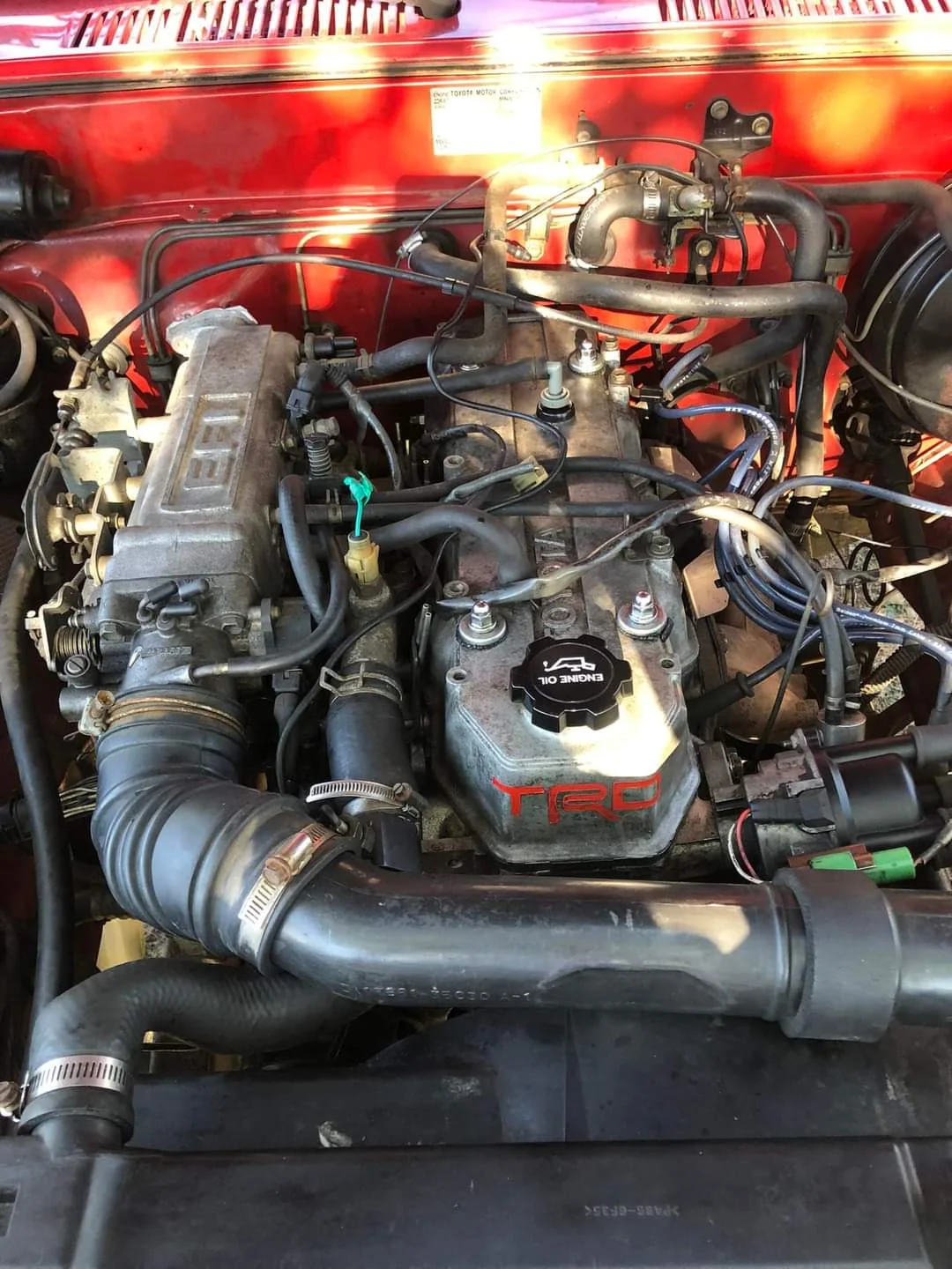

I found the culprit to a intermittent hard start-no start issue, I was having. Turned out to be an open circuit relay, behind the ecm.

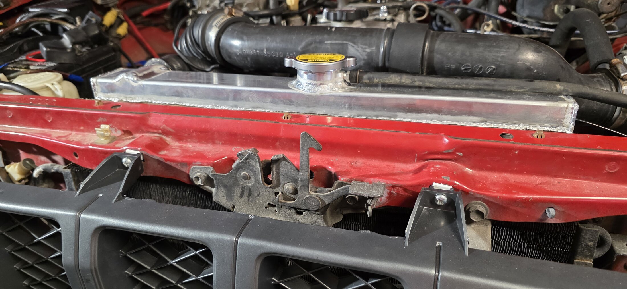

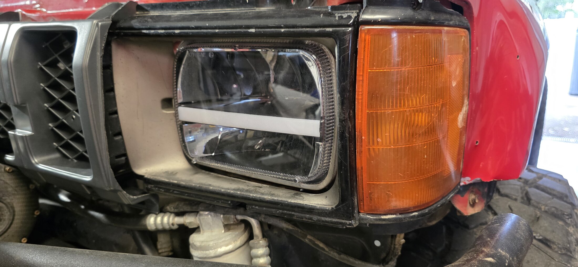

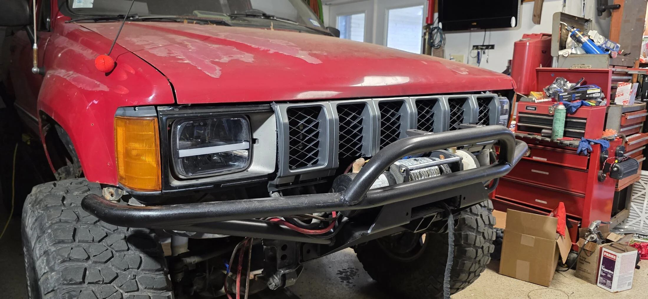

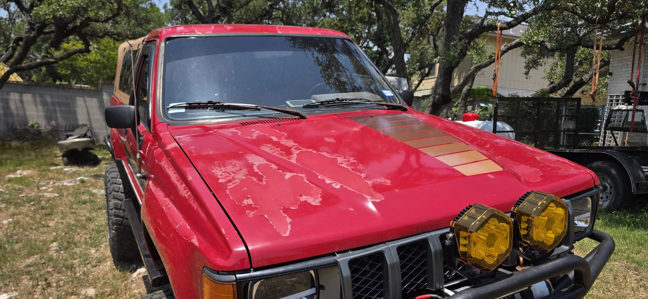

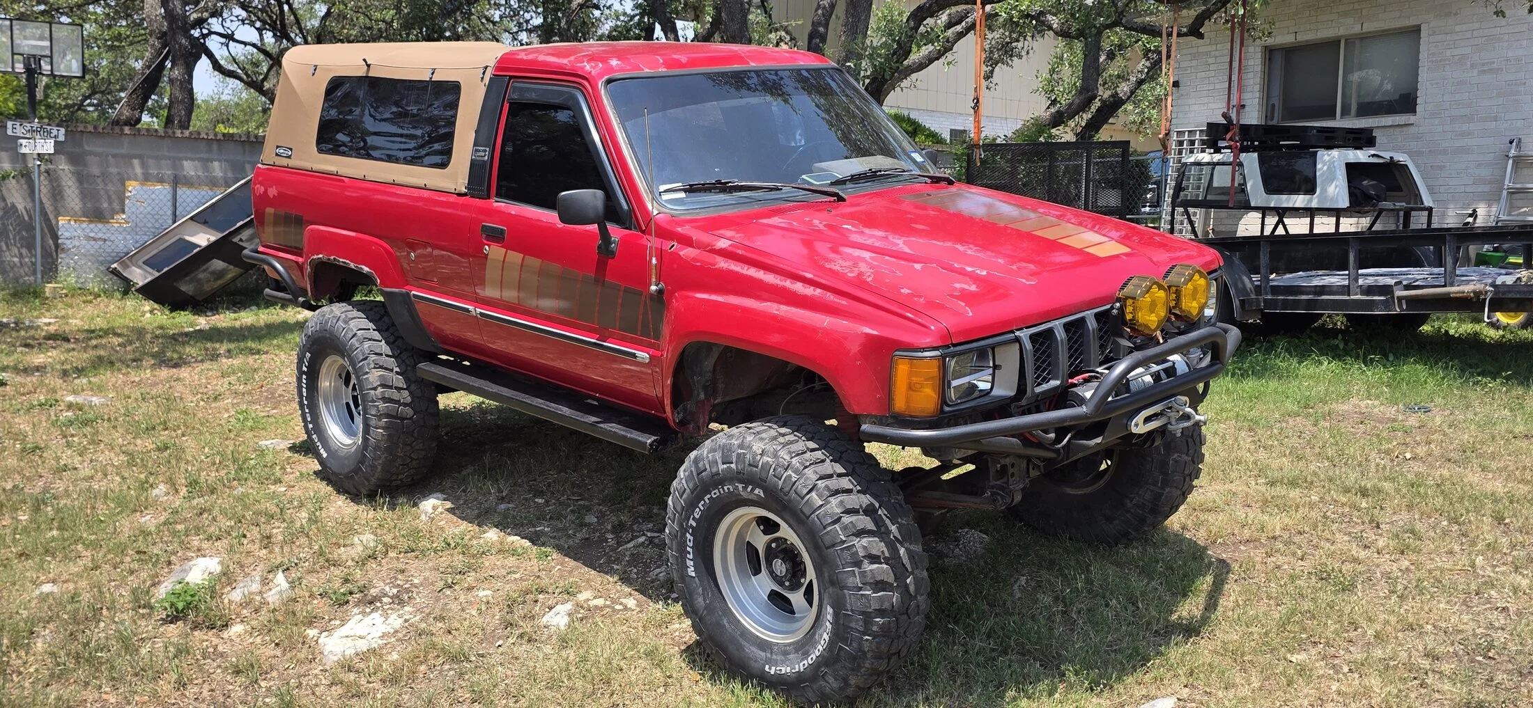

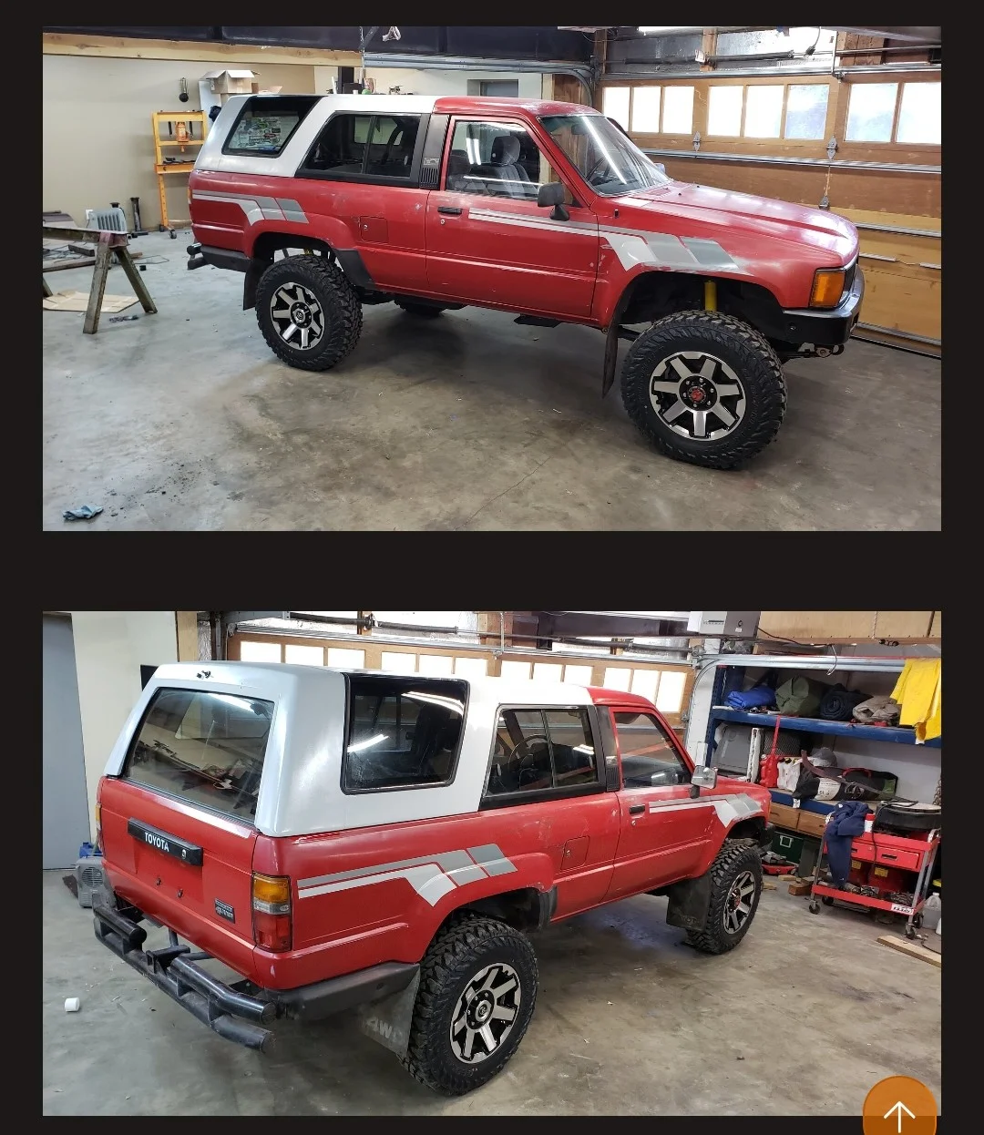

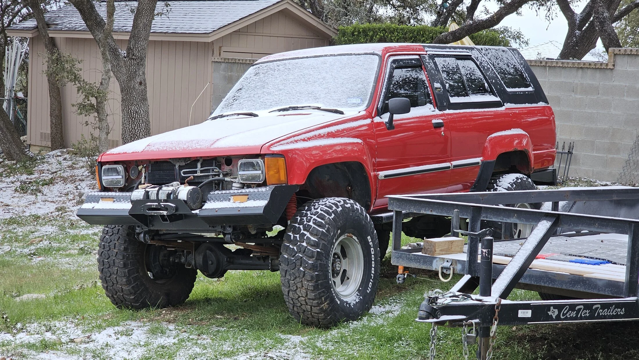

...mocked up the grill...
Mind walking me through the grill mock-up? I have the same/similar aftermarket grill I'd like to install on my 1989...but unsure the best way to make it fit...and haven't found any write-ups on the typical forums. (your 4Runners are boss).
@G-Cat sure, I used the center section of 82/83 grill and the stock 84/85 bezels. There are two factory mounts that line up along the top of the grill (unsure if there any on the bottom section, I had to cut out some of the grill for the winch) I had to trim the stock bezels a little to make them fit, but they are still held in place with factory mounting hardware. I used a dremel tool and took my time to piece it together. I used a few zip ties here and there as well. It doesn't look too bad, but certainly not factory finish. 🤙🏼

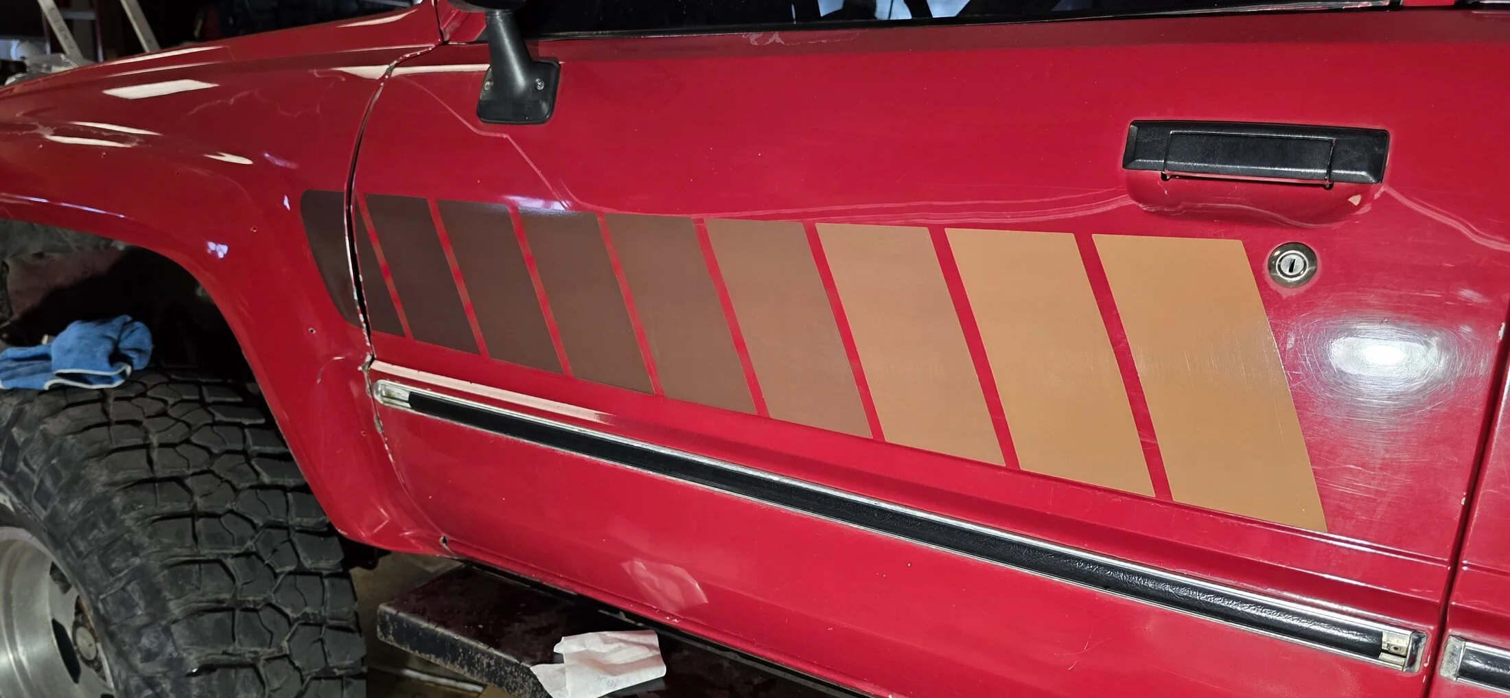

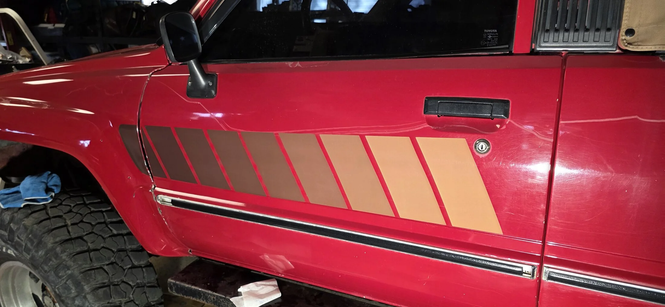

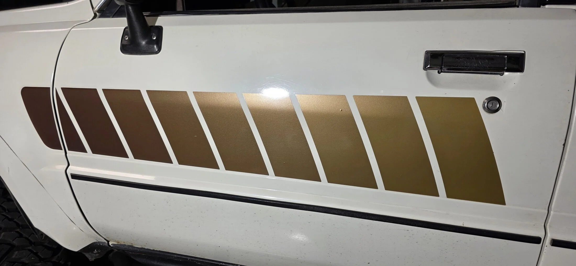

84/85 Toyota graphics are the coolest graphics ever!.. but I might be a little biased.

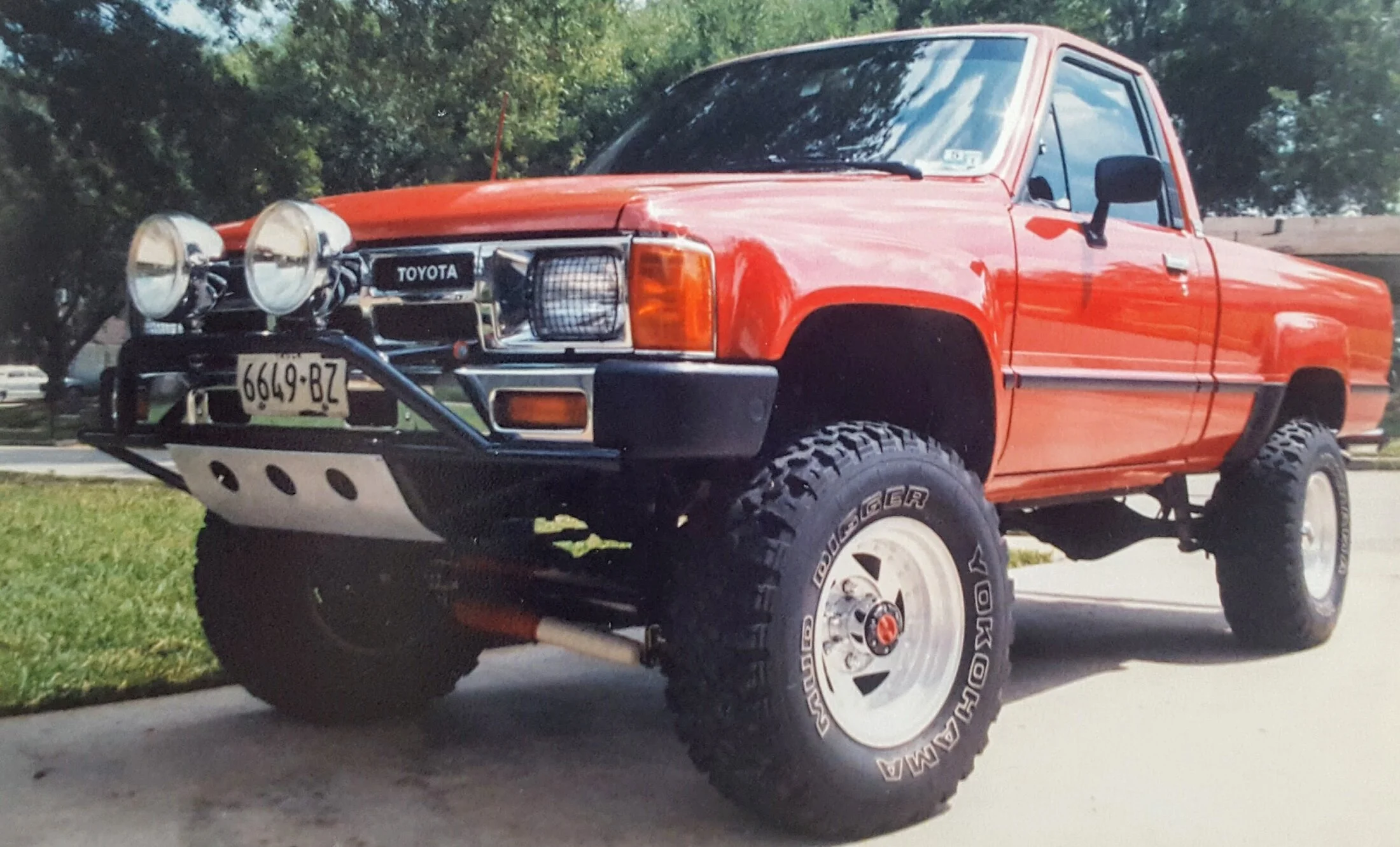

Circa 1988: my 1st truck was a red 1985 SR5 with graphics, how could I not put them on this 4runner?
Gangster
are these James dean creations? A

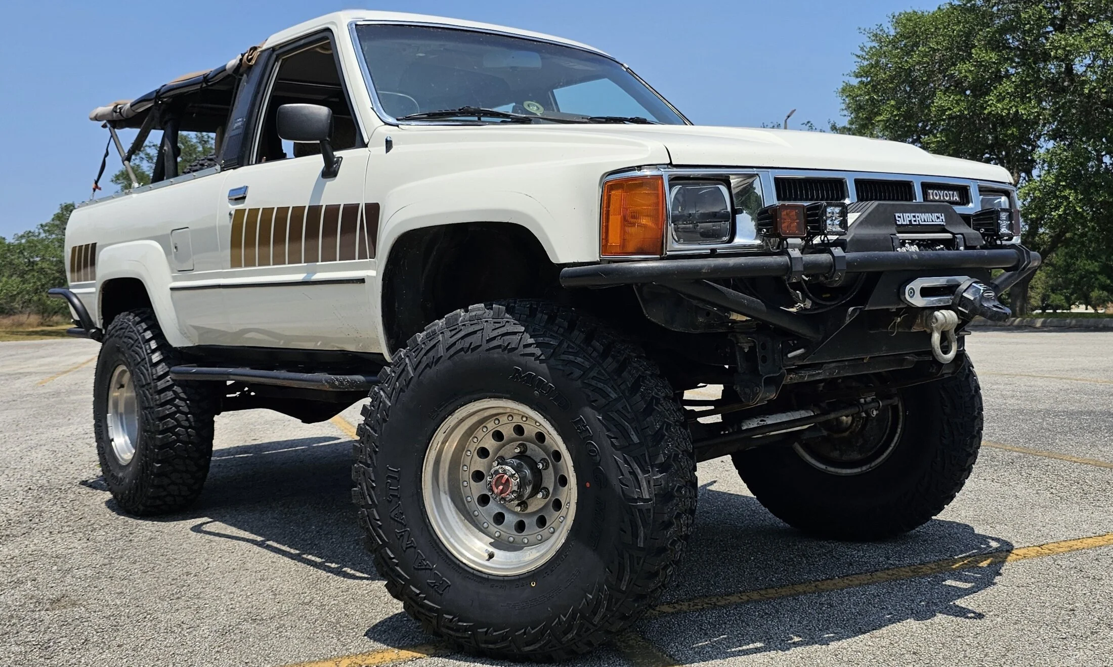

@gnob I ordered these are from B L Vinyl found on Etsy. I have James Dean Creations on my white 4runner. Price point is very close, (BLV is a few bucks cheaper) both are quality made products and use 3M materials. The BLV are more monochromatic coloring & the JDC have are a little more vibrant in color. BLY color is light brown & JDC color is gold-brown.
Our first ever new truck and first ever Toyota was a red 1986 4Runner with that style graphics. My wife's dad had a red 84 pickup with the same. His was already toast from the AZ sun so .................I pulled ours off soon after getting the truck. :doh:
I did the same with my 1st truck.. I wasn't wild about them back then... but now love the retro cool syle. 🤙🏼
