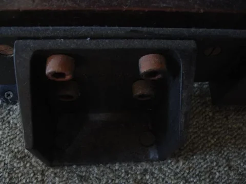

Well here's some black cap screws that I used in the lounge inside my house:
They looked nice and black when I fitted them about 5 years ago but they're clearly rusty now - and that's just from exposure to "humidity"!
:cheers:
PS We have healthy earthquakes here so I keep some of our furniture bolted down pretty well :D (Those brackets - one at each corner - secure a very heavy 100-year-old pianola to the floor joists.)
