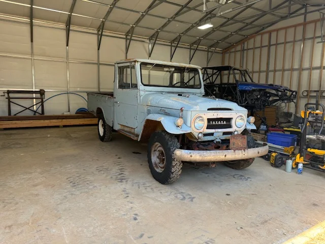

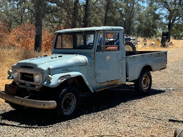

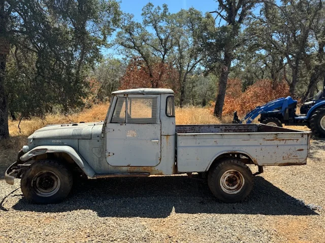

I saw a link to this one posted in the FJ45 classified section after I picked it up off CL. The frame damage is a bummer but I already picked up a donor front frame section and have the ability to get it repaired right. It is very complete and original. After inspecting it, we agreed to a price and I drug it home. My plan is to get it running (already done) and driving and clean it up the best I can without getting rid of too many bumps and bruises. So far, I’m very pleased with the condition. I gave it a good wash and will start polishing once I get it on the road.
I’m sure I’ll have lots of questions as I go. I have been around FJ40’s since I rode home in my dad’s 67 when I was born but the 45 is a new world in some ways.
BTW, the title says it’s a 67 but vin says it was built 5/66. It was listed as a 65 but I was expecting the update that it was really a later one.

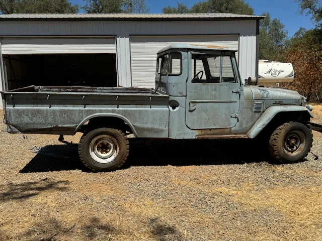

So far, the frame looks straight from the crossmember back. My plan is to cut the outer “C” of the frame under the shock mounts and rivet the donor portion to the inner “C” to get it lined up. I’ll tighten weld the frame up the rivet the shock mount back on as a gusset. I’ll probably also add a fishplate on the inside with some rosettes. I hope that makes sense, haha.

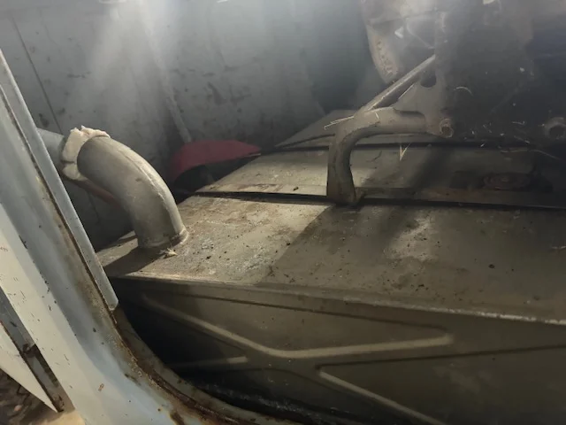

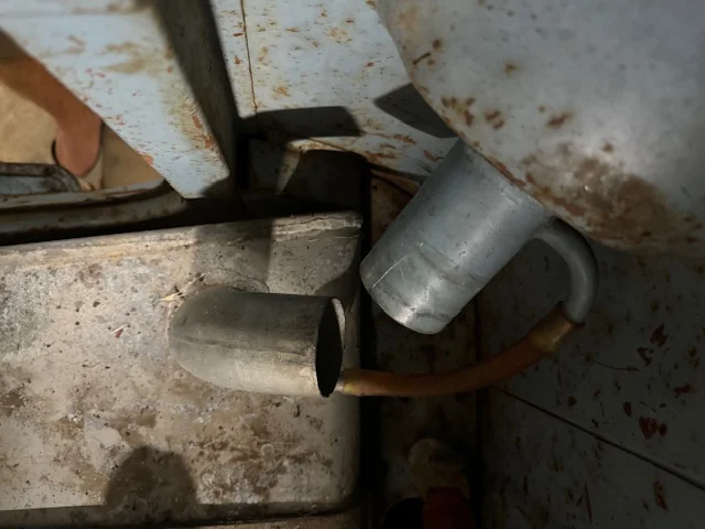

The fuel tank looks to be in really good shape. I’m not sure if it’s original or not. It has the snorkel filler like a later 40 but only has the one fuel outlet without all the smog fittings. Does the tank and fill next look like FJ45? They sort of line up but not great.
