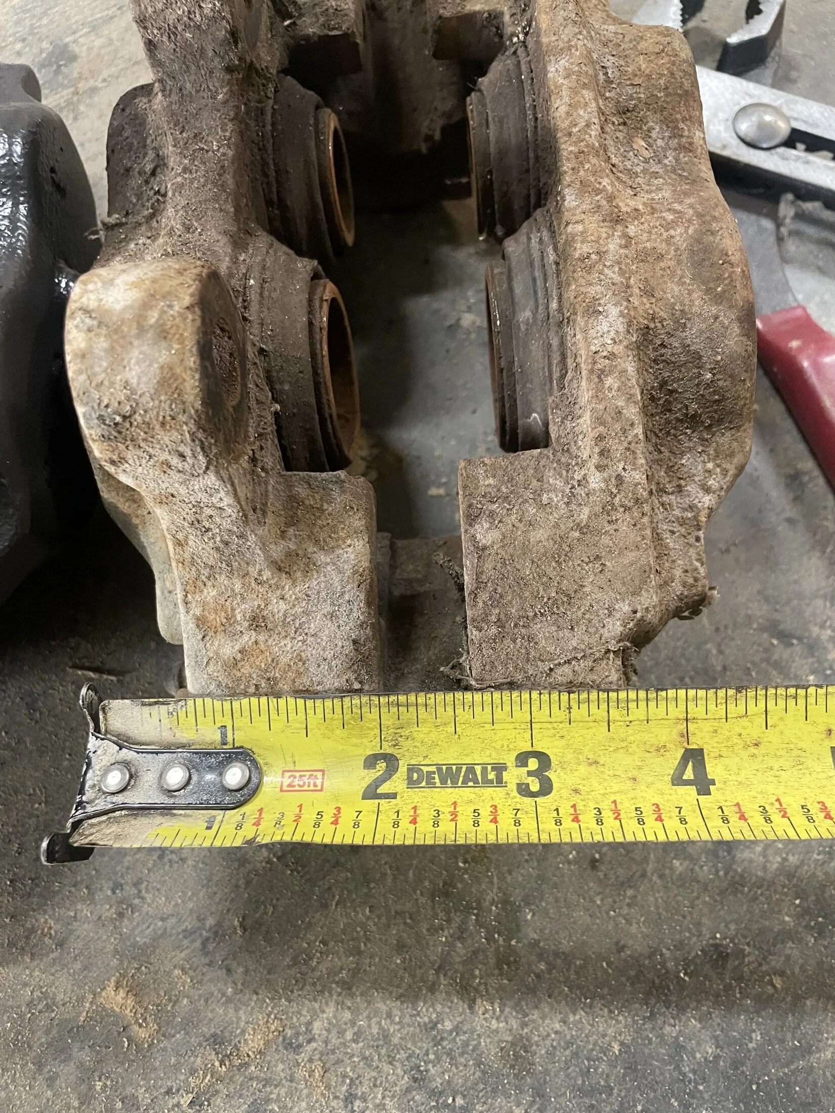

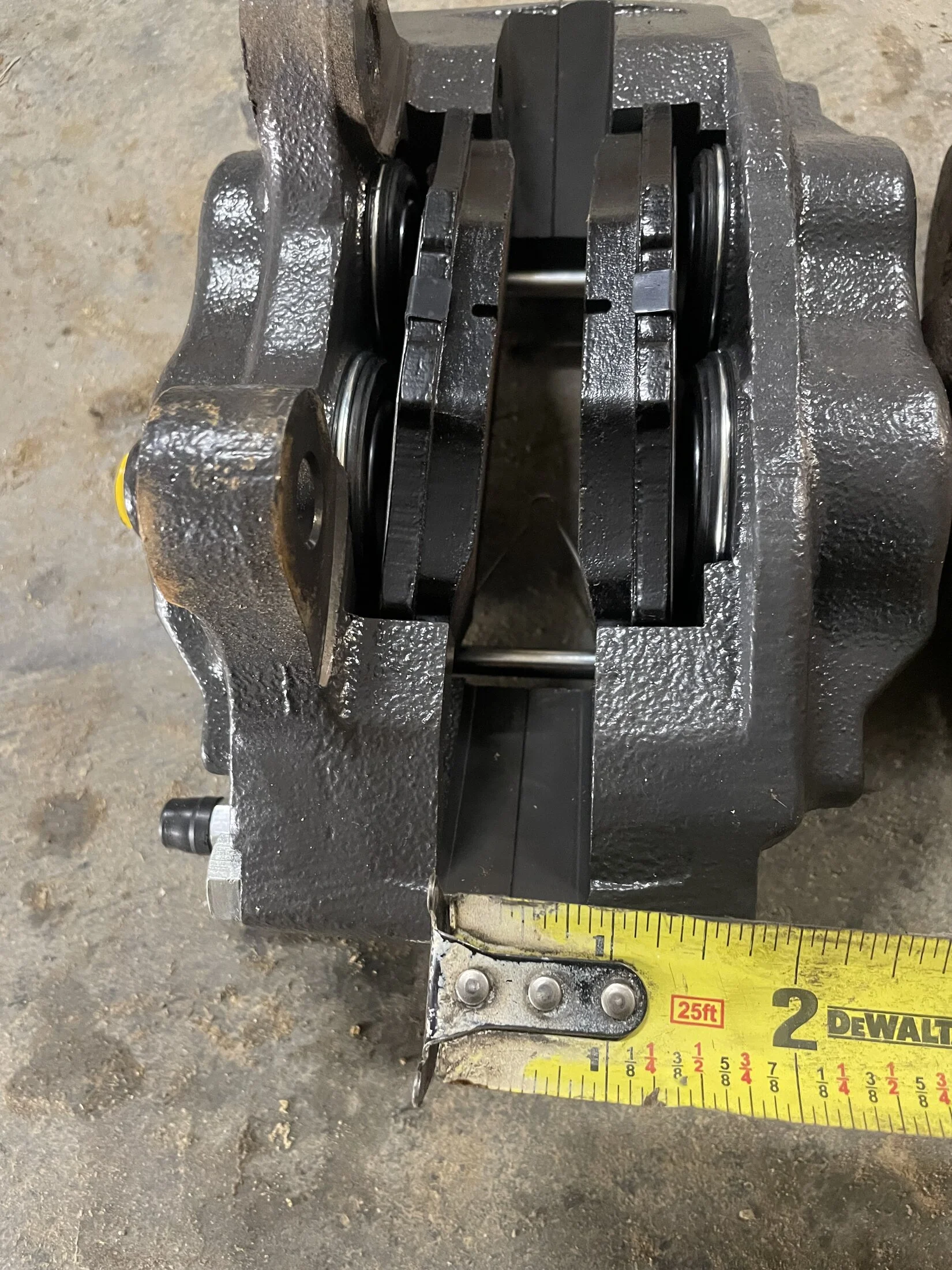

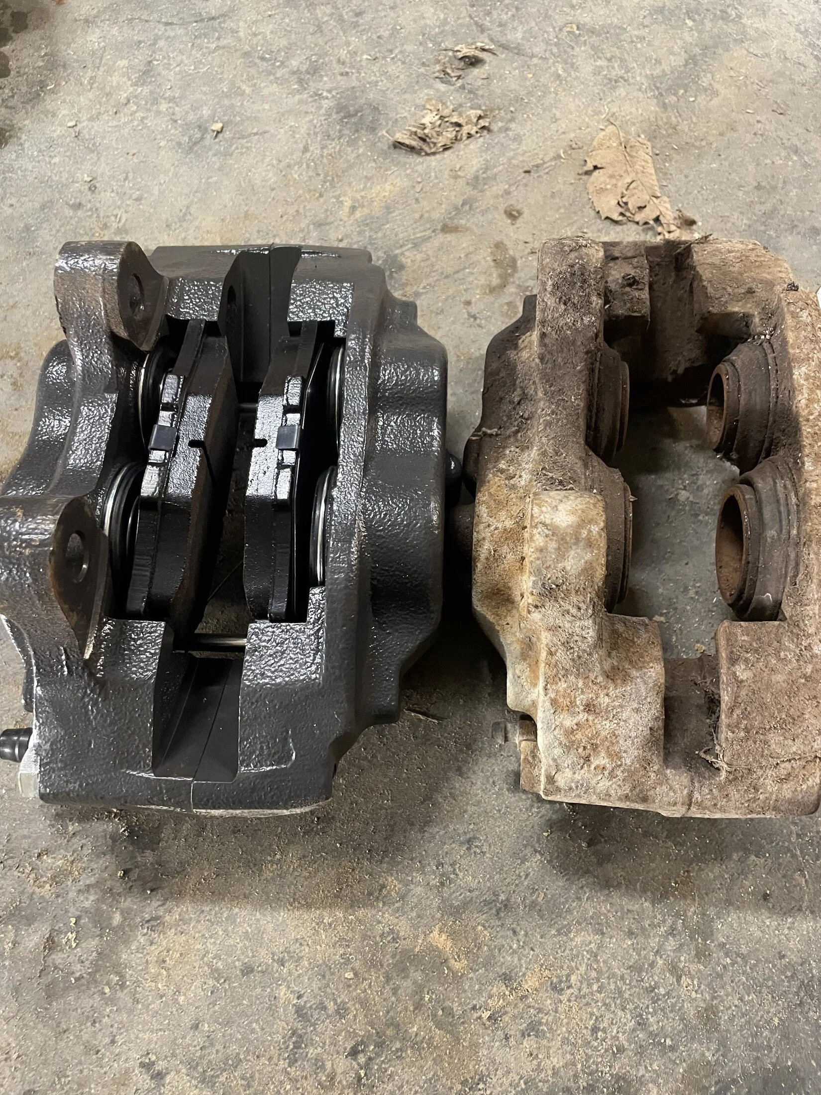

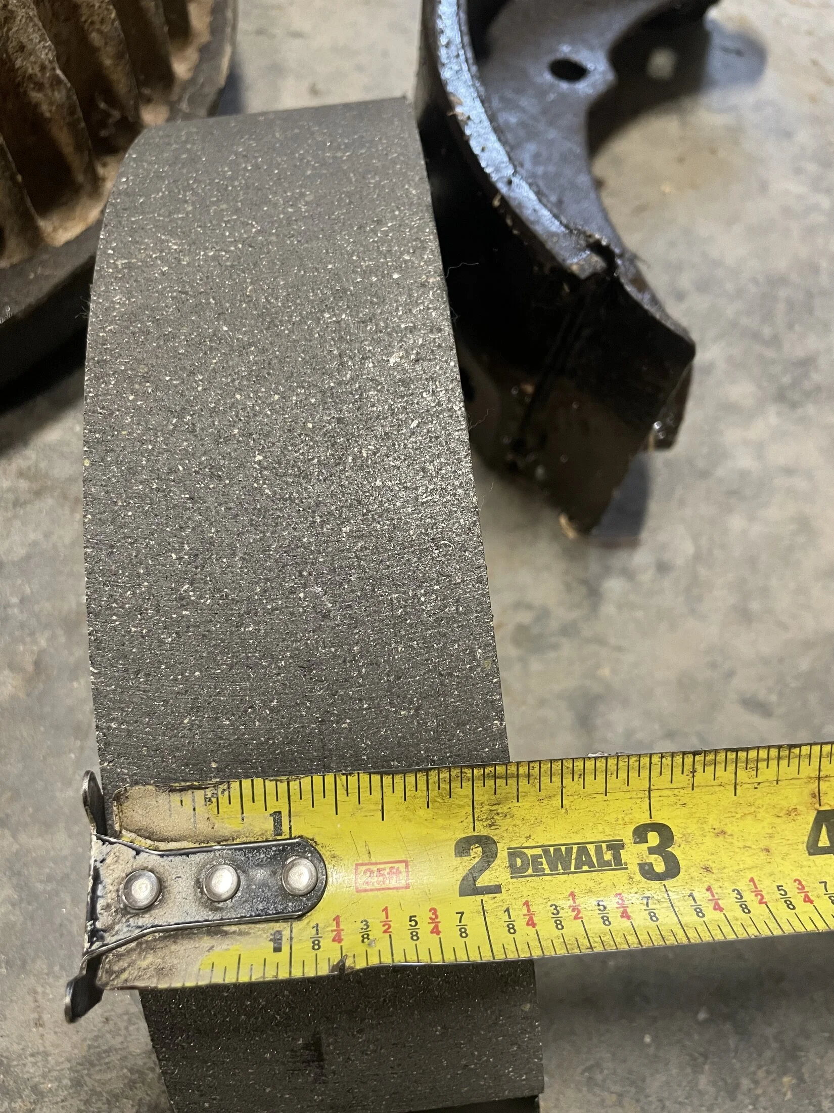

Btw this is a semi float rear axle. I’m wondering if a rear disc conversion would even work on this axle since most are made for the stock 40 series and there is something different about this rear axle than I’m used to.
Seems like you should be able to swap the 40 rotors onto the 45 hubs so you can use your new calipers/pads on the front. Then in the rear, will the narrower shoes fit the wheel cylinders and just lack the filling the 45 drum?
Haha wow.. dodgy previous owner!
That was my thinking also for both. Just worried something else might go wrong with the front I’m not seeing. For the back I was going to try that but wondering if they might flop around in there and pop off without the extra width. I’m tempted to run the front with new pads and see if they will bleed and might even jerk a rear axle out of a junk cruiser here and bolt it up with the regular drum brakes, or the rear axle out of the pig…decisions…decisions
Fastest getting on the road fix would probably be to try the 45 calipers and new pads on the front and the narrower shoes on the back and hope for the best!
Looks like you have mini truck front rotors and calipers (solid vs. vented rotors) which was a pretty common swap back in the day/or in the third world where 40 series never got front disc brakes. You can just swap them out for landcruiser rotors and calipers, you want to use '79 and later style rotors since they mount to the backside of the hub with two locating bolts and the six studs just like the mini truck rotor. The 76 to 78 rotors mount to the back of the hub with six bolts.

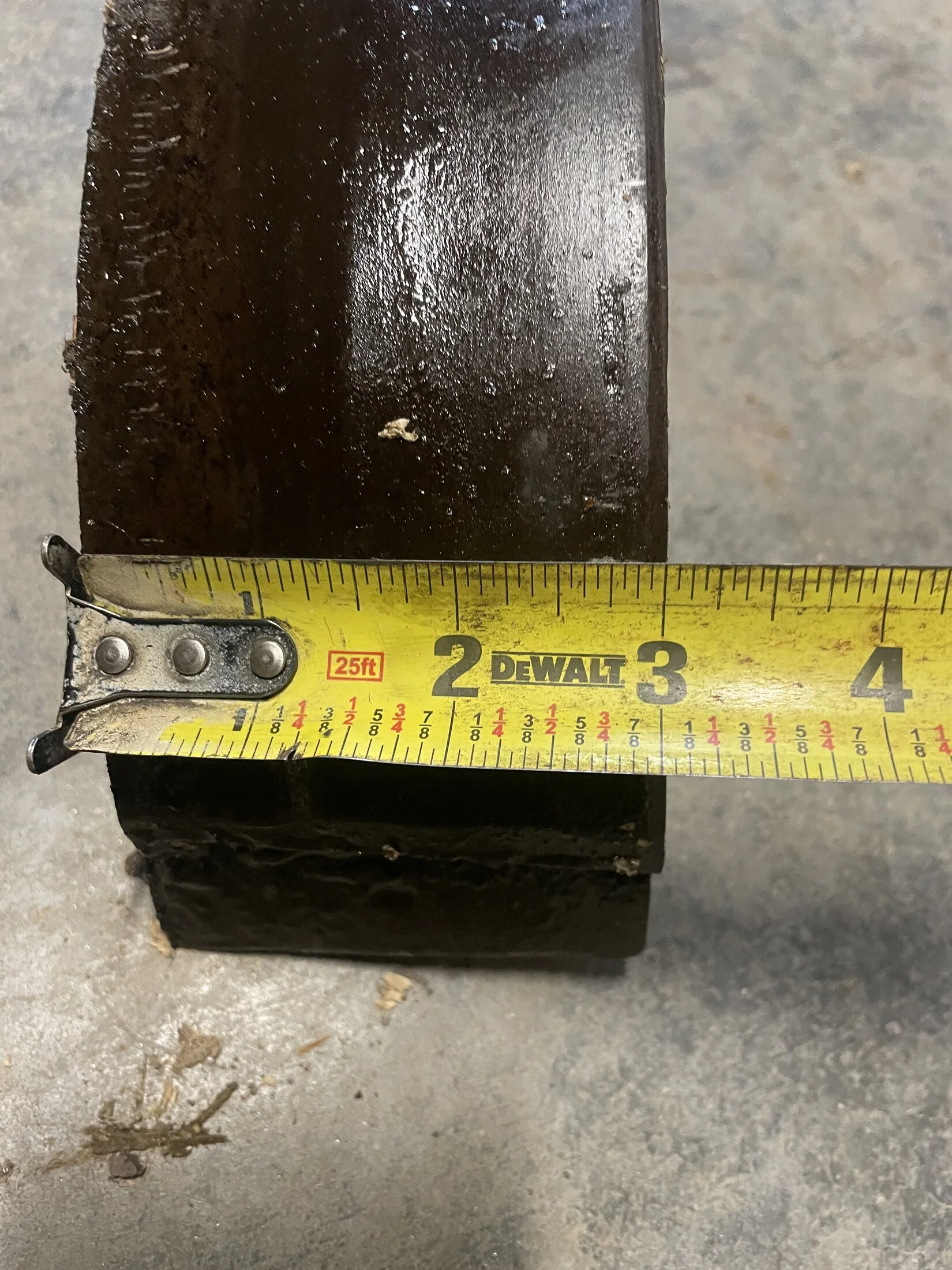

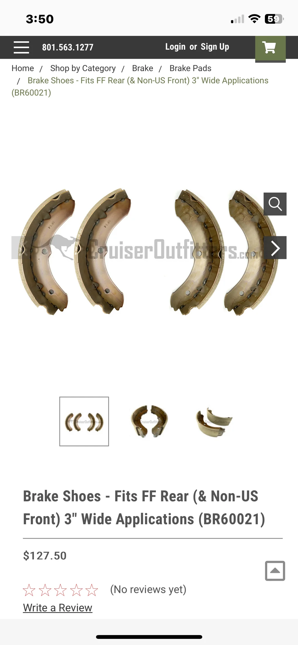

Shoe comparison.
A stock 55 series drum doesn’t fit. It’s too deep and hits the backing plate.
There are quite a few iterations on brakes. The 45 and 40 generally dont share rear brake parts from about '75 onwards.
If you have the parts from the 55 or any 40 series rear (backing plate out) you can swop the whole assembly over and make life easier to get parts in future. You only need to pull the shafts and with the oil on the one backing plate you likely need to do the wheel bearing seal in any way.
The front solid disc is most likely from a SFA Hilux. The solid front ran up to 1995 in Africa spec Hiluxes, unlike Stateside where you got IFS much earlier. It's a bolt-on upgrade.
