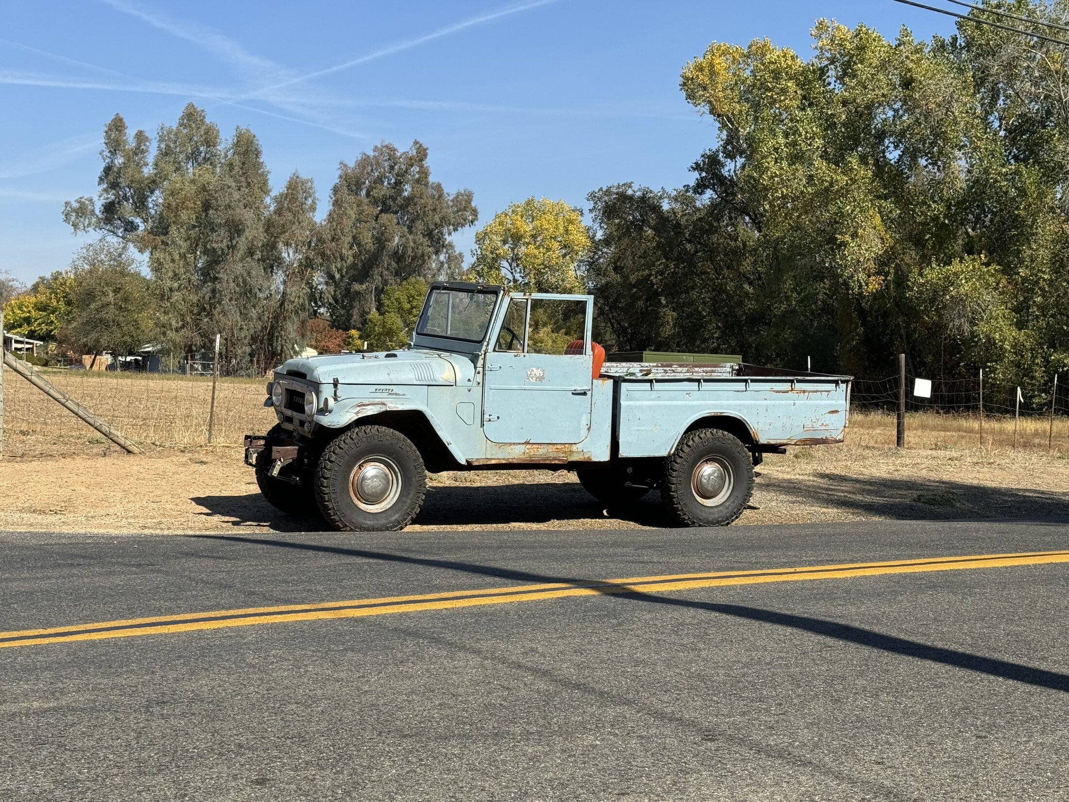

I guess I’ve been slacking on the updates. I picked up the lift kit from Georg last week and put it on. I should have bought new shocks and U bolts from him but didn’t for reasons that didn’t work out. I also picked up some new MT MTZ tires and really like how they look. It drove out of the shop for the first time yesterday. It hasn’t been registered since 79 and hasn’t been driven since the PO bought it in ?84?. Heres the pics before I lose everyone with my incoherent rambling…haha.

Thank you, I’m biased but they’re awesome!
Dustin, what great pics. Makes me miss my long bed. I'll be putting those springs on the LV......perfect height. Looks awesome. Great job.
Thank you! I agonized over whether to lift it or not, and over which tires to use, but I’m thrilled with how it turned out.

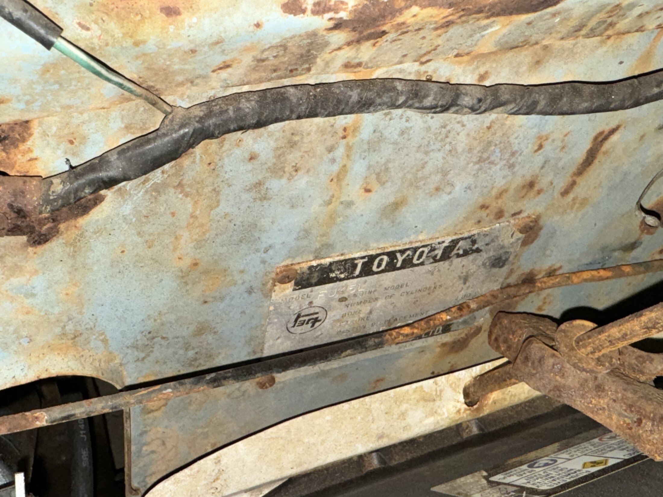

I did find the brass tag. It’s in an unusual location under one of the emblem nuts on the right apron. It’s T-67 which should be expected. I couldn’t find any indication that it wasn’t put there originally or that the vin tag had ever been off. Who knows. The other weird thing is that 2 of the emblem nuts are on backwards.

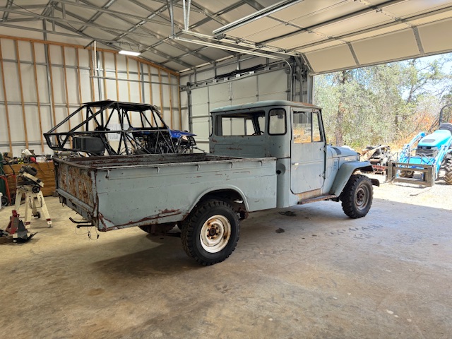

I saw a link to this one posted in the FJ45 classified section after I picked it up off CL. The frame damage is a bummer but I already picked up a donor front frame section and have the ability to get it repaired right. It is very complete and original. After inspecting it, we agreed to a price and I drug it home. My plan is to get it running (already done) and driving and clean it up the best I can without getting rid of too many bumps and bruises. So far, I’m very pleased with the condition. I gave it a good wash and will start polishing once I get it on the road.

I’ve been watching for one that was complete and solid. This one has plenty of experience but is solid and complete. The necessary repairs are well suited to my abilities and I really like the originality.

Thank you! I didn’t notice a brass tag when I was looking at the vin plate but I’m going to have to double check.
So far, the frame looks straight from the crossmember back. My plan is to cut the outer “C” of the frame under the shock mounts and rivet the donor portion to the inner “C” to get it lined up. I’ll tighten weld the frame up the rivet the shock mount back on as a gusset. I’ll probably also add a fishplate on the inside with some rosettes. I hope that makes sense, haha.
Thank you for the link. I am working on reading through it now. Part of it is inline with my initial plan but there are some great ideas that I’ll add in.
