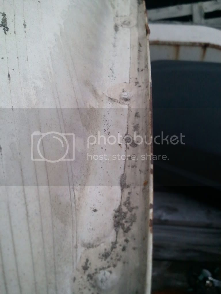

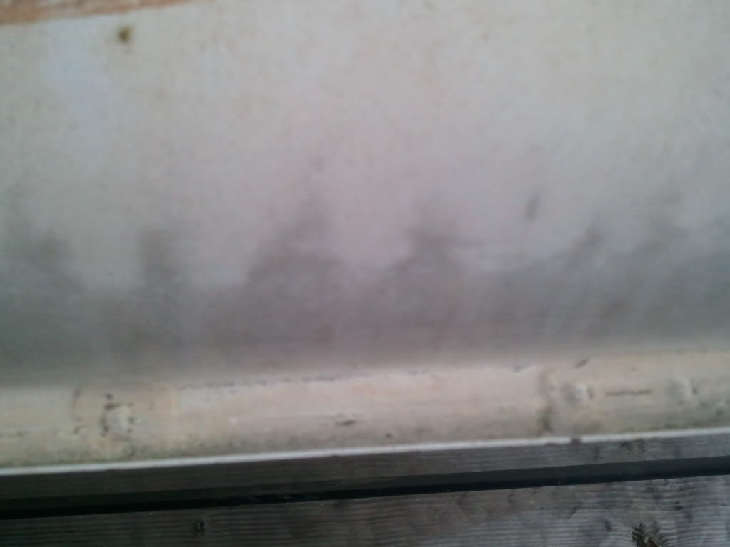

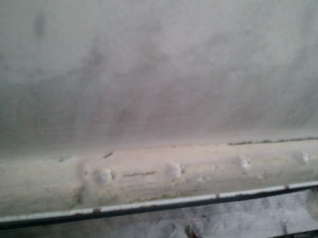

Here are some pictures of my unrestored 1976 top showing the seam sealer and rivets.
Hope this helps
