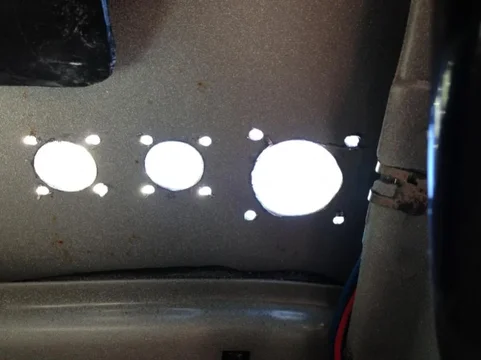

Hard to tell for sure but your cut your holes above the C pillar?

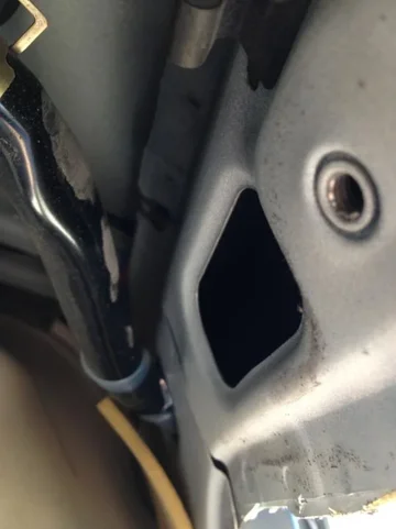

Cut holes just behind the sunroof assy. Cabling goes down same pilar as rear sunroof drain on driver's side.
2 x 12AWG into 1 single 10AWG for LED lightbar.
1 x 14AWG for 3 low wattage LED flood lights.
1 x 14AWG for 1 cigarette lighter socket for RTT.
3 x 12AWG into 1 single 10AWG for common ground.
Coax attached to PL-259 connector. Two of these are installed. One for CB. One for HAM.

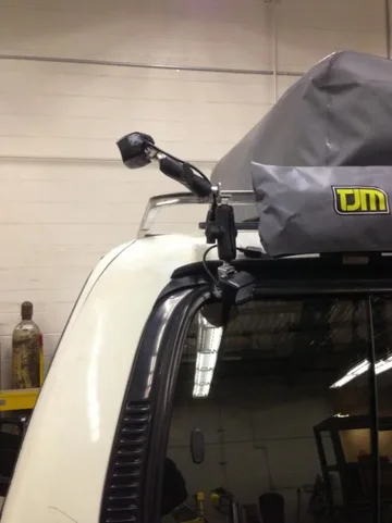

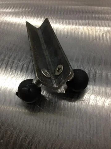

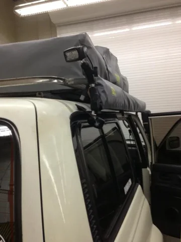

The other two connectors are 'N' connectors for coaxial antenna cable. One for CB radio, one for armature/ham radio. I incorporated mounts for the two antennas into my roof rack.
On the other end of the power cables I plan to use connectors that came with my RigidIndustries LED lights. They are very similar to WeatherPac connectors.
