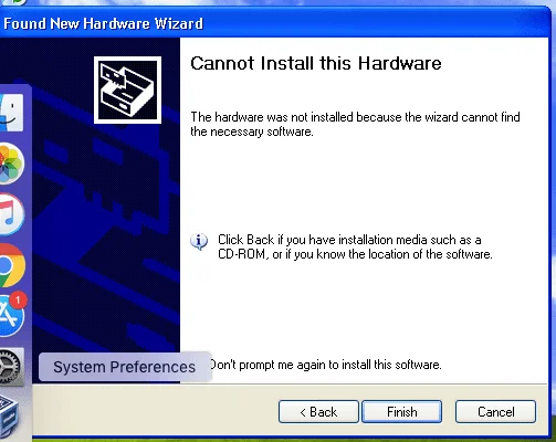

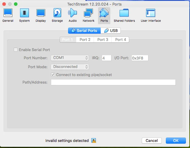

I found a post in this thread pointing the user to configure the VB settings to match the port from the host machine. That did not work either. Here's some of what I'm seeing:

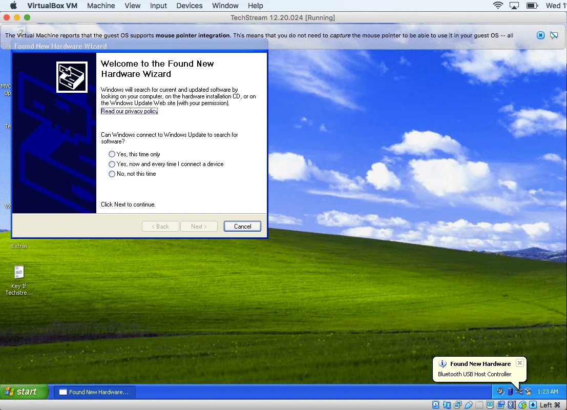

Bluetooth USB host controller? What does your VCI cable look like?
It's USB. Looks just like everyone elses. Says 'MINI-VCI J2543 Standard OBDII Communication Interface'

And my VB always says 'Invalid Settings Detected'

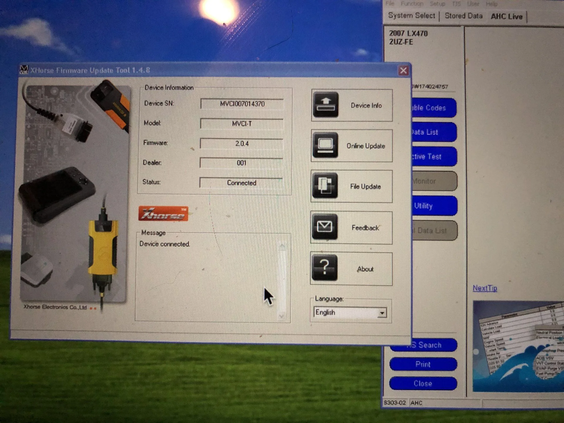

We’re thinking this issue might be with the VCI firmware or missing driver. @ljschnel is using v1.4.x the cable I have uses v2.0.4.
And FYI ... I found this in a forum dedicated to these devices.
The knock off cables use 1.4.1 or 1.4.6 (latest). The “real” cables use 2.0.1 or 2.0.4 (latest). They are all fake of course but the good fakes use the same firmware as the real Xhorse cable. The 1.4.1 firmware does not support active tests. The cable will work on 10 year old Toyotas like some in the GS forum have said but they will not work on the 2011 Prius as some on PriusChat said.
So I would make sure when ordering that the listing indicates the cable firmware version is 2.0.x.

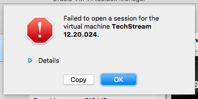

This whole techstream experience is super confusing. Two days ago the cable was inexplicably found by my VM. Now that VM won't even start up.
Created new VM. It again cannot see the cable.
I find it hard to believe all the folks in this thread saying it was so easy and just works. That has not been my experience at all.
I got this to work - it's just unfortunate that I cannot provide any constructive advice from my hours of struggle. Congrats to those who got tis to work easily. I did not, but ultimately 'turning it off and turning it back on again' got everything to work. Just a real PITA. :)
