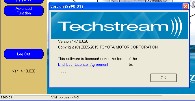

Using the virtualbox OVA in the first post to get it up and running with Techstream 12.20.024.
I then acquired the latest version 14.10.028 and performed the upgrade. Copied the main menu application from the extras folder into the C:\Program Files\Toyota Diagnostics\Techstream\bin folder and now have the latest version working ;)
Probably wont change/add anything for our older model 100's but good for folks who own newer models, aka my wife's 2018 RAV4.
