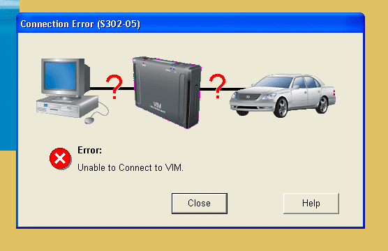

Can someone help? I have TS running on my Mac running Mojave 10.14.4 anyway it start up fine but won't connect to my 2007 GX... cable I got was the linked one on Amazon. Could it be that I have to run a USC A to C converter? Never had any issues before with it.
I had the same exact problem and got no responses a few pages up. I emailed the seller of the cable and he said was a problem with my computer or TS. I ended up exchanging the cable, as I ran out of ideas, and it worked perfect.
TL;DR Just return the cable and get another one. Is likely faulty.
So for me I had my old MacBook Air with the standard USB ports on it. I installed TS on it plugged it in and it worked perfectly. Makes me wonder if the usb-c to usb-a adapters throw it off?
There is a setting in the virtual box that allows the virtual machine to recognize and support usb 3.0. I haven't received my cable yet and my MacBook Pro only has USB3.0 so we will see what happens...

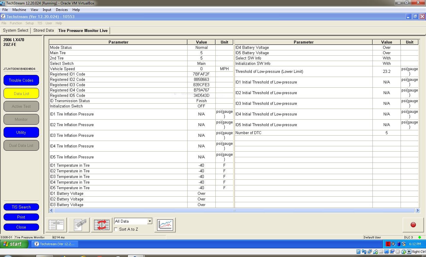

I have a TPMS issue I'm trying to diagnosis on my '06 LX470.
I've tried connecting 3 different ways (1. Old XP laptop, 2. Win7, & 3.using the VM from the OP). TS "seems" to connect and work correctly using all three ways. But, all 3 ways also give me errors when I try and access "some" of the TPMS options.
Anyone have any ideas what might be going on? Could this indicate an issue with the LX?
Many thanks!!
