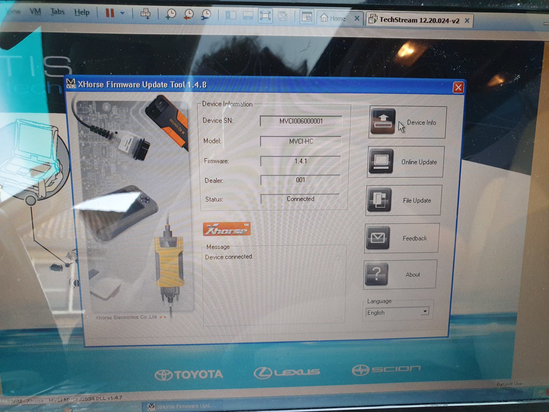

Then you just follow the steps in post #1... Install the VM etc. Getco pre-installed TechStream V. 12.20.024 in the VM.
This is a breeze, Getco even included a MVCI update and diagnostic tool in the VM to make sure the chip in the cable is working.
When I plugged it in for the first time, I had the feeling it was too good (or easy) to be true... I was wrong :)

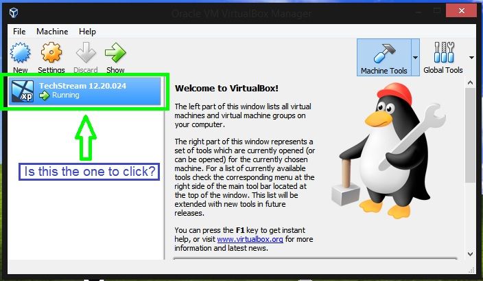

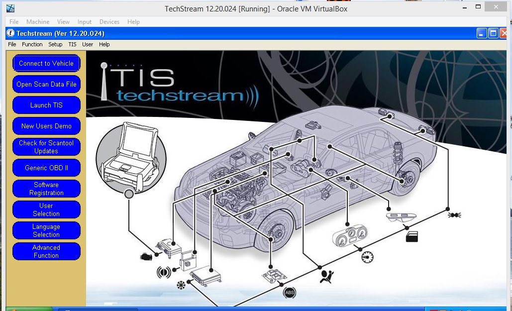

Thanks to @bamabrock @krispykritter @CharBar for the link, read back from the first post on this thread and followed it. Now I was able to download it. Didn’t know the software/app was an emulator.
So I went ahead clicked this button inside the green rectangle and next screen was this (I am now inside the windowsXP emulator):
I then clicked on the “Techstream” icon and lead me to this screen:
At this point I have no idea what am I doing LOL.
Any inputs are appreciated.
**I don’t have any miniVCI cables yet, I just tried launching the software and confirm if I did it wrong or right.

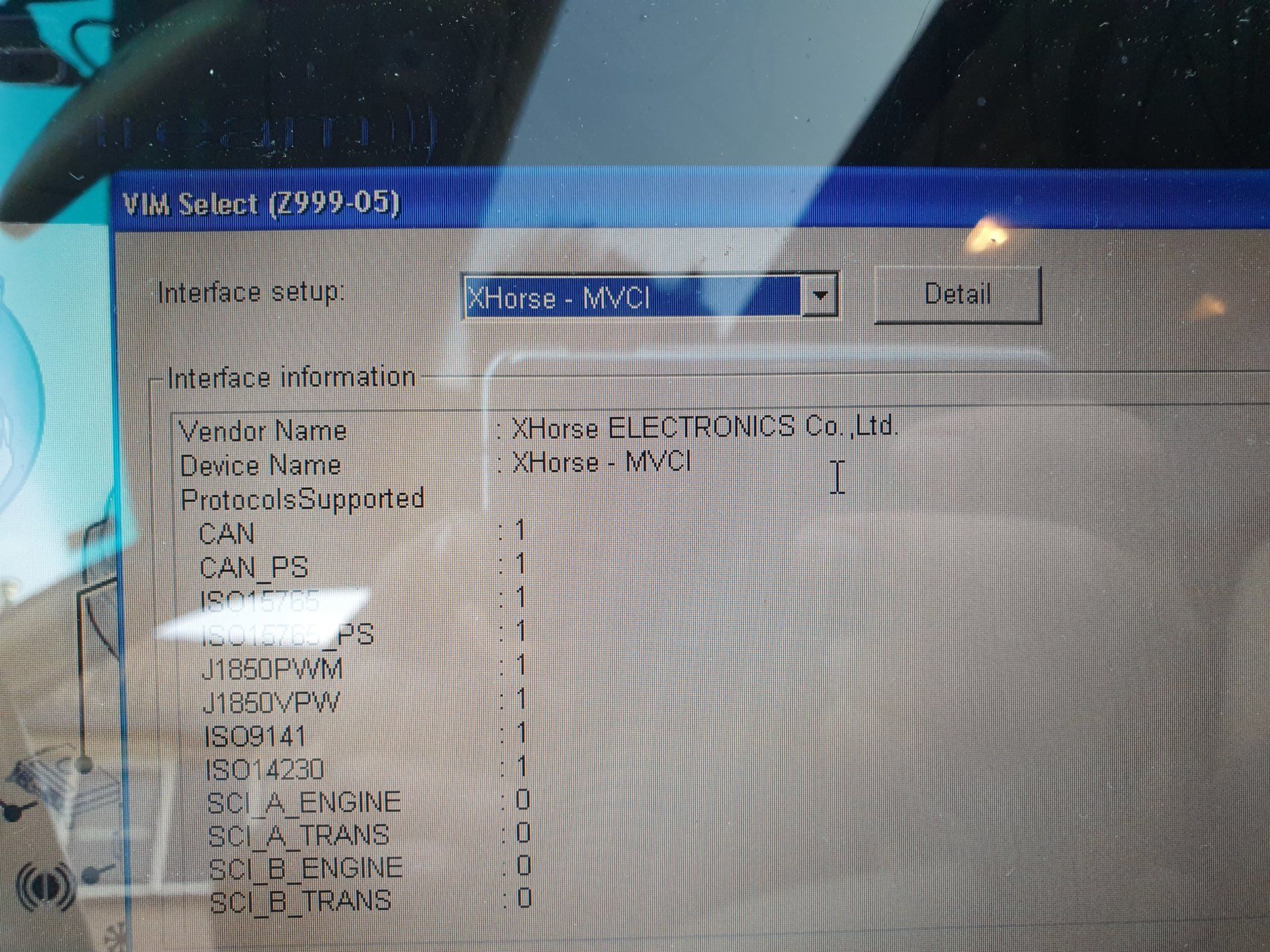

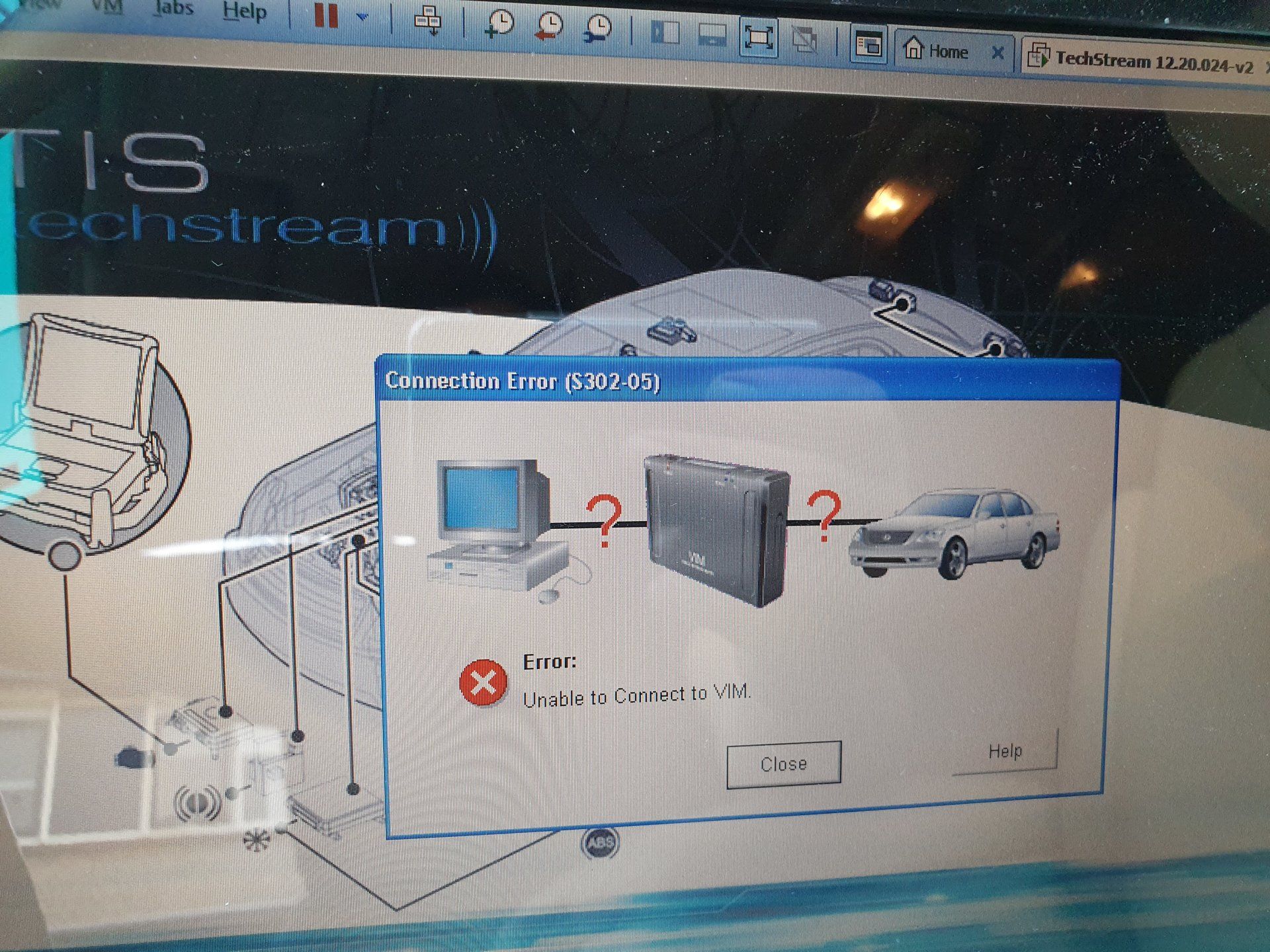

I know I am stubborn. I used this virtual machine in VMware Workstation (because I use this for my other VM's).
It runs fine, but when I try to connect, it wouldn't connect to the car. The key is in position 2, cable is in USB port and in OBD port. The VIM selector is set to J2354.
What can I do wrong?
The only thing I can think of is that I have bought a wrong cable, but it has worked on another laptop with this cable and this car. It is a J2354 cable.
Spitballing if you haven’t already considered: There may be an indicator in the VM software window’s status bar that tells you whether the USB device is recognized, and another in the Windows settings.
If it’s not showing up as connected, it’s possible the cable isn’t seated properly in the usb connector, that a software setting needs tweaked (either VMware or Windows), or that a driver might be required.
I also had connection issues when running a host machine without enough RAM.
As you see attached, the cable is recognised and connected.
Techstream is not connecting to the car. :(
I'll try other drivers (if I can find them...), but I think it's weird that I'm the only one who needs to do.
@ RAMmemory, I already have set it to 2GB, so I don't expect that either to
Edit > now I see I have a different J number in my cable. Do I simply have a wrong one?
be the case.
EDIT: Problem solved. I really do not know what caused the issue. Didn't touch drivers or whatever.

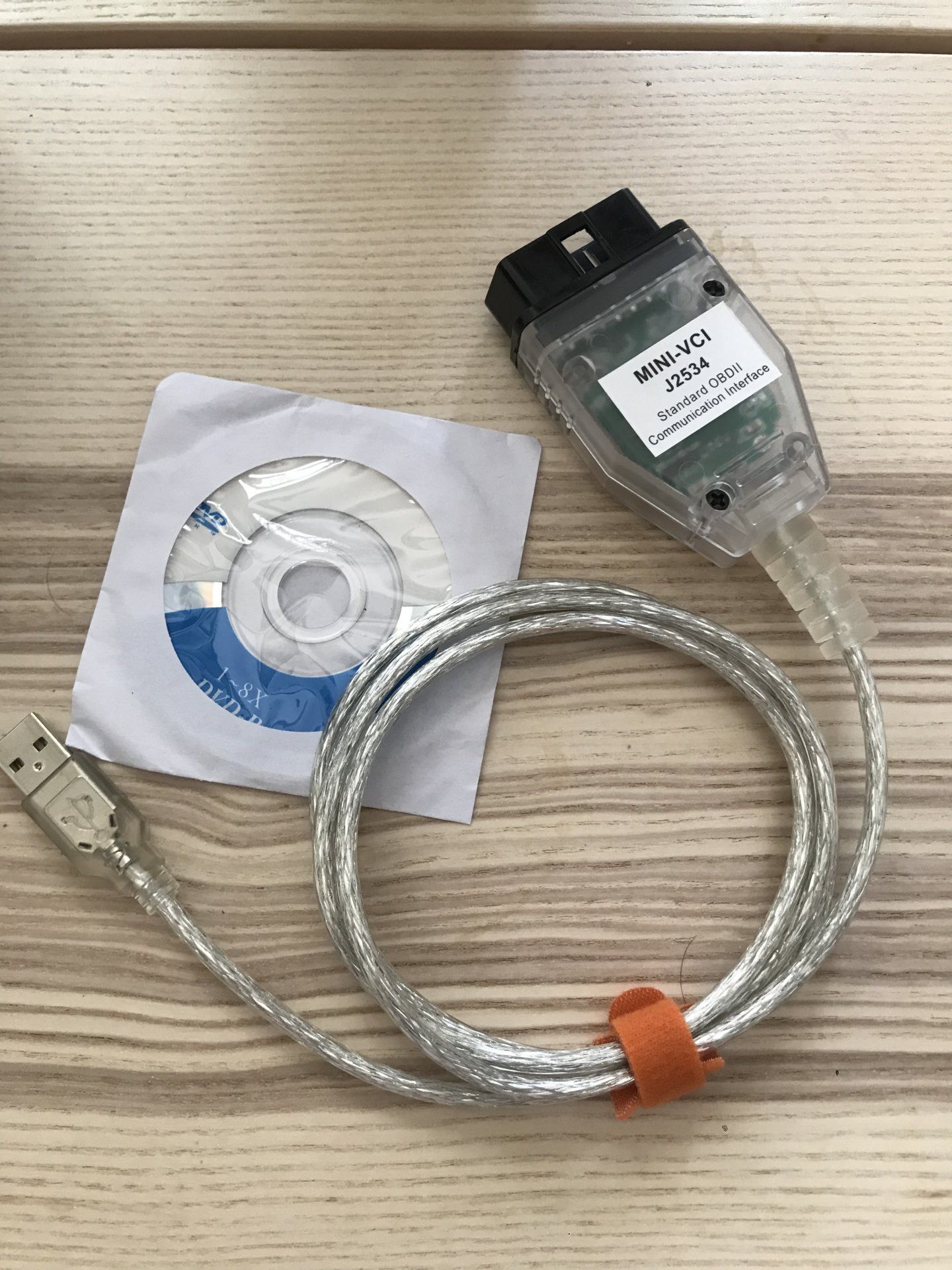

I just got the cable today gents. Do I have to install the driver (mini cd) that came with the cable?
This is the actual cable:
Thanks!
You shouldn’t need anything on the disc if you use the two downloads in the first post.
