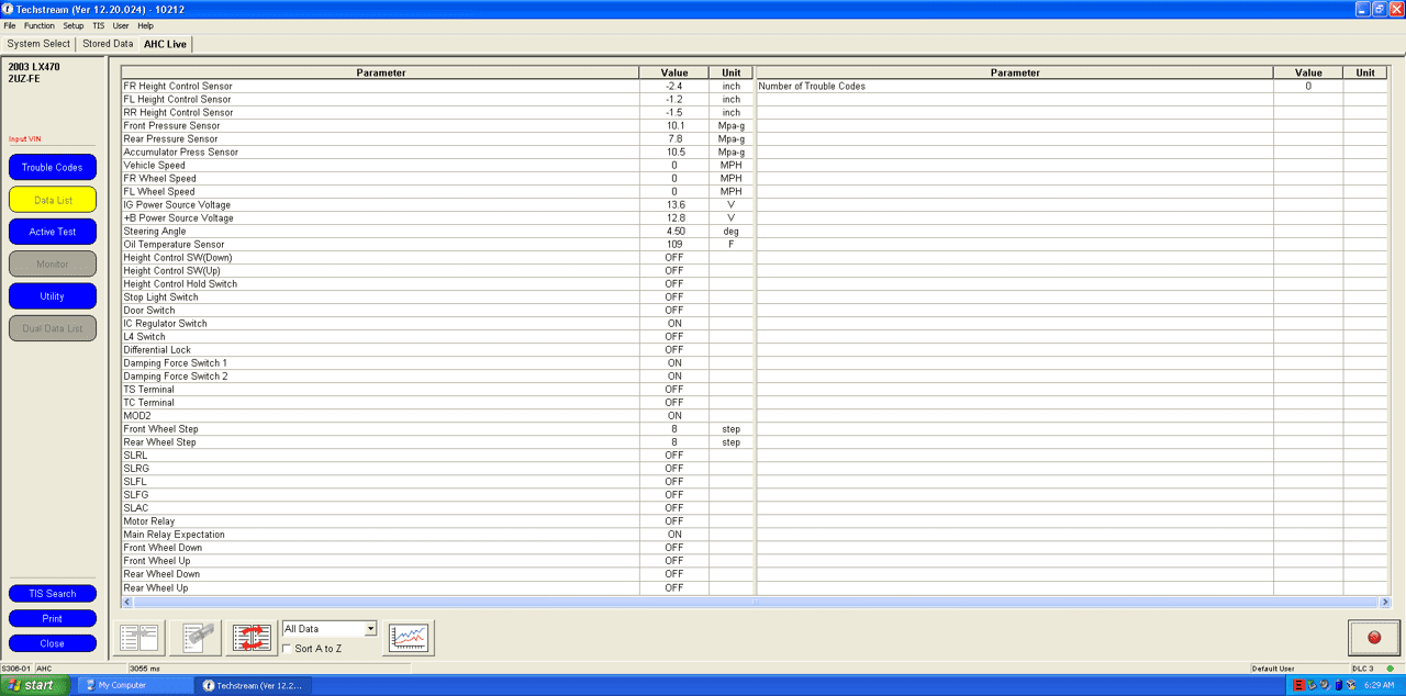

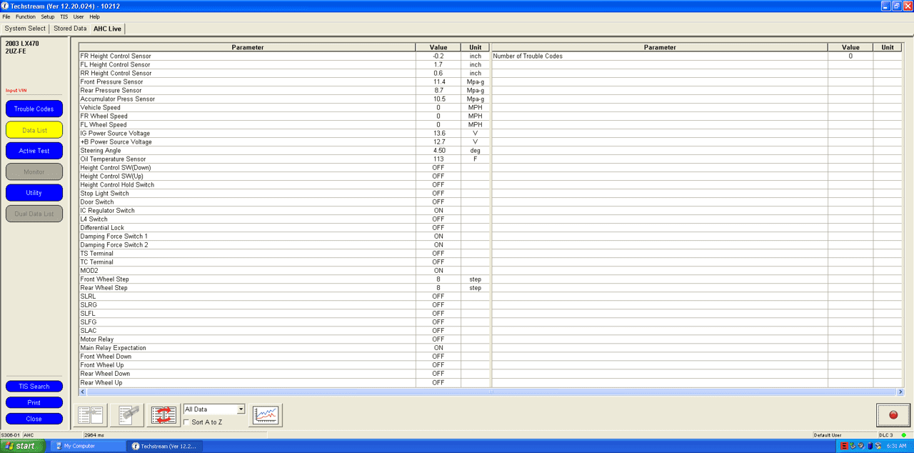

I need some help. When I first installed techstream about 5 months ago I was able to read the ahc pressures. Today I'm not so lucky. I even tried uninstalling and reinstalling everything. Here's my issue:
When I use the xhorse firmware update tool I can see my cable is connected and is model mvci-hc.
Techstream connects to my vehicle and pulls in the vehicle info. When I run the health check, many of the ecus are not communicating - including the ahc one which I need to read/adjust the pressures. Any advice??

This thread has been extremely helpful. Turning off the stupid auto-telescoping feature on the steering wheel and turning off the DRL was worth $30 for the cable. Now I just have to get smart on this AHC system to see what's going on with my truck.
Edit: Got it figured out. My pressures do not look great.

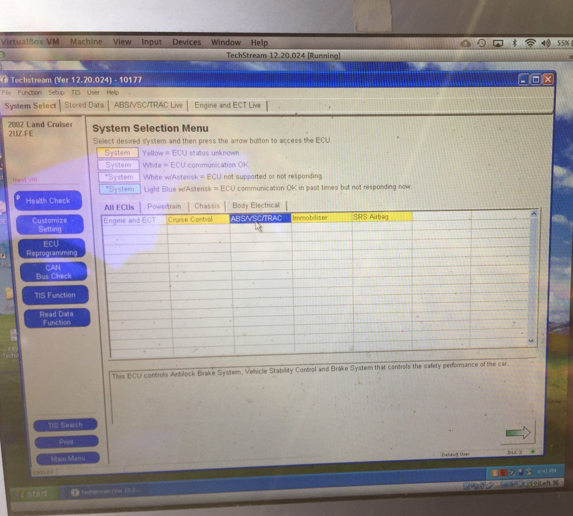

Hi all, not sure if maybe I missed it in prior responses but I cannot seem to access AHC info for my 2002. Please see below photo, I don’t seem to have a tab for AHC ECU under “system select” menu. Definitely have AHC, system works fine but just wanted to check on my neutral pressures.
Thanks in advance!
Techstream thinks you have a Land cruiser look in the top left corner. You need to change the vehicle when you connect to vehicle and select Lexus lx470.
Thank you! I went through and redid this and now seem to have no rear or accumulator pressure reading. Any ideas?
