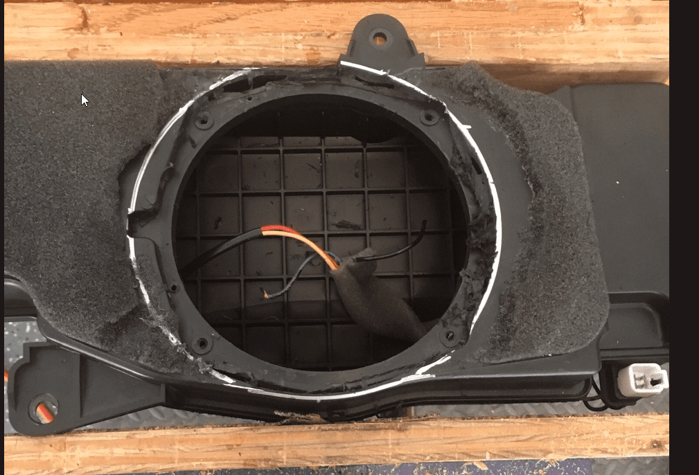

In the middle of putting the Kicker (Kicker CompRT 43CWRT672 6-3/4" Dual 2-ohm Component Subwoofer) sub in the factory enclosure and using the factory amp. @abuck99 got me straight on where to trim to get the grille to sit flush (thanks Andrew!)... but I want to make sure I wire this thing correctly, you know, 'cause it's so easy to access this sub once it's all buttoned up.
One of the (many) ways I wired it had the speaker jumping like a sub in a Run DMC video - at only 1/3 volume. I'm thinking (guessing) that's because the sub wasn't sealed in the enclosure?
The Kicker has 4 connections. The factory enclosure/amp has 4 wires. For a guy who is ohms impeded, that's too many options. ;-)
What is the correct way to connect these four wires to make this thing knock the windows out (or sound sorta like it did before):
Thanks!
The Kicker has 4 connections. The factory enclosure/amp has 4 wires. For a guy who is ohms impeded, that's too many options. ;)
Thanks!

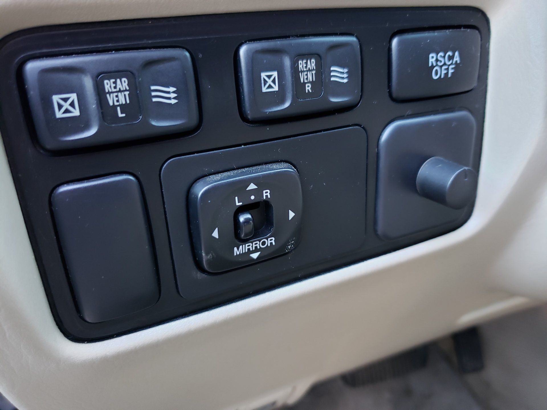

The installer added a bass modulation dial for quick adjustment so I do not have to go into the equalizer. The installer also disconnected the stock sub and drilled the box directly into and right over the existing sub. The sound is better than stock and overkill if I get a little rowdy.

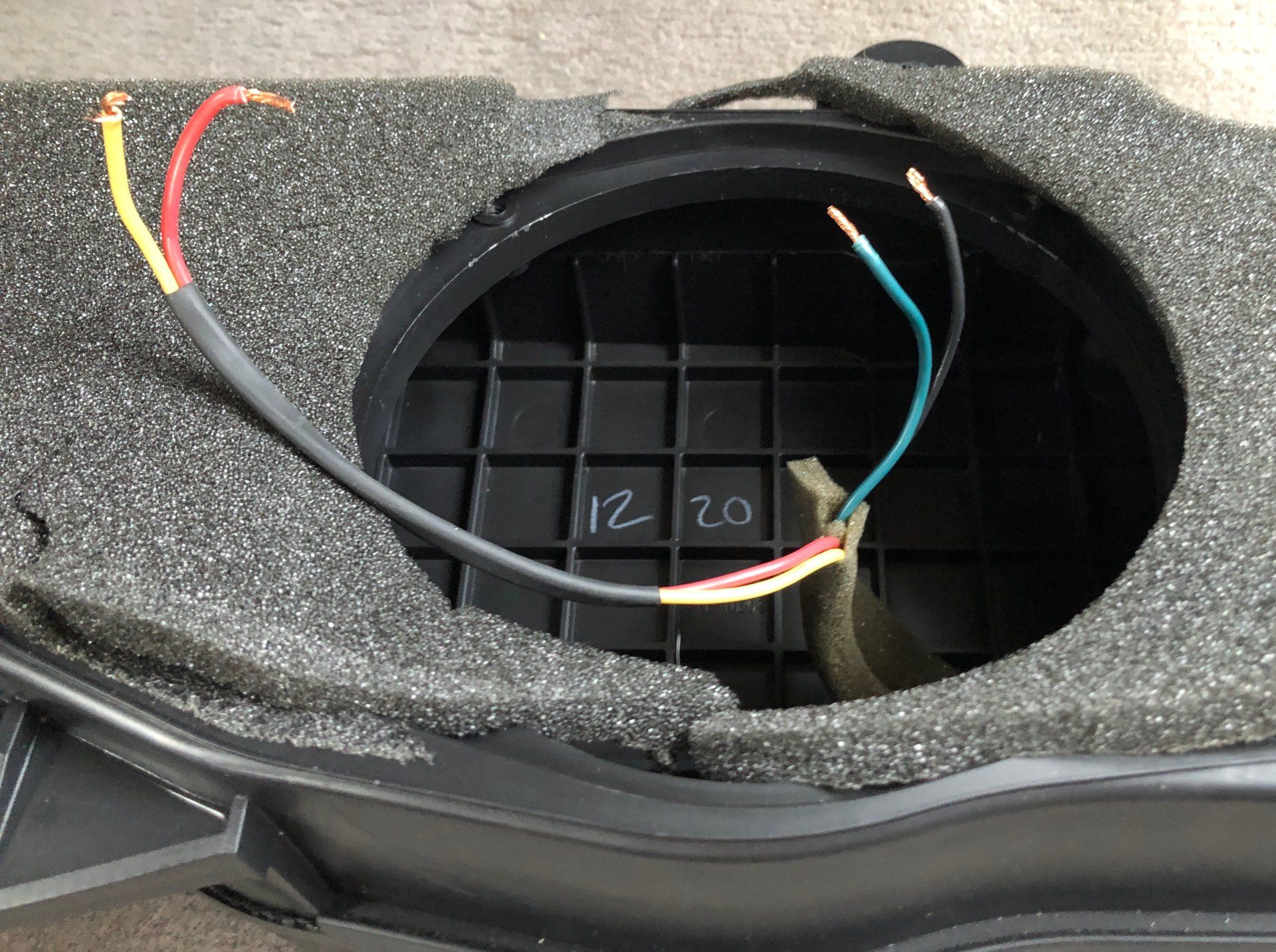

If you're looking to use the factory amp, you'll want to wire the voice coils in series (VC1- to VC2+) in order to present a ~8Ω load to the factory amp, similar to the original 7.5Ω sub. While nobody who's tested lower impedances on the factory amp has posted their results to this thread, I can tell you a 2Ω load is not likely to go well.

I just replaced the factory sub in my 2006 with a Skar 6.5" dual 4 ohm that seems to be a good match for the factory amp, that required very little modification to the enclosure. The holes lined up with the factory holes (I needed longer screws), the only mod to the enclosure was removing ribbing in the inside back where the magnet was touching, and there's a little rectangle of foam on the panel right above the grill that needs to have some of it ripped off, or the panel would bulge slightly. on my rig green and yellow were positive, I used both sets of wires. the 5 little gaps around the new sub needed to be sealed for it to sound right. of course this was much easier with the disassembly instructions from the OP.
