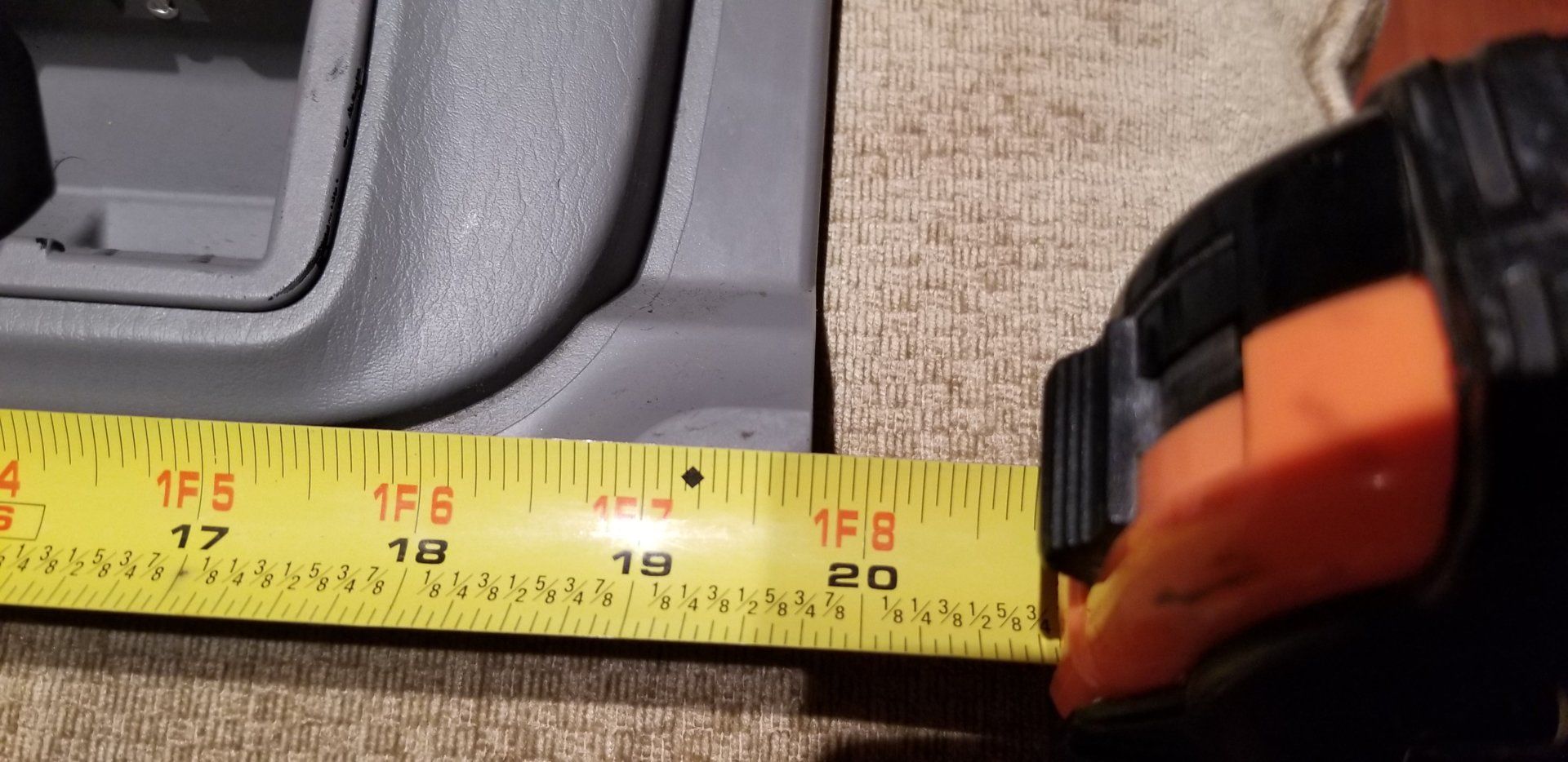

What is the largest dimension of the cover panel? The maximum I can print is 500mm, about 20 inches.
Haha I hear ya. I should be able to get that measurement in the next hour and share it here.
