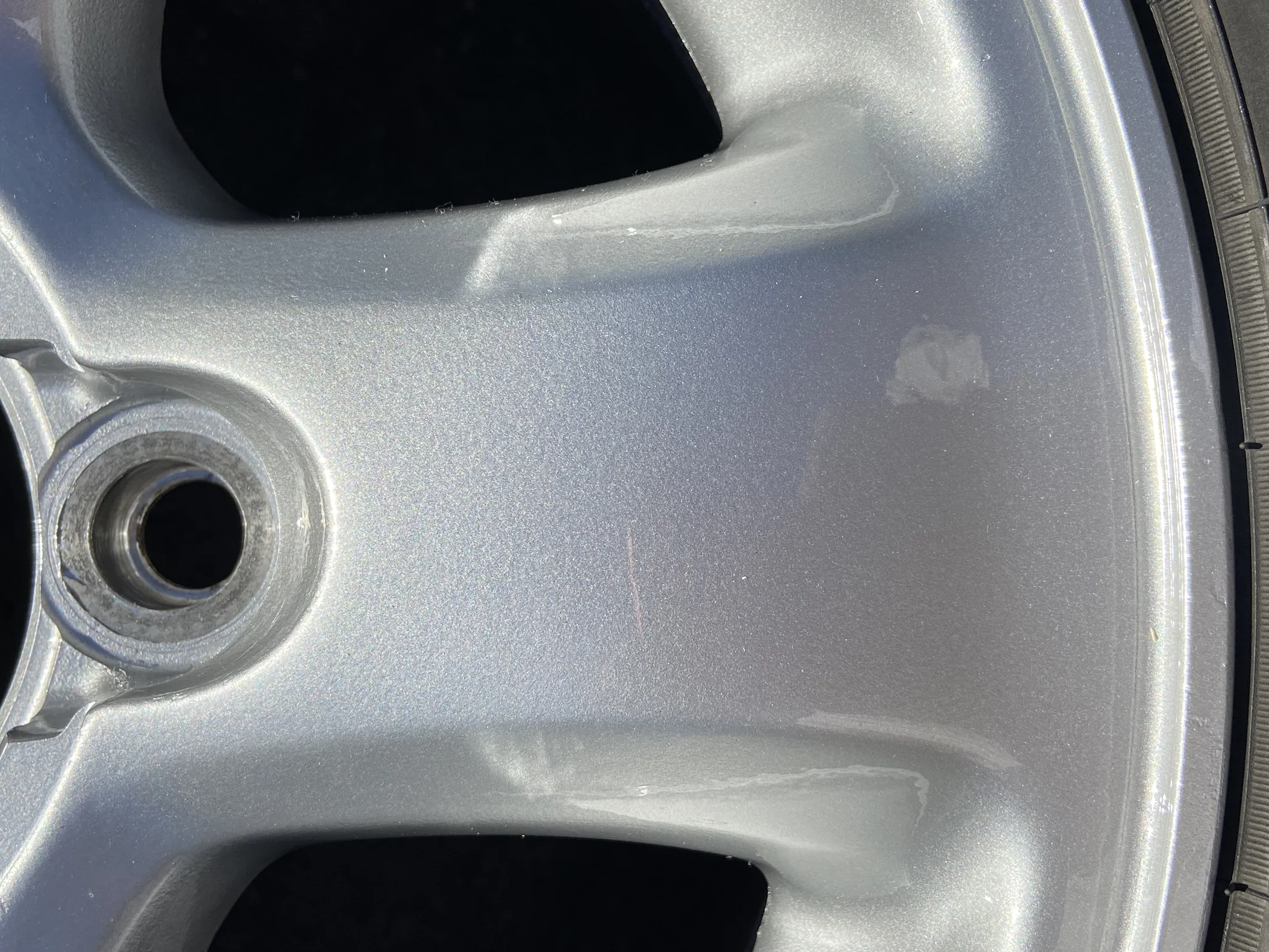

I had the tires and wheel weights removed. The rim underneath was in ok shape, with a little curb rash and a few dings that I filled with JB Weld. After the usual scrub, degrease, scuff, and dry, time for an alloy silver topcoat. I chose not to change the color, and Raptor 1K silver was a near dead match to the factory silver paint:
$20 at AutoZone. Spot prime where there is bare metal, and go easy on the topcoat. You want to keep it thin so the cast alloy texture does not get filled. 1 can lasted me for 3 wheels with just a bit left over.

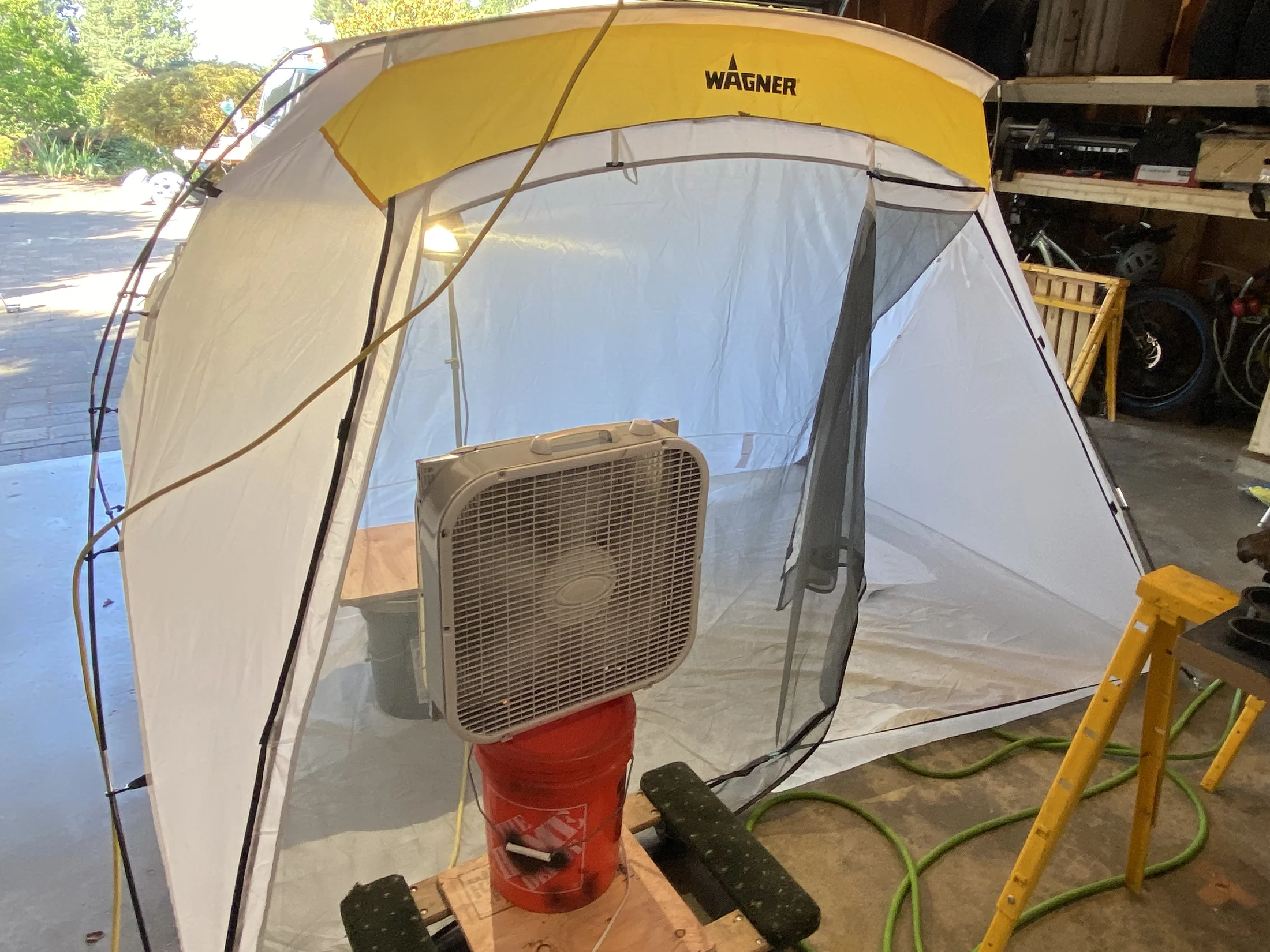

I use a cheap painting tent with an exhaust fan. It eliminates most of the dust and bugs that always seem to land in your wet paint. SprayMax requires good PPE: get a proper respirator (not a face mask), gloves, goggles. Tyvek suit if you’re sensitive. The warnings on the can don’t mess around.

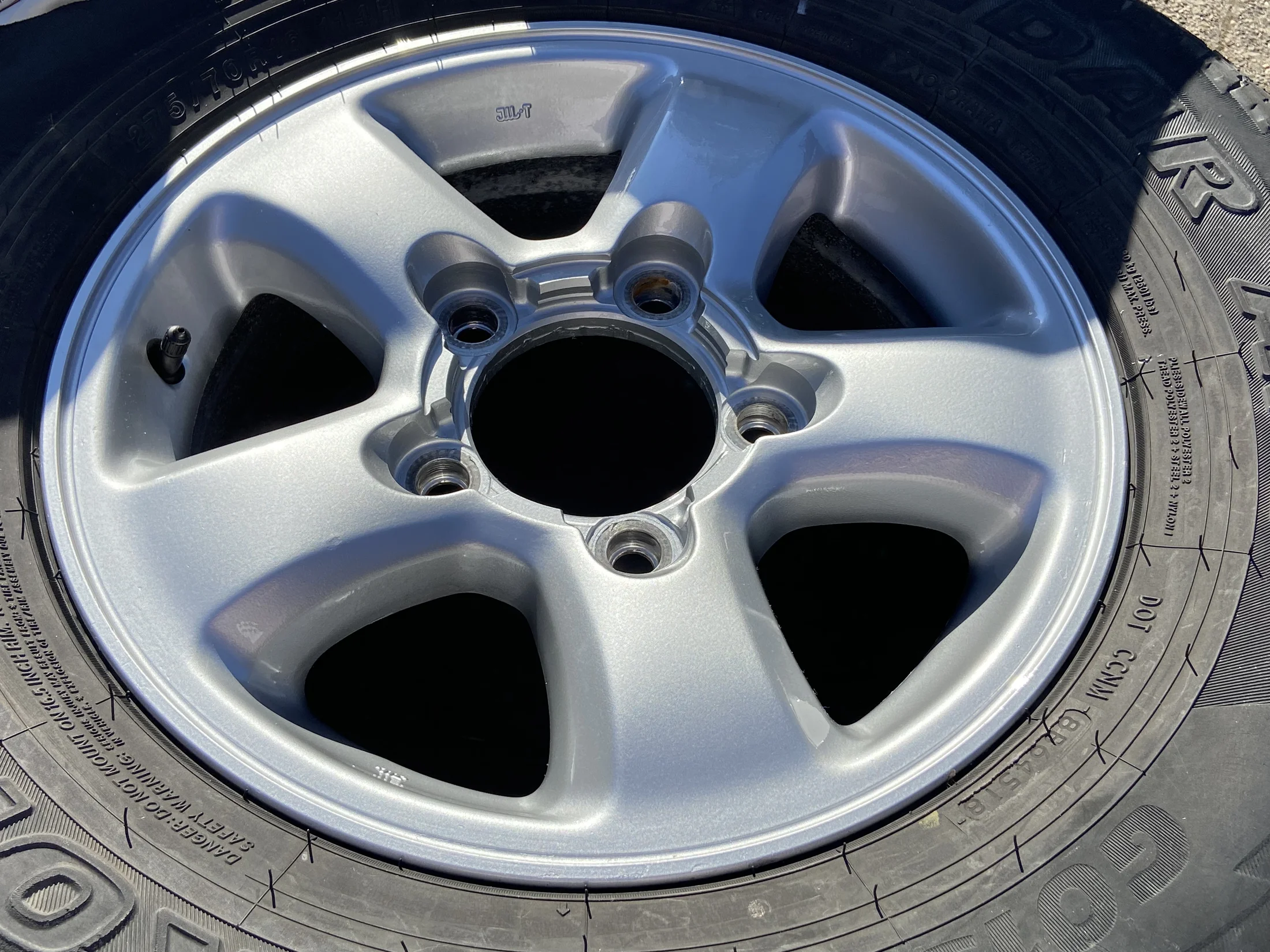

Spraying the clear coat takes a little getting used to. After punching the button on the bottom, which catalyzes the urethane, you have 48 hours to finish the can (I’ve doubled that by storing it in the fridge). Spray a light tack coat, let it flash off, followed by 2 wet finish coats, 15-20 minutes apart. You can lay SprayMax on more heavily than regular rattlecan paint, but it will run if you’re not careful. Let the last coat sit for an hour, then carefully move it to a warm dry place to cure for about a day. Heat up to 120F speeds things up significantly. This is what it looks like after curing:

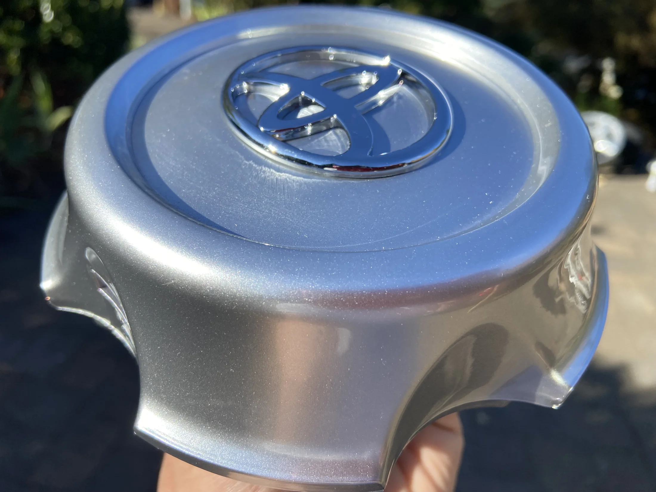

It’s hard to capture the results with a camera, but I coated over the chrome logo on the caps and it’s so clear that you cannot tell that the chrome has anything on it.
Total spent for refinishing 3 wheels and 1 cap: about $60, plus a day of labor. I like the glossy finish because it sheds brake dust better, but if a more “natural” alloy look is your thing, the satin or matte clearcoat will give you that.

Follow-up: if I had to do it over, I’d probably use something closer to a true base coat silver with enough “tooth” to bond to the SprayMax clear. I noticed when I got the wheels back from the tire shop that the clear peeled a little on the lip. It’s fine for a $20/wheel job, and these are just my extra spares. When I do the actual wheels currently on the vehicle, I’ll probably order a couple of cans of custom mixed silver basecoat.
