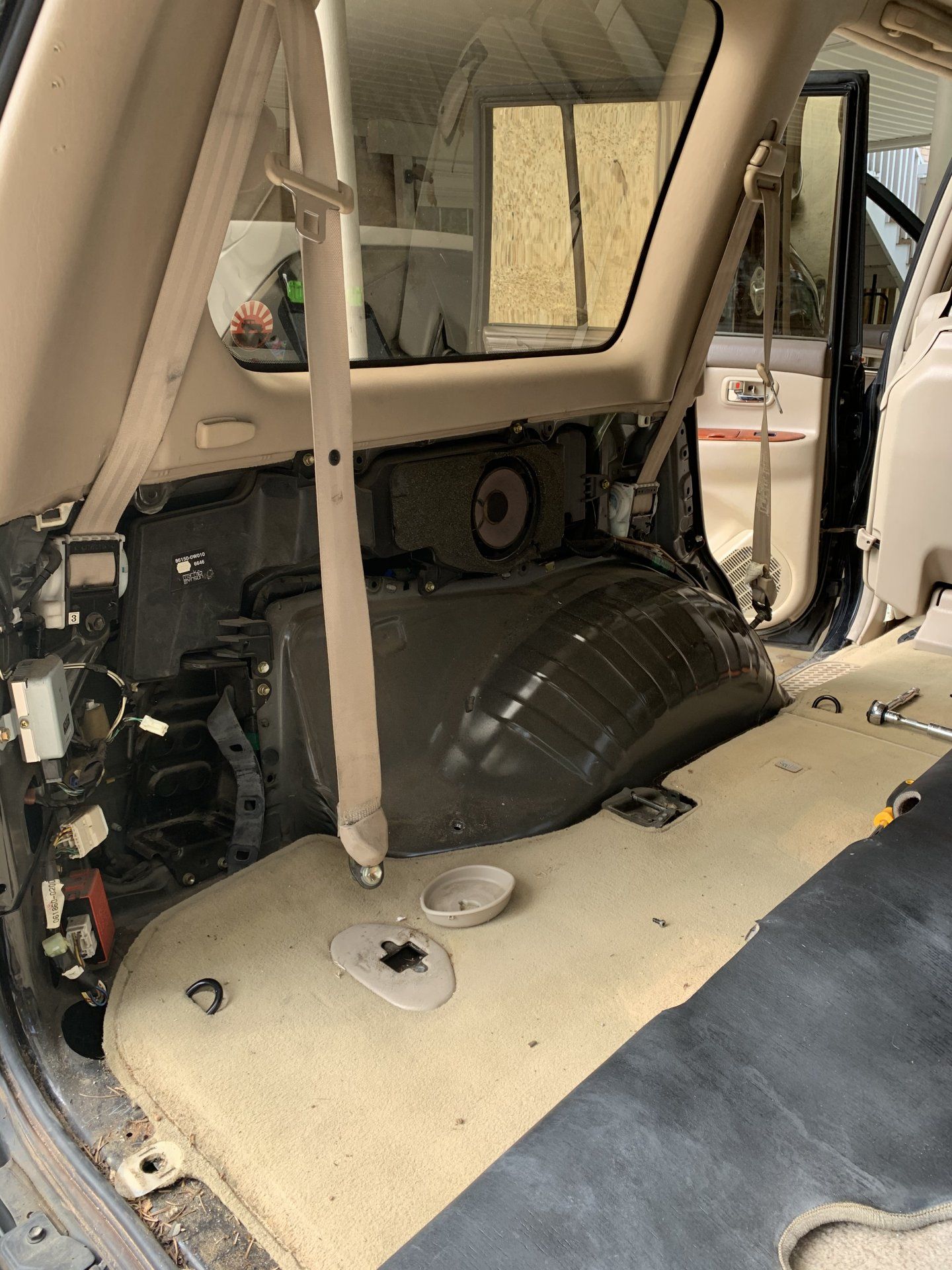

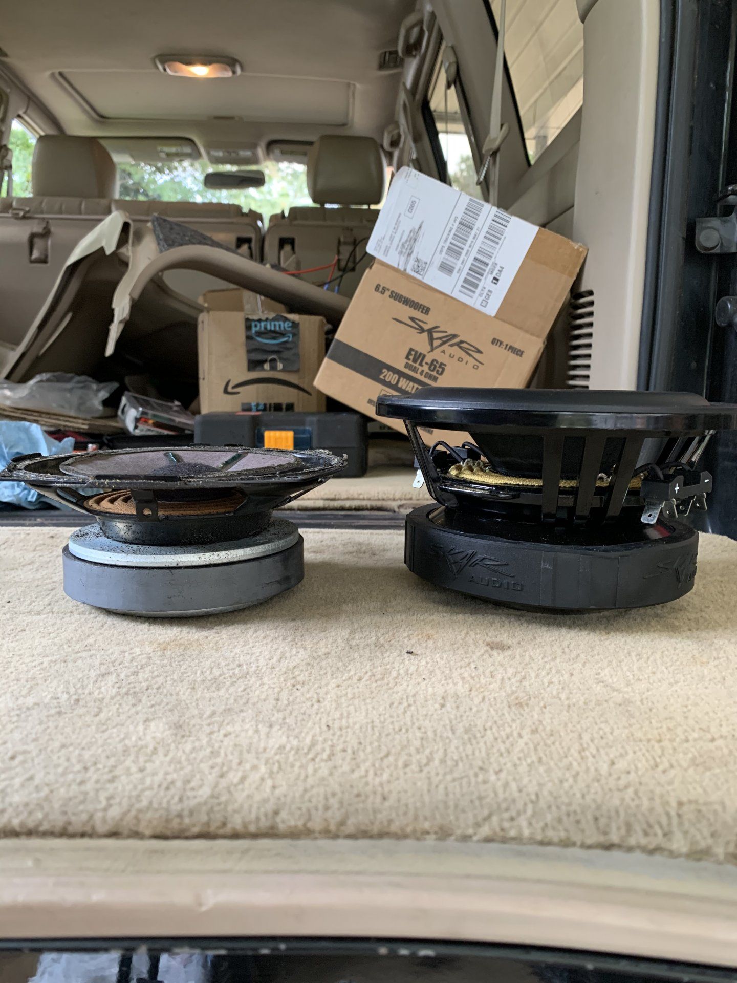

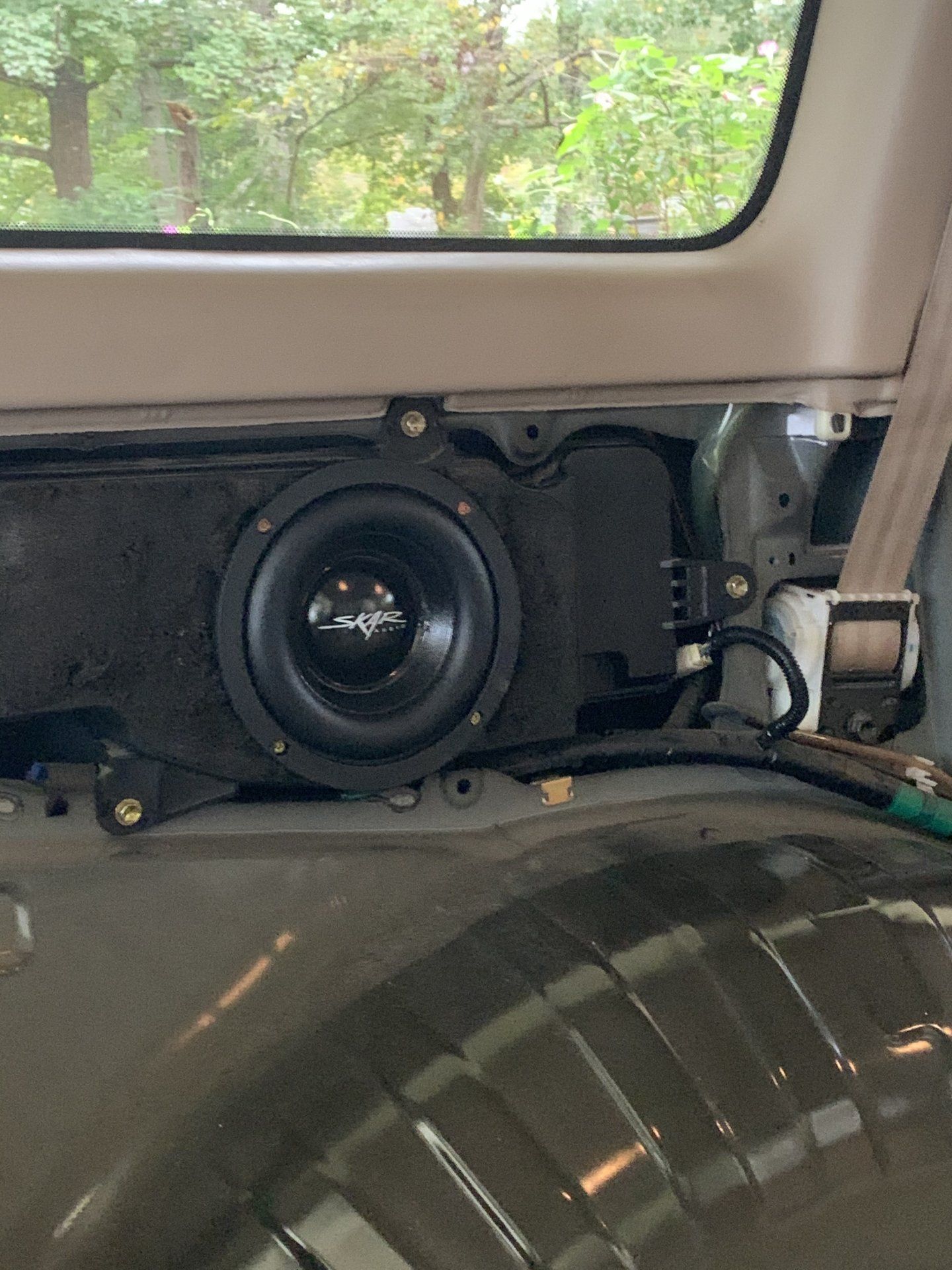

Just finished the 6.5” skar evl65 dual voice install in 2002 LX. Tried it at 2 ohm 4 ohm and 8 ohm wiring since I couldn’t find definitive info on the amp ohms. Sounds best with the 8 ohm series wiring which is weird since all door speakers seem to sound best under 4 ohm load. Anyway, I cut out the waffle baffling inside the sub enclosure and reused the plastic factory sub spacer that was under the old sub. Fit fine and plenty of room for factory grill. Sounds 1000% better than the old one. Oh and I had 2 speaker leads. Red and black just FYI.

Just finished the 6.5” skar evl65 dual voice install in 2002 LX. Tried it at 2 ohm 4 ohm and 8 ohm wiring since I couldn’t find definitive info on the amp ohms. Sounds best with the 8 ohm series wiring which is weird since all door speakers seem to sound best under 4 ohm load. Anyway, I cut out the waffle baffling inside the sub enclosure and reused the plastic factory sub spacer that was under the old sub. Fit fine and plenty of room for factory grill. Sounds 1000% better than the old one. Oh and I had 2 speaker leads. Red and black just FYI. View attachment 2463385View attachment 2463386View attachment 2463387
@HWY14South did the mounting holes match up or did you just attach with new holes? Where should i sound baffle the beast?
Holes line up, you need slightly longer screws though. You’ll need to caulk or hot glue some small irregularities in the housing to get a good seal around the new sub driver. I wired mine as a dual voice coil. Curious if the 8 ohm variant would have been a better choice. Sound is way better than stock though. Just look at the drivers themselves, the build quality is night and day.
