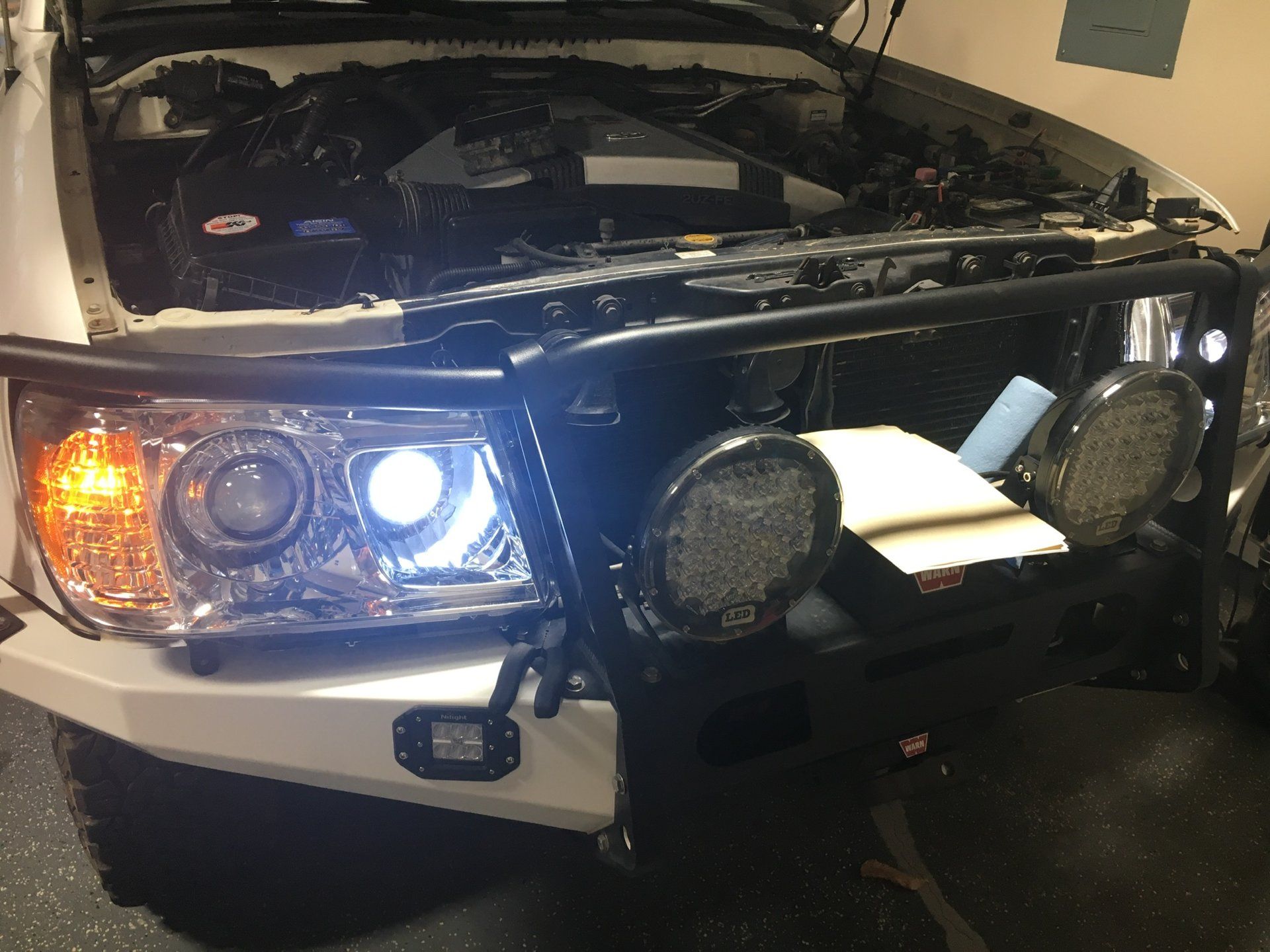

I appreciate the write-up on this. There were a few gaps in the instructions and definitely some areas I could have used more information for my conversion. Want to make sure I pass that information. My first headlamp following this DIY to a T took me over 3 hours. The second headlamp I did in under an hour.
1. TO SEPARATE THE GLASS FROM THE HEADLAMP ASSEMBLY:
The current instructions don't have enough heat for long enough, this is why so many are saying they are cracking/chipping glass and having issues. PREHEAT the oven to 240 (do not put the headlamp in while it is heating as the heating element is on full blast). Put the headlamp in for 18-20 minutes. I put it on top of some cardboard to shield it in case the heat element kicked on.
Slightly pry the case apart with a screw driver to get a small gap and use a C-Clip spreader to open the case up. Put bits of the cardboard from a box in the headlamp as you work your way around the glass. It comes apart like butter if you do 240* for 20 min.
2. HOW TO DEAL WITH THE EXISTING GLUE
Throw the headlamp assembly back in (sans the glass you just removed) for 6 more minutes. Use a screwdriver and smooth/ flatten it out into the channel. Put the glass in the fridge for 10 minutes and then you can easily scrape the glue off with a razor.

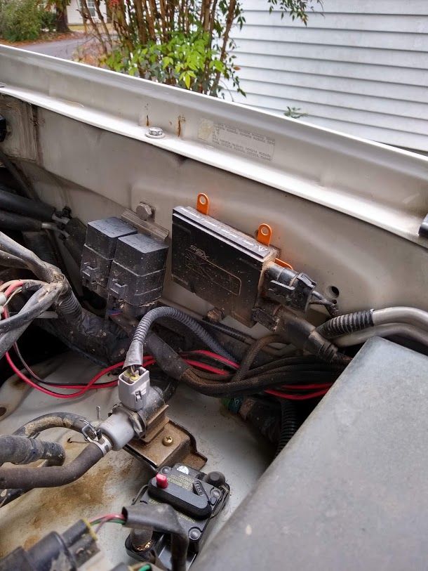

What is everyone doing for mounting locations for the ballasts and amps? If you have pictures, would you mind posting your solution?
I am working on making some aluminum brackets but am not pleased with anything I've made so far.
You are all going to shake your head in disapproval, but zip ties make mounting the ballasts really easy/convenient. I initially mounted the ballasts to existing available mounting points, but due to ongoing tinkering with my front end I have had to remove them several times. Got tired of dealing with the screws and now just have them zipped. In the words of Bud Light ads circa 2012 "it's only weird if it doesn't work."
No issues with the ballasts warming up and the adhesive failing?
None. I bought the strong velcro in the hardware aisle form home depot.
Drivers side fender. Mounted the wiring harness there as well.
I ran an extension for the passenger side and mounted it to an existing hole.
this is why I love Mud. Its the small obvious things that make all the difference and keep me humble. I cut my zip ties and added heavy duty velcro over the weekend, thanks for the idea!
