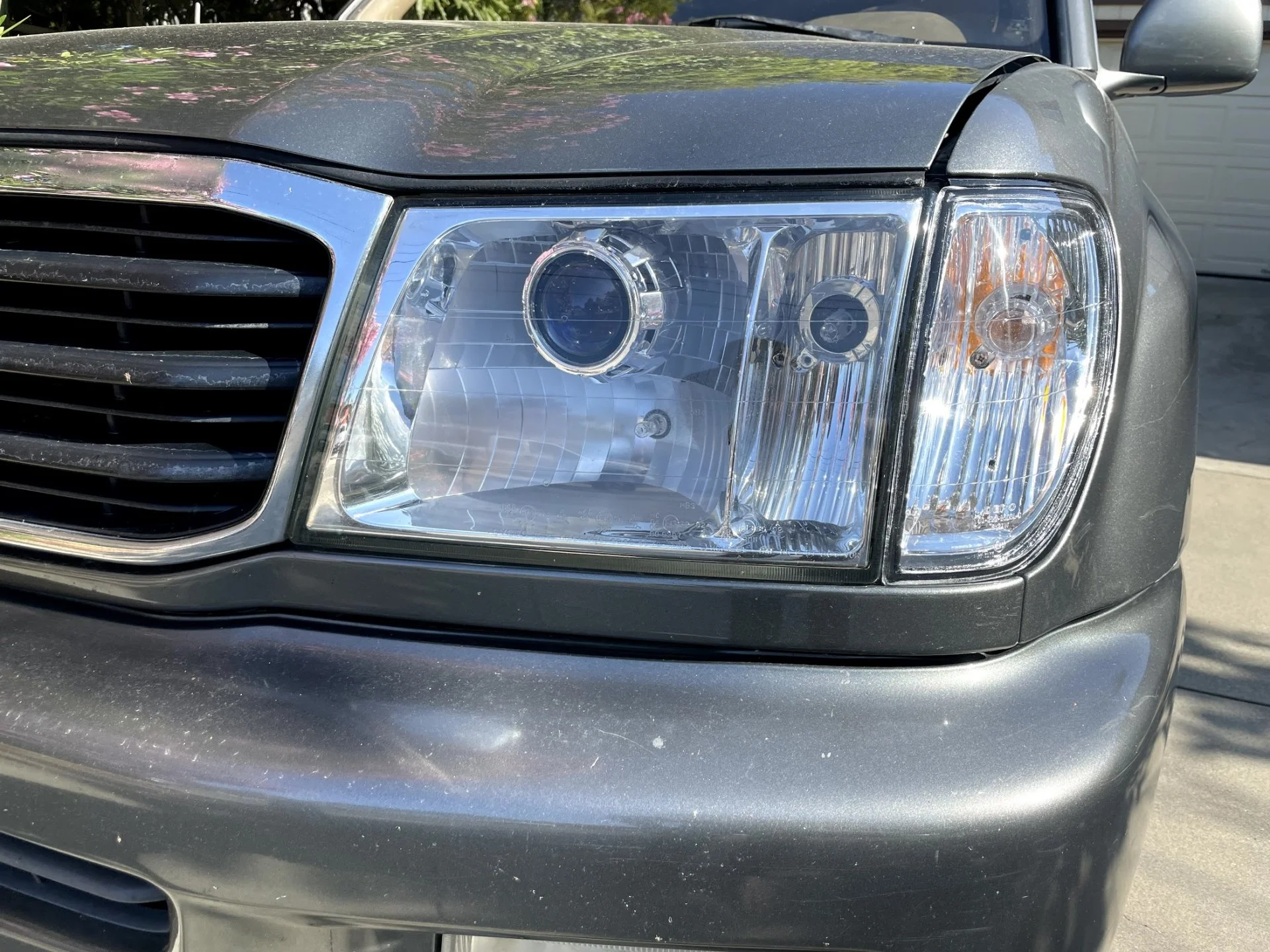

I recently finished an HID retrofit on my 2001 LC using the retrofit source's Morimoto Mini H1 Stage III kit. I'm very happy with the results. The wiring harness was plug and play. I had to order a 9005/6 splitter to get power to the halogen high beam and the shutter solenoid.
I had to use much higher heat to get the lens separated from the housing. About 270 F (in my oven, ymmv) did the trick. On the first headlight, I had a hard time on low heat. Once I cranked the heat up, the lens came off very easily. Here's a good video on separating the lens:
All in, the first headlight probably took 5 hours. The second was done in about an hour. I did all the grinding with a harbor freight dremel, which worked well for $20.

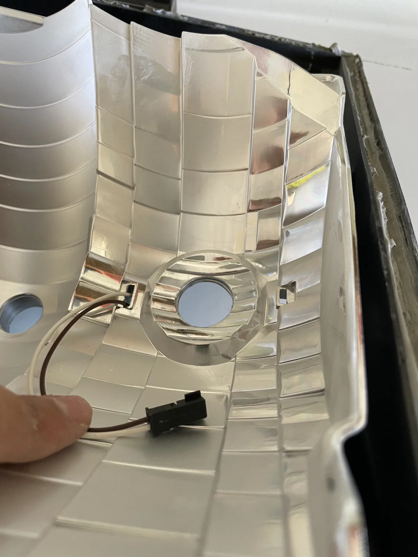

I routed the solenoid wiring through the holes left by the glare guard that has to be removed:

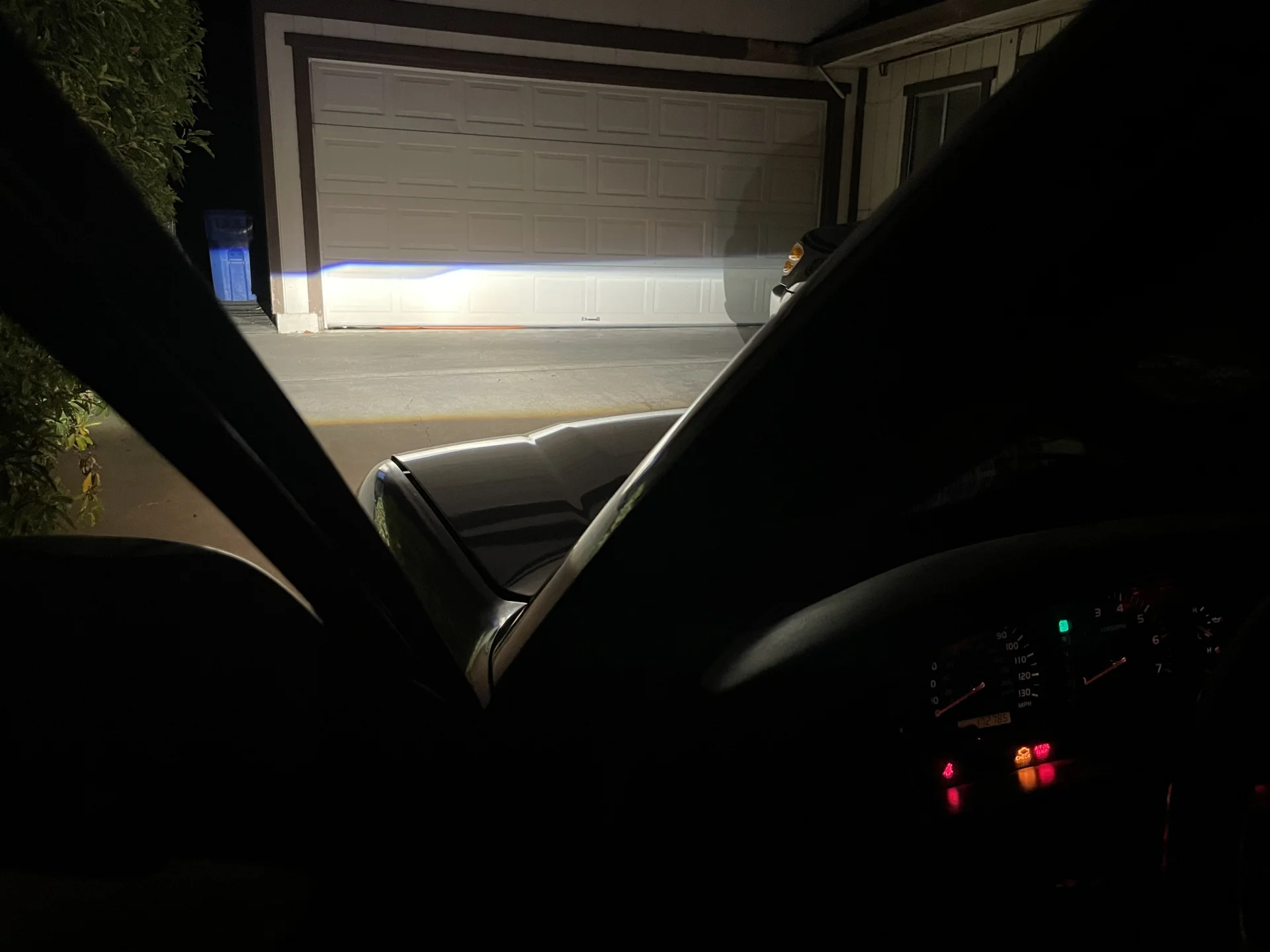

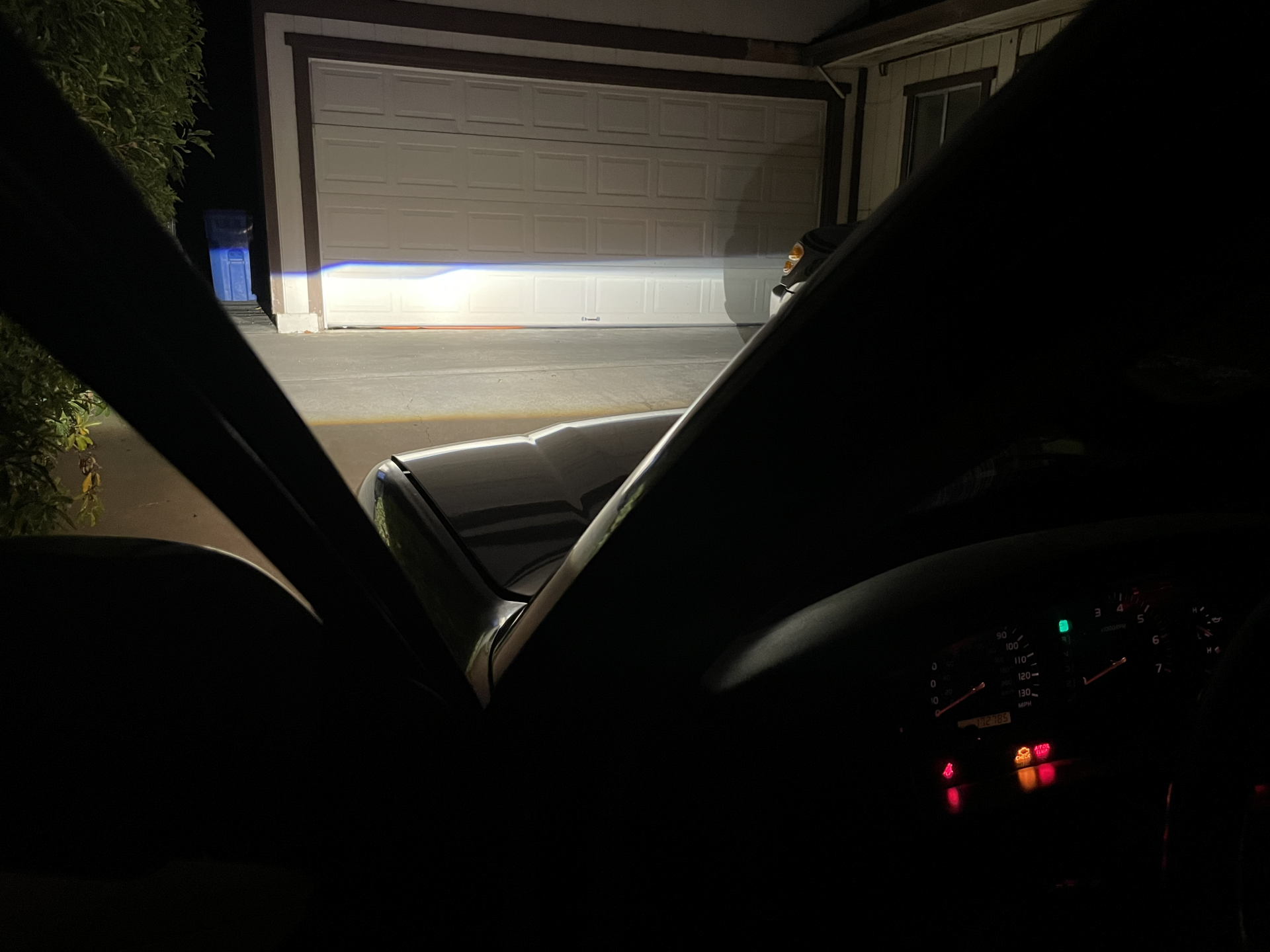

Here's a picture of the light output. It still needs a little adjustment.
that cutoff is awesome. Looks like the passenger side projector needs a little bit of a rotation and you’re all set. @mcc what’s your hid system setup?
Looks great!

Since the reflectors are designed for a halogen bulb, an LED bulb will scatter light all over the place and blind other drivers. You've probably seen and been blinded by people who put bright, high color temperature LED bulbs in halogen housings. From what I understand, halogen bulbs act pretty close to a point light source, whereas LED chips are distributed on the bulb in more discrete positions. The varying positions of the LED chips leads to the non-factory light pattern. The projector lens you see stuffed into the housing spreads the light from the HID bulb evenly, and there is a shutter to create the sharp cutoff you see in the pictures in this thread. That way you get good light output without blinding other drivers. The shutter can also flip out of the way when you want high beams.
These are the original headlight housings. Some people did this to aftermarket depo housings, you can go back in this thread to find them.
The bulbs for this setup cost anywhere from $22 - $50 - $120 per pair, so not too bad. But, there are other consumables in the system like ballasts and igniters.
The projectors are aimed up and down with the normal adjustment screw on the headlight. The back of the projector sticks into the hole the 9006 bulb went into, so the projector points in the same direction as the original halogen bulb (if that makes sense). Rotation (because it's a sharp line cutoff) is adjusted by rotating the projector in the housing.
My DRLs are still connected. I'll probably disable them, because the DRLs use the high beam bulbs, and the high beams are wired in parallel to the solenoid that flips the shutter (which creates the sharp cutoff) out of the way for high beams. The DRL circuit runs a constant current through the high beam, which is probably bad for the longevity of the solenoid in the projector.
I have a 2001 LC, so these are the glass headlights with separate corner lamps.

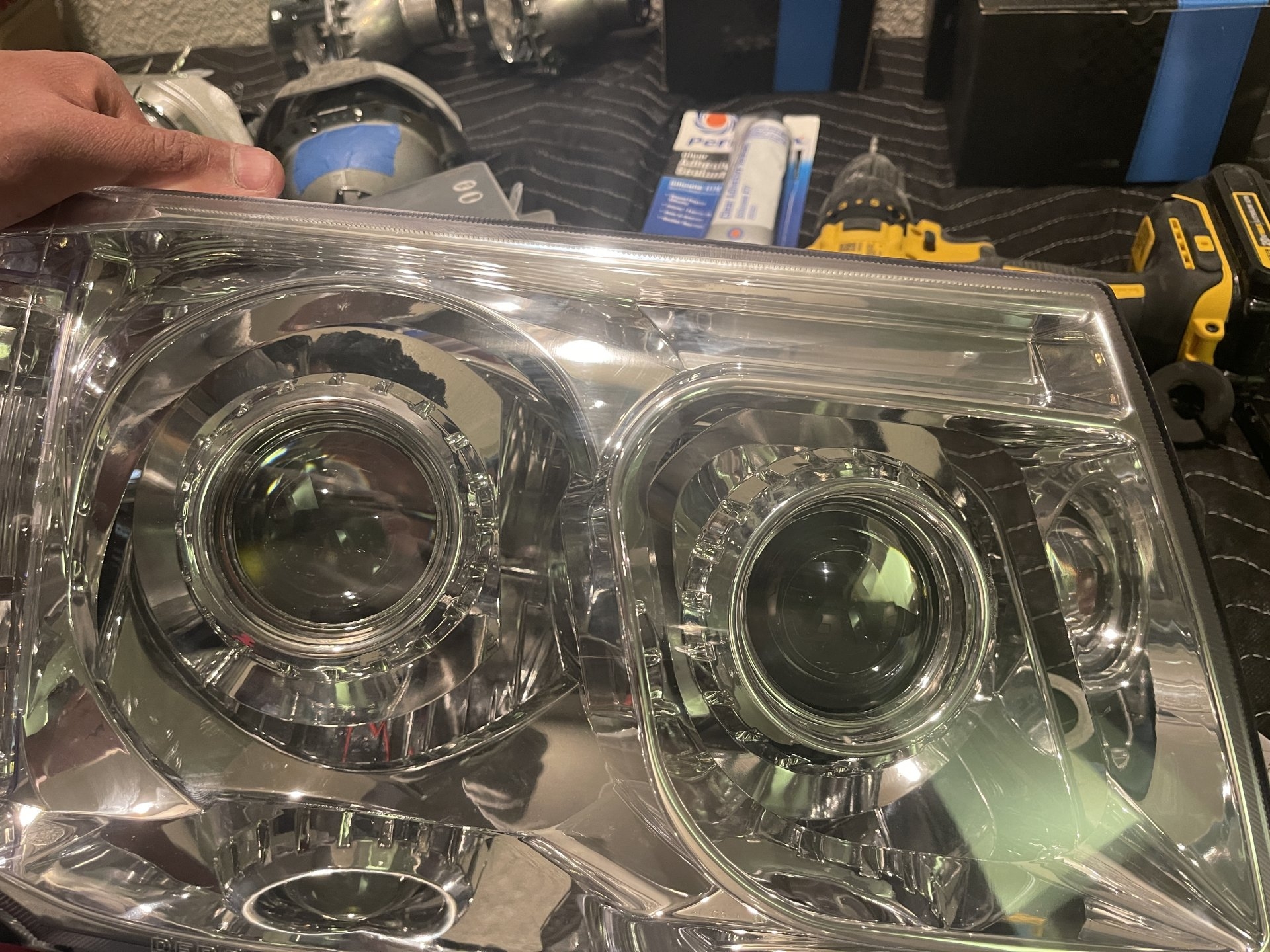

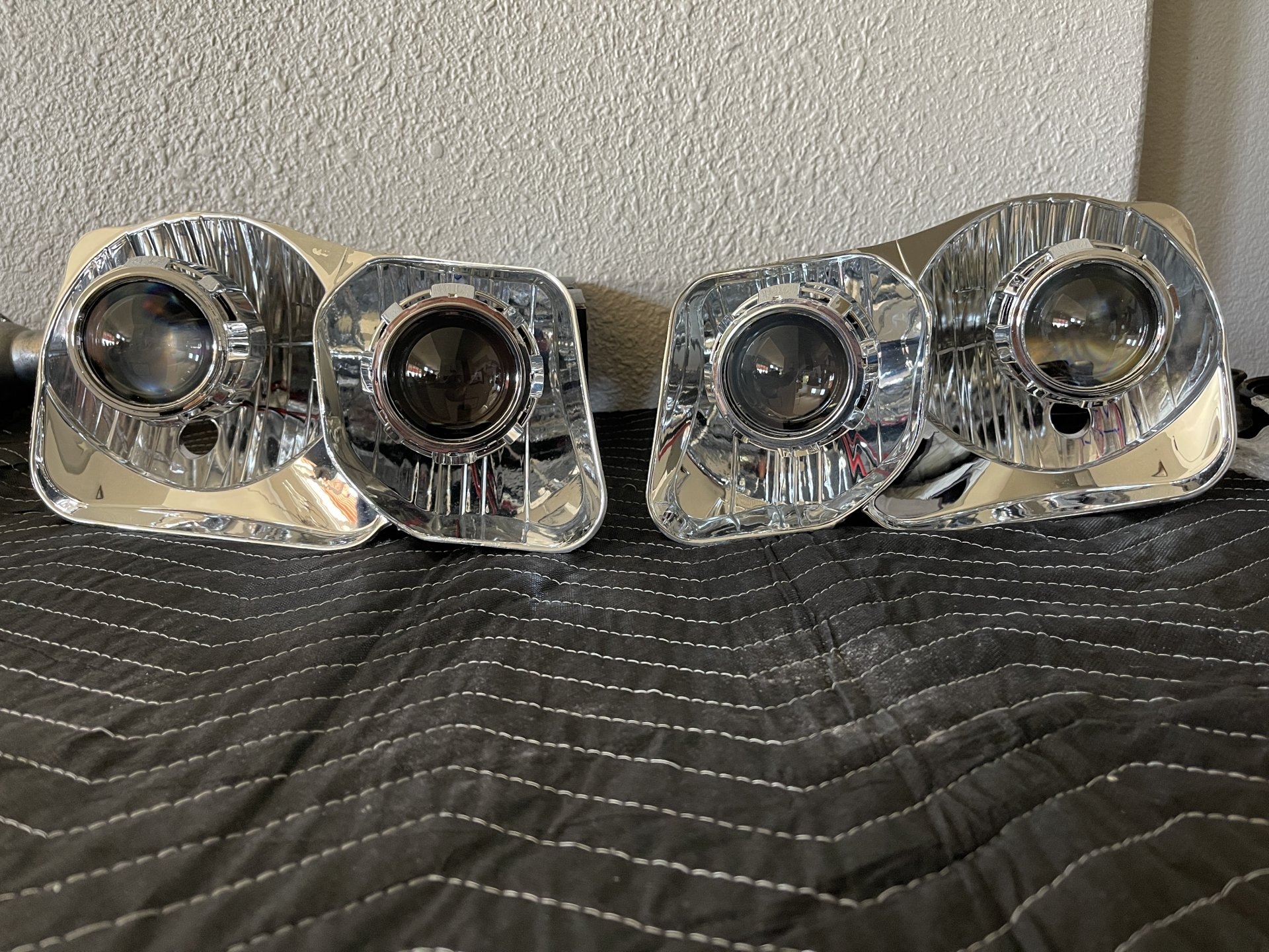

Two different setups I did for two customers this week. All parts in stock ready to be retrofitted just about two weeks wait time due to demand ;)

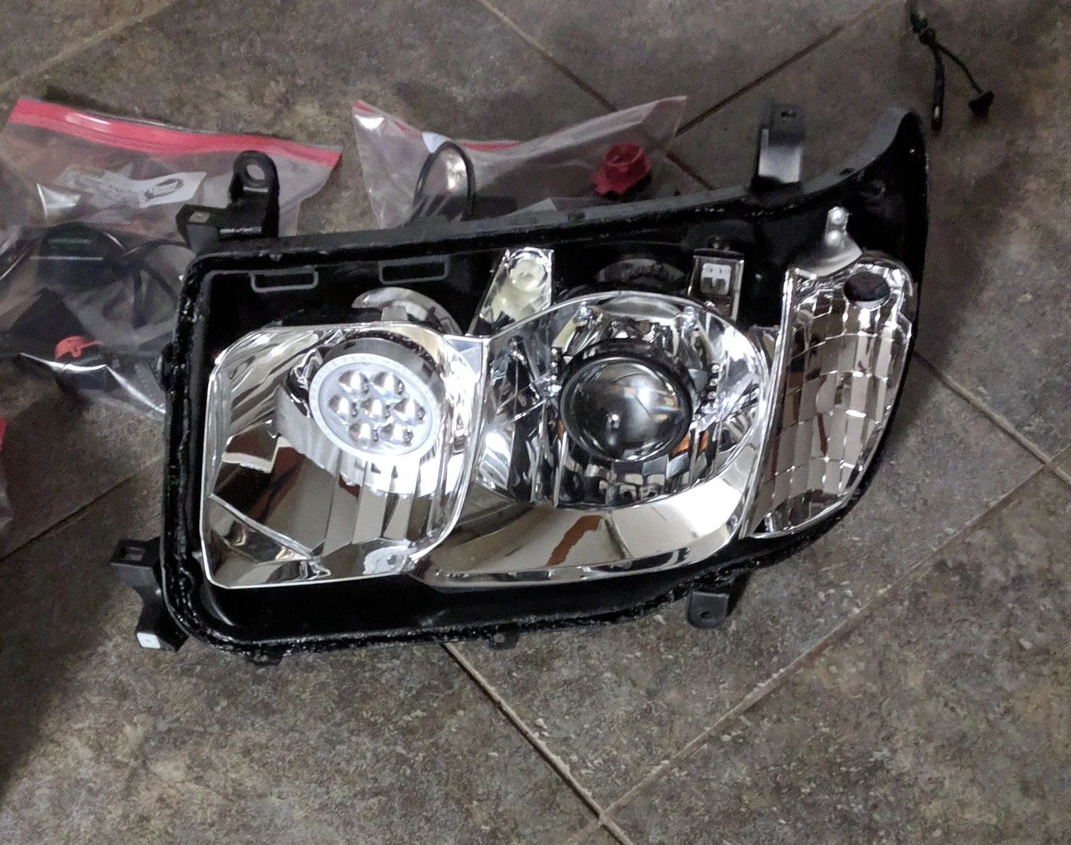

So for 80/100 series I got parts ready to go…but also stepping into the 200 series LX/LC models that need an additional projector in the oem hi beam location :)
So for 80/100 series but stepping into the 200 series LX/LC models that need an additional projector in the oem hi beam location :)

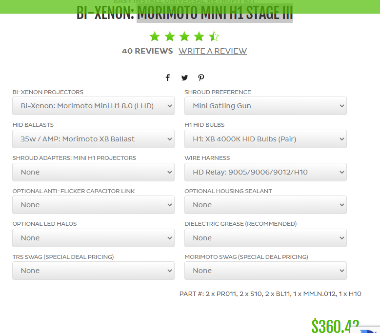

I am looking doing the retrofit for my 99 LC. I basically need to purchase the following kit and follow the process in this thread. Any other tip or tricks or coupons? :)
BI-XENON: MORIMOTO MINI H1 STAGE III​
B-RFK-MH1-TRS
