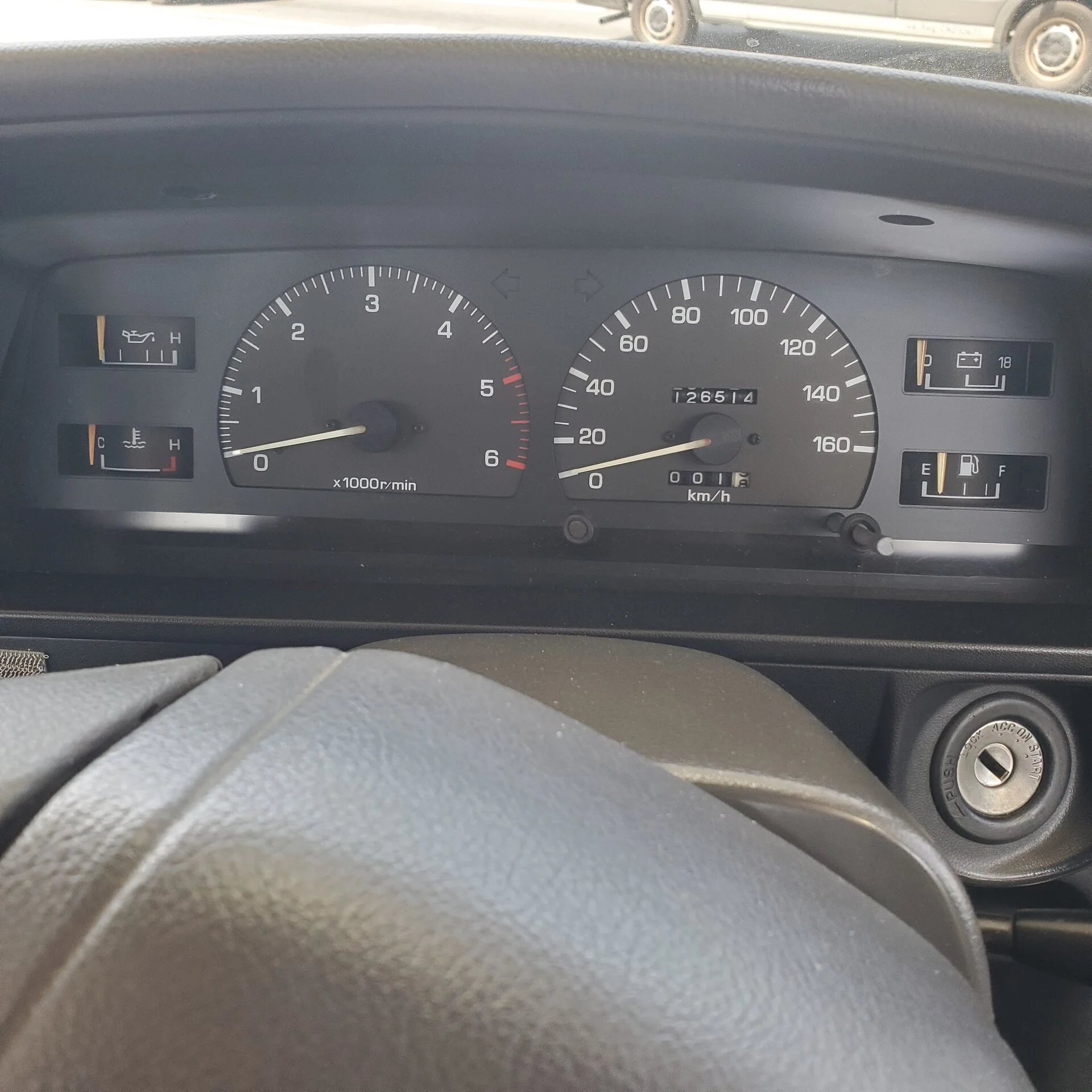

The 2L-engine has it's red line limit at 4000? I think 3500 is safe then. My OM34 (Mercedes) has "orange" line at 2800, red line at 3000 and sometimes I "need" to push it to 3200 :hillbilly:. But the mercedes community is sure, the engine will do 3000rpm forever, don't boost it too much :)
3L doesn't redline til 5K. If you have the post-1988 heads, don't hesitate to run 3500 rpm. You'll be fine.
And as others have said, the 3L is a bored out version of the 2L. The 2L, 3L, and 5L are so similar that all three are covered under the same factory engine manual.
