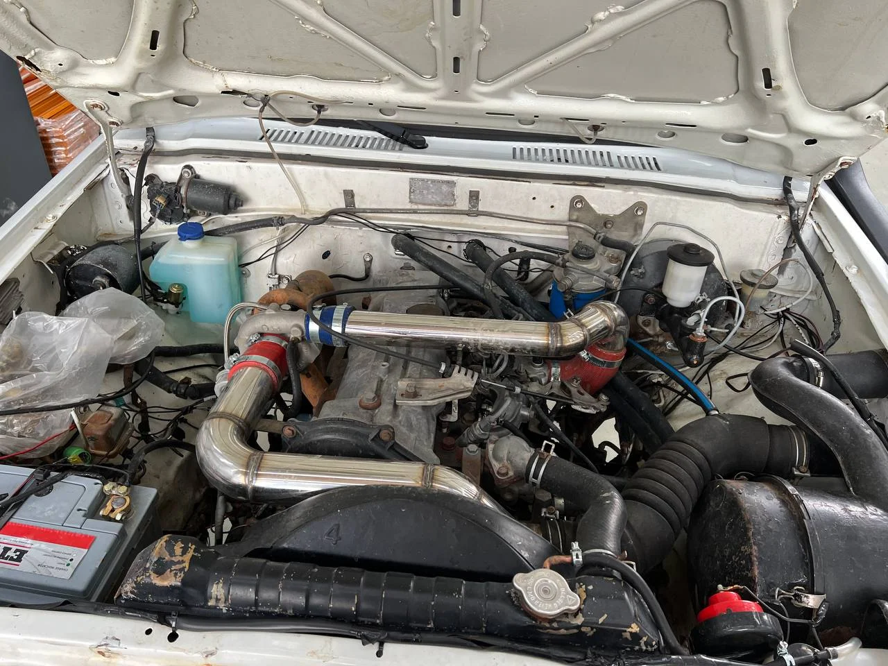

I read a lot that the 2L is famous for cracks on the head, so far so good, the ideal boost pressure is 6-9 psi but when I flat out I can see max 15 psi which might be a concern, I will adjust the blowoff valve accordingly and drop pressures for the sake of reliability. If I drop a valve I will do a cost analysis and consider an engine swap, BD30 is cheap and easy to work on but will it fit? Also I've seen a guy put a PD130 1.9tdi which seems interesting but I will wait till time comes.

Boost isn't the enemy, excessive fuel leading to excessive heat is. Do you have an accurate coolant temp gauge and a pre-turbo EGT gauge in addition to the boost gauge?
Thanks Aussie very well aware of that statement, I only have a water temp gauge which doesn't tell me much. I'm ordering a Pyrometer so I can plug in and measure Pre-turbo EGT. I took a 600km roadtrip when I bought the car, en route I climbed a big elevation change going 90kmh, the water temp went near 80C so I pulled over waited an hour or so and continue my route which was a slight downhill. I gave maybe quarter throttle going down and was below turbo threshold, the water temp started going back up and I think this is becuase at low throttle low-mid rpm low load situation there isn't enough air to burn all the fuel dumped, maybe I'm wrong but also I know nothing about mechanical injection pumps. At full throttle engine pulls well so I'm not complaining just wondering, also my idle is harsh so maybe its related to that.

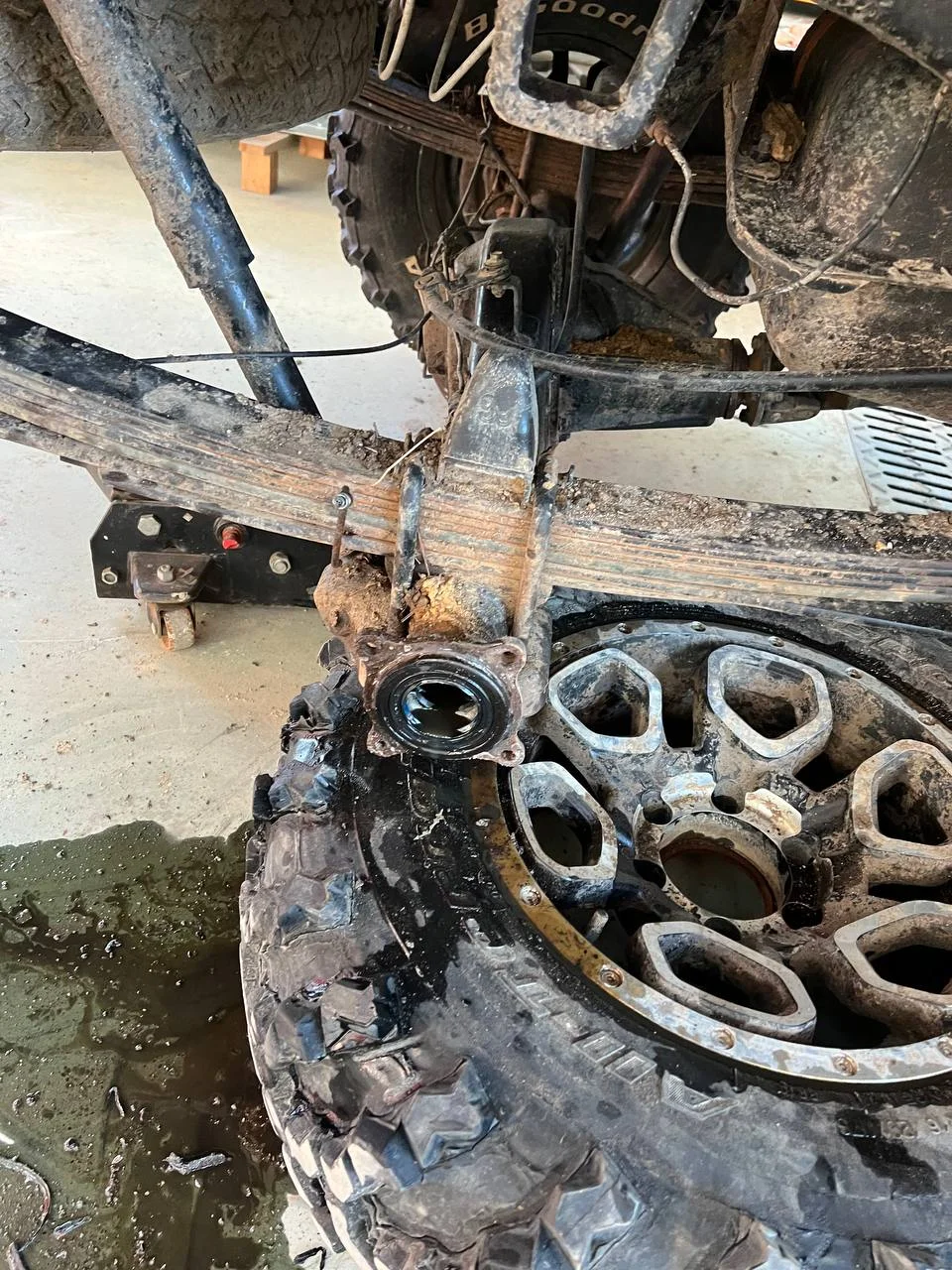

Today the rear right bearings and oil seals went liquid, after I realized the cloud of smoke behind me I pulled over and towed it to my workshop for an inspection. Looks like most of it is toasted, ordered new bearings and seals for both sides, got 80W90 GL4 spec oil for the diffs.

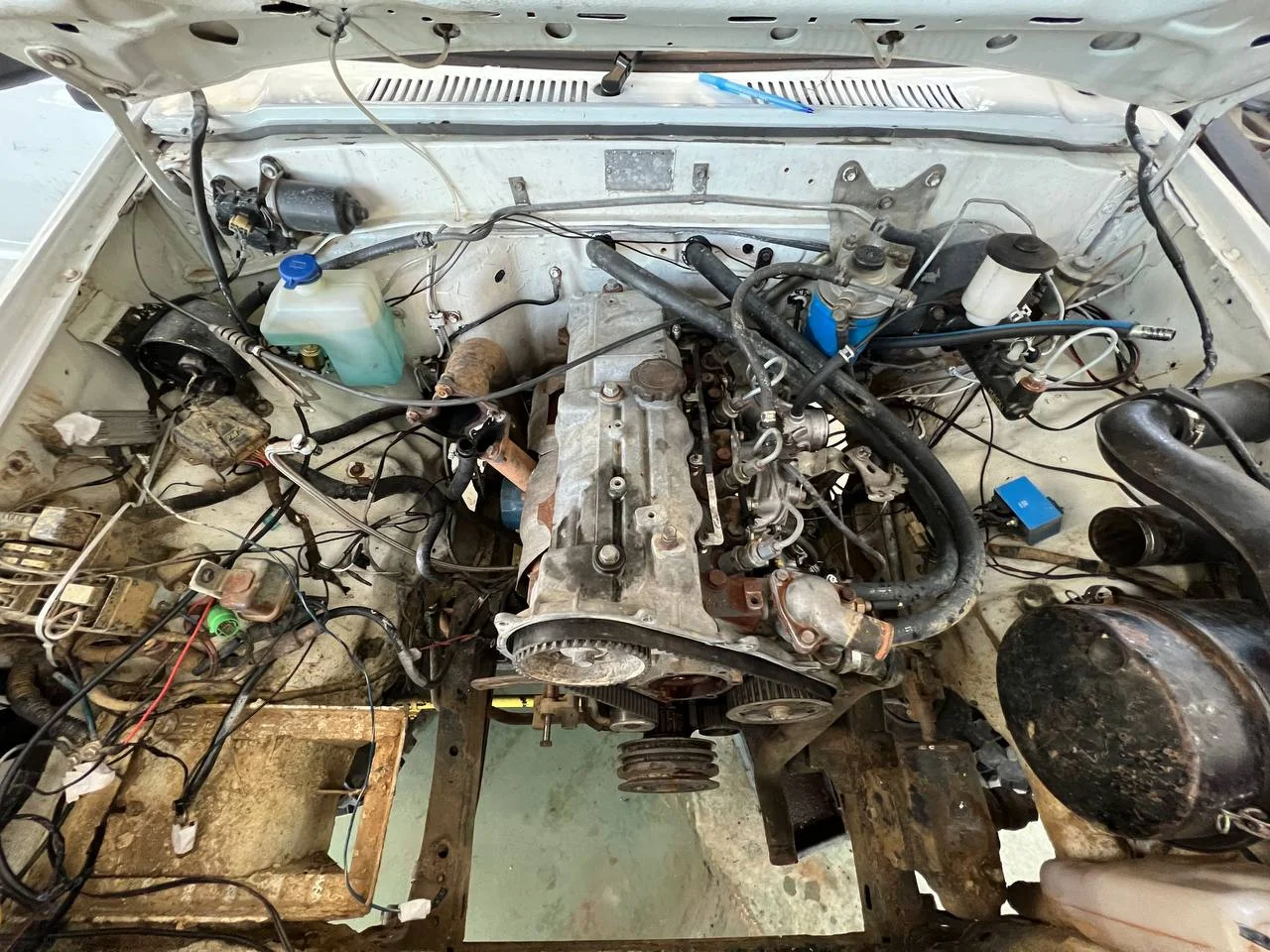

While its sitting in the shop, I took the opportunity to start on engine maintenance, the stupid single crankshaft pulley bolt wouldnt come out (hope it wasnt counter threat) so I ended up drill punch a small hole in the plastic timing cover to extract the oil pump lowest bolt out and got the cover out.
Currently replacing timing belt and idler pulley, also getting the turbo serviced in the meantime as there is excessive soot build up mixed with oil. I'm not keen on the engine rebuild as I can't find a seal/gasket kit so I'm just going to put it back together and wait till the engine/head blows up for the full overhaul. Also would anyone recommend a thicker head gasket for turbo applications? Would a factory 2lte head gasket work? I have no clue what the gasket is currently inside.

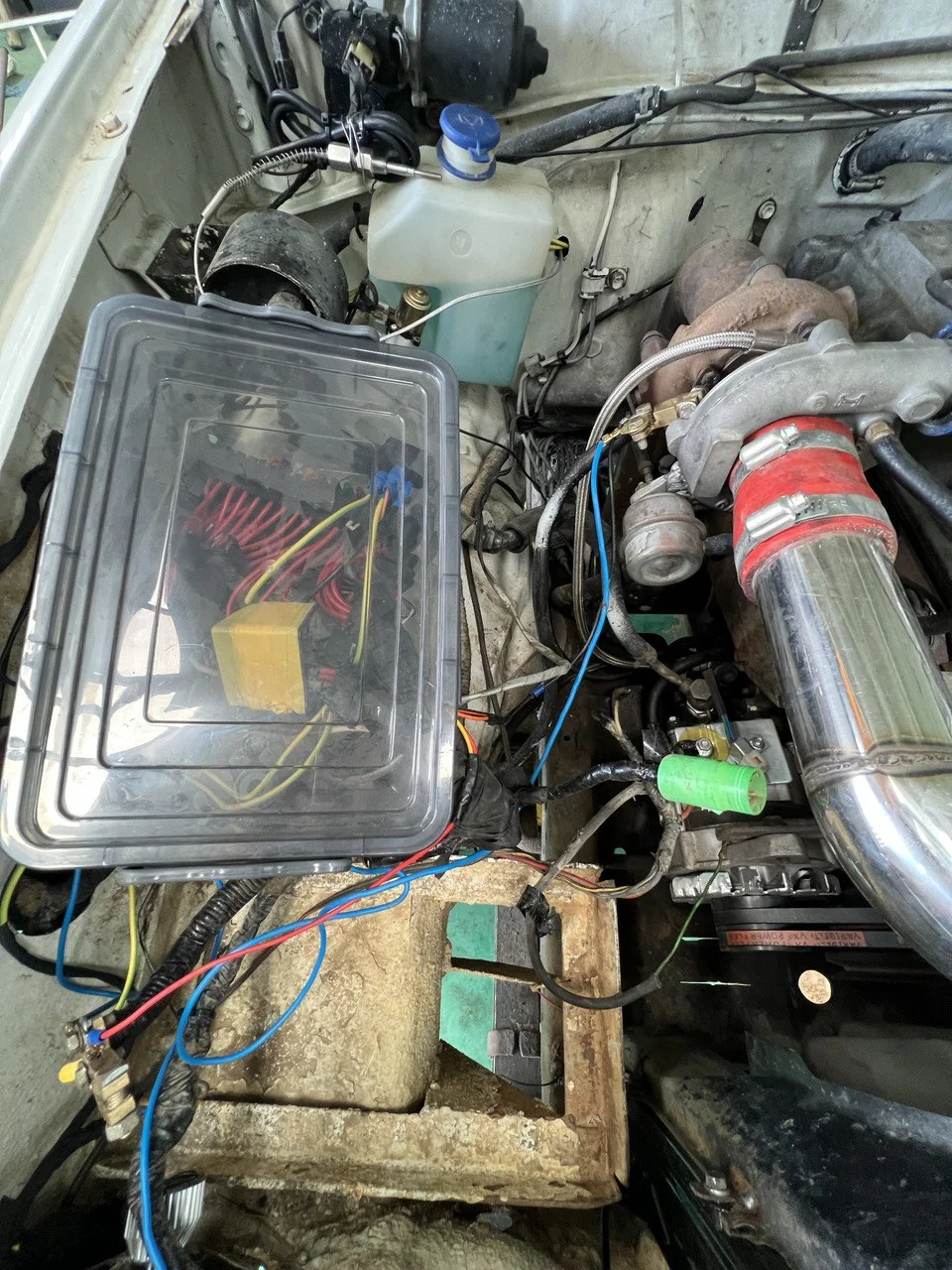

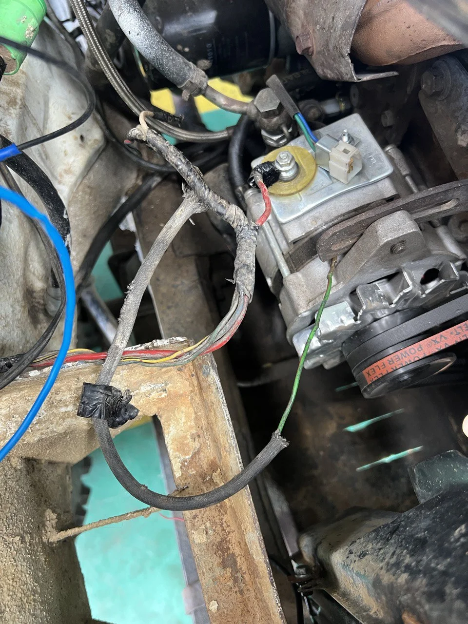

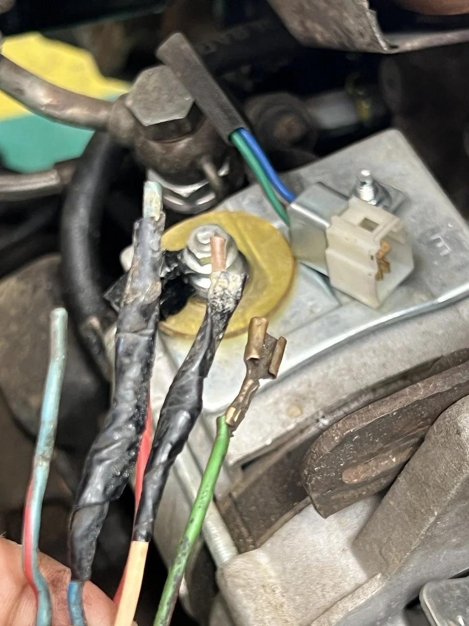

After 6 months both toyotas are sitting next to each other, I only had time last week and got most of the old corroded cables replaced, finished my diy under the hood fusebox. I'm still in search of the exact EWD, most I've found differ from what I actually have. Now I have couple questions for the experienced;
1- Brand new alternator has 4 pin connector on top, goes nowhere and battery only charges up to 12.4V. (I don't know if thats alternatr limited or something to do with the missing connections)
2- Where is the fuel pump solenoid +positive wire supposed to go on the ignition contacts?

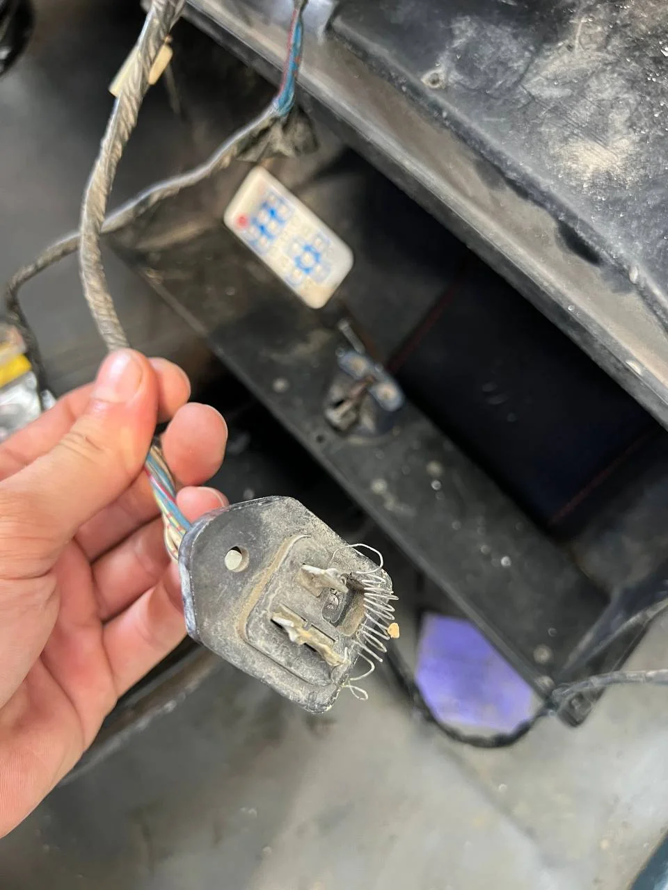

3- Anyone can ident what this is by the glovebox, 4 wires going in and supposedly attaches to another 4pin connector that I can't find. The same wiring loom goes by the inclinometer and climate control lights. Also there is a super professional short I see that held on for years and didnt cause any fires suprisingly.
Do you have a multimeter ? Test the voltage output of the alternator with the engine running.
You should see about 13.5 volts.
Battery should charge to around 12.5-12.7 volts. So you're not far off with 12.4.
The exposed coil you have pictured looks like maybe part of the cabin heater fan system.
Is there a hole in the heater airbox that fits it?
I agree with comments above about the fueling being more critical than boost
Lots of engines do better with more than 6-7psi boost so you are getting enough air to burn all the fuel.
EGT gauge is essential IMO.
80⁰C coolant temp is no issue at all if that's accurate.
Normal operating temperature will be around 85-95⁰C
If your radiator cap is good and holds the correct pressure, coolant shouldn't boil until well above 100⁰C. 110-120⁰C is common boiling point with coolants in the system
Straight water should still have a higher boiling point in a pressurised system of maybe 110⁰C.
