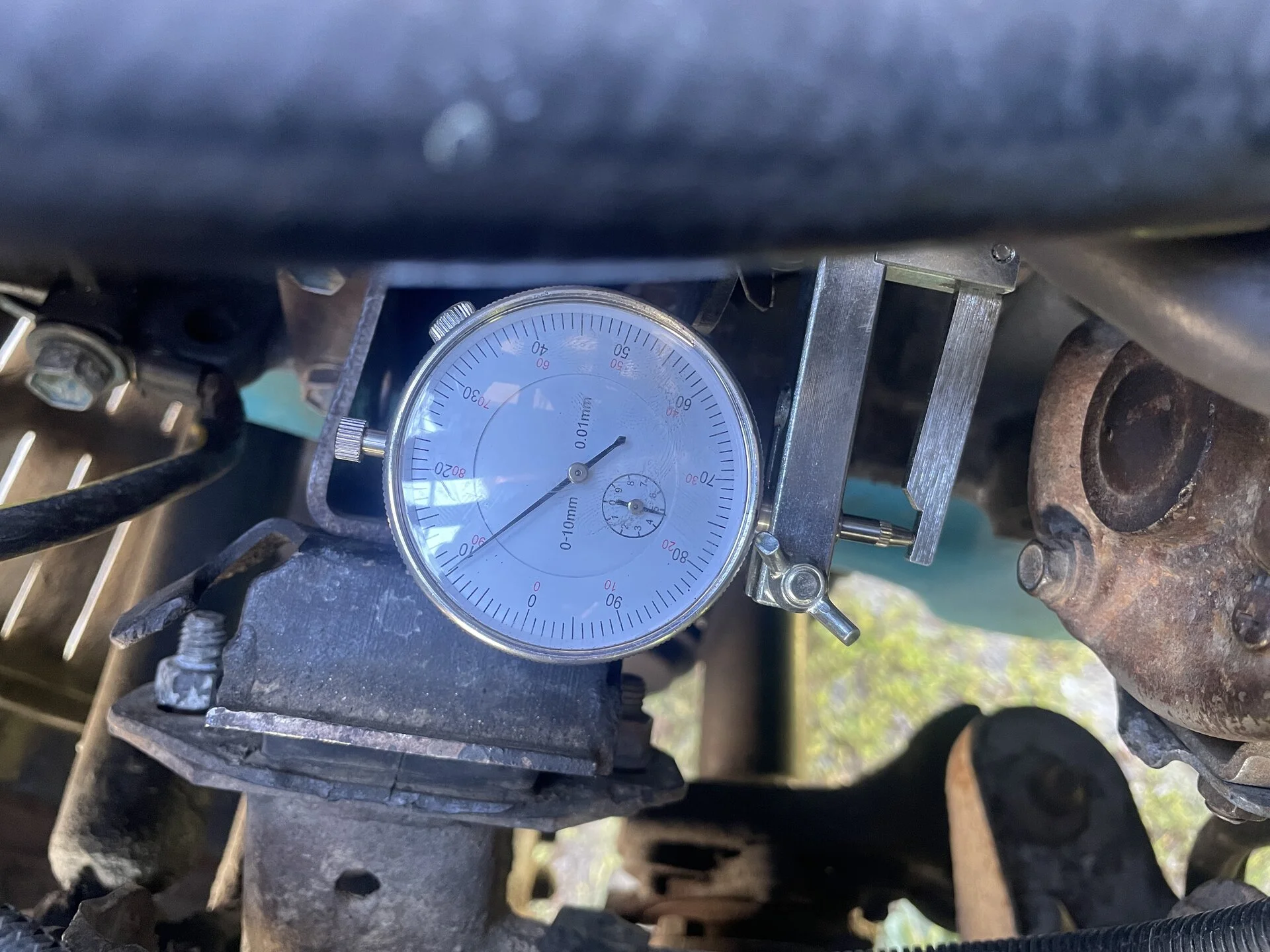

Just got back. The trip up was misserable. I was barely holding second gear doing 25 km/h. After adjusting the timing to factory spec of 1.10mm the truck just feels worse, half of the throttle pedal does **** all, and if I want to even remotely accelerate, I get a big stupid cloud of black soot out the back. I held my foot to the floor and it got up to 3900RPM but I couldn't go any further it would just roll a bunch of coal.
People were passing me going 60 km/h

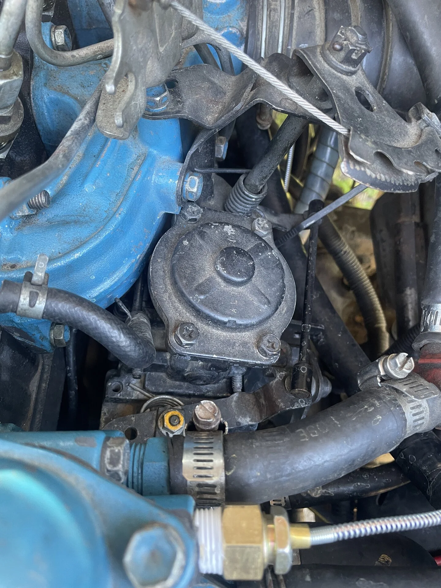

Pump seems rotated pretty far over, I've never had it that far but that's what the service manual wants I guess.
and my max throttle stop is screwed pretty much all the way in
I may back the static timing off like 5 degrees and turn the main fuel screw up a bit so maybe I get some pedal response back
