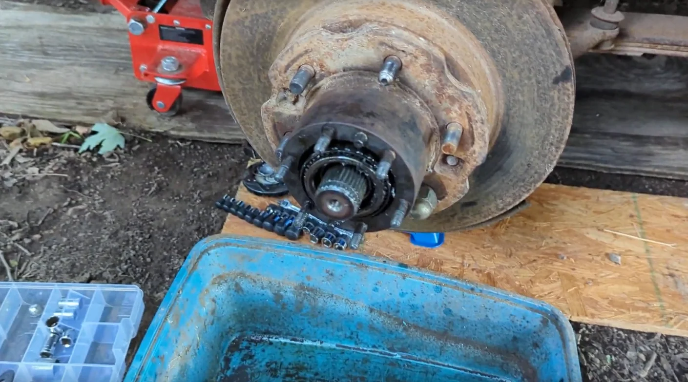

Mine are always at ambient temperature because I am in the middle of a knuckle rebuild :rofl:
