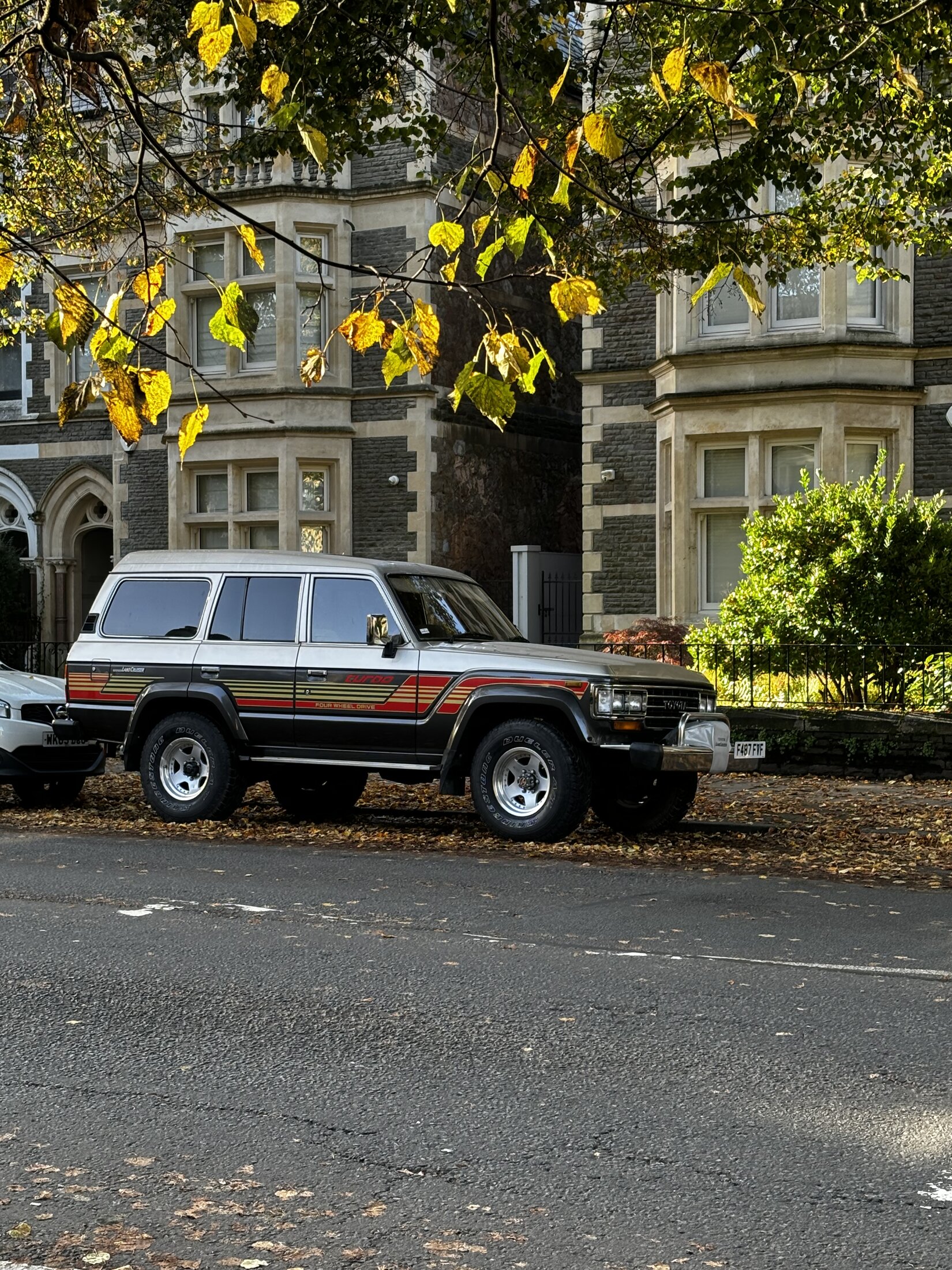

Your right could have ended in tears, I had driven her 150miles at 80mph, going to put 3 point rear seatbelts in now for sure. I guess the 16” Berg wheels are aftermarket but what about the spacers? I guess the wheel arches are oem so hard to think what would of filled them without spacers
Yeah those rims just aren't suitable for a 60 in my opinion.. the offset is far too small
-44mm 15" alloys on mine..
She is a pretty girl. Think you are right about spacers and offset, I will only ever be on the road so I like 16” rims. Think at some point I will have order some more suitable rims.
