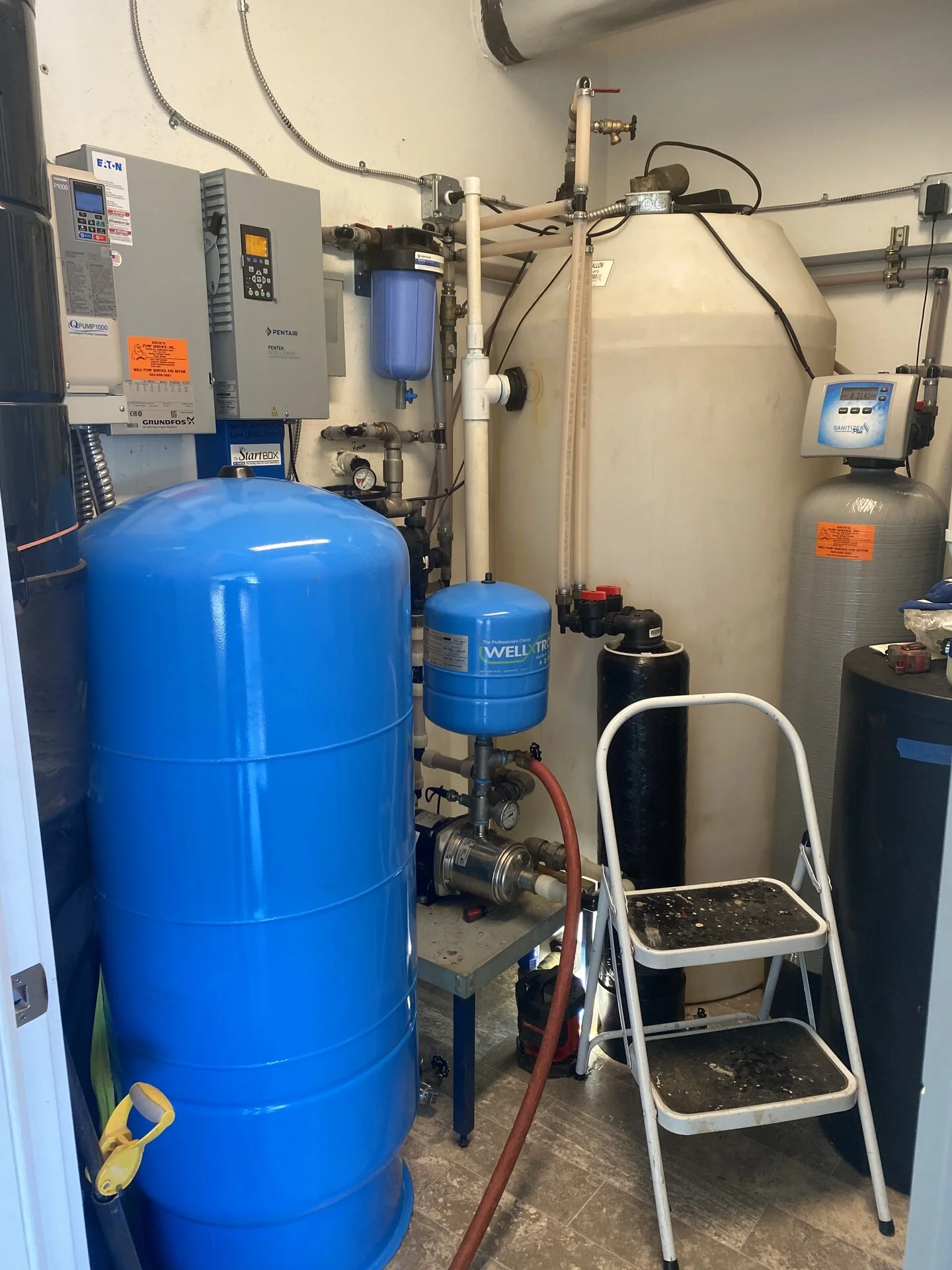

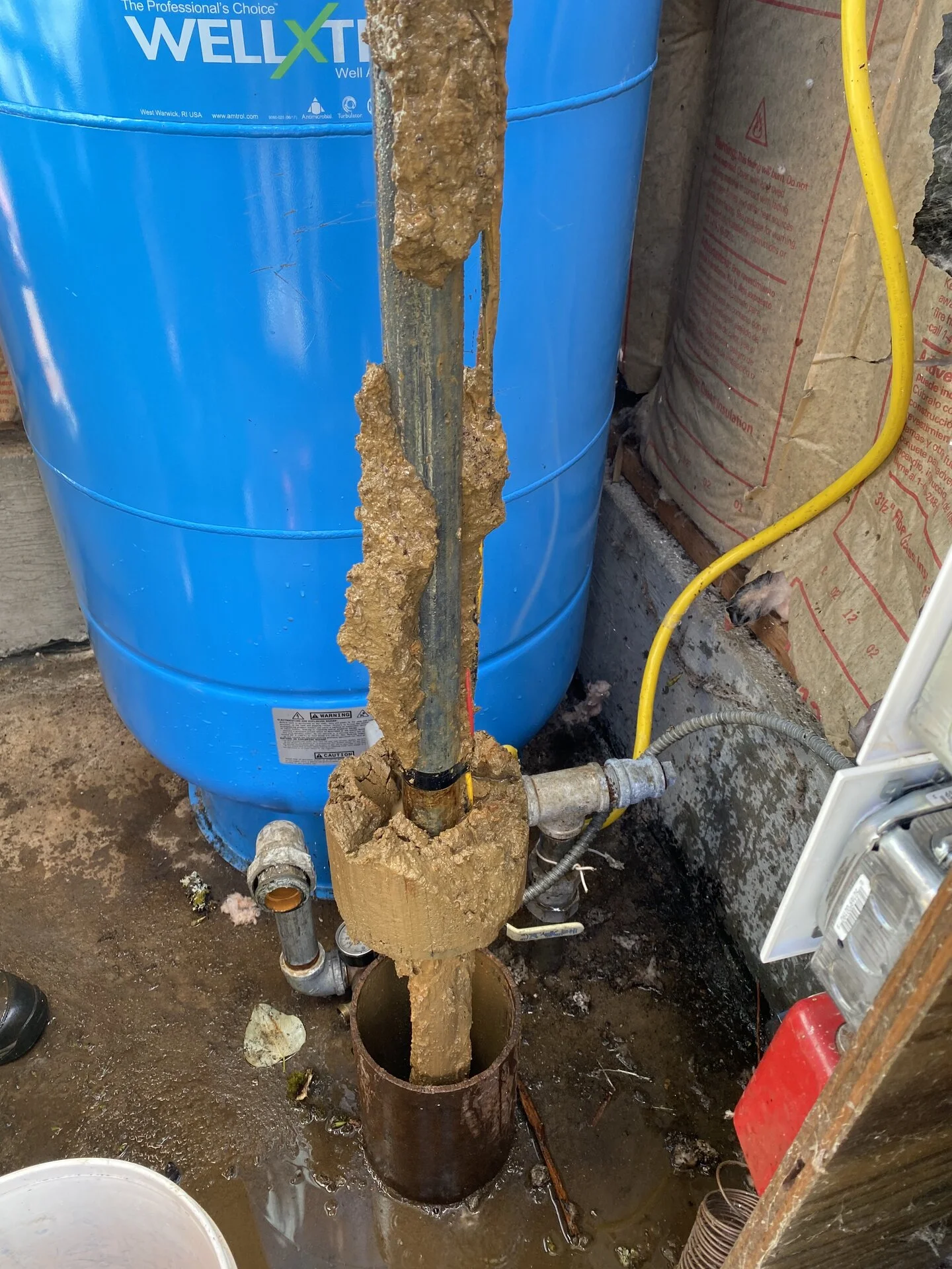

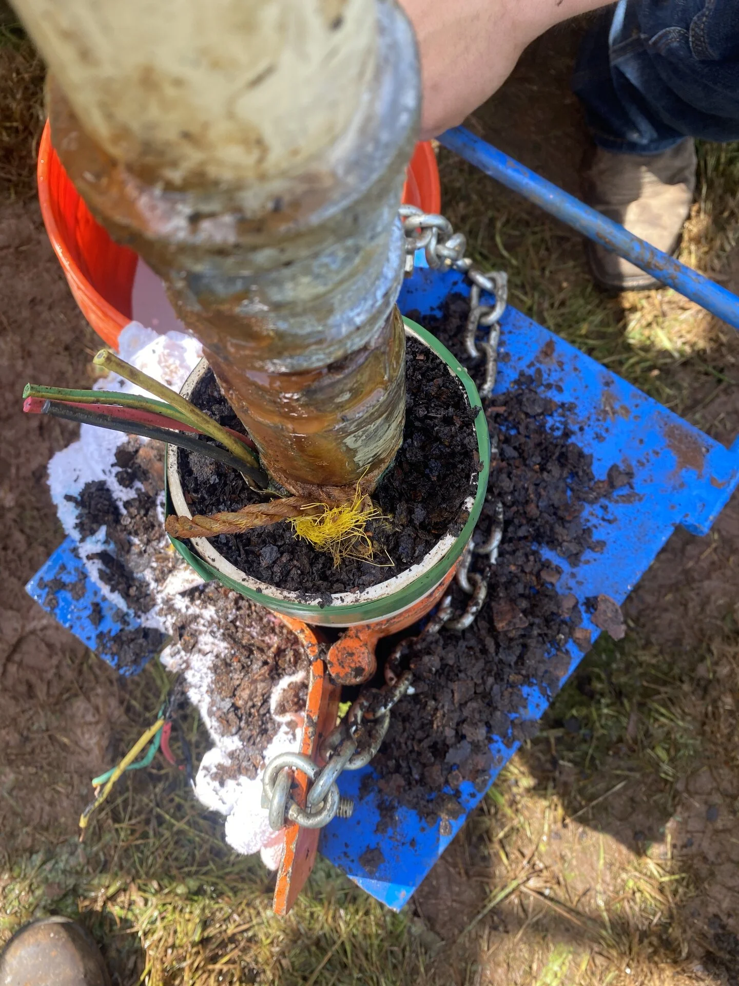

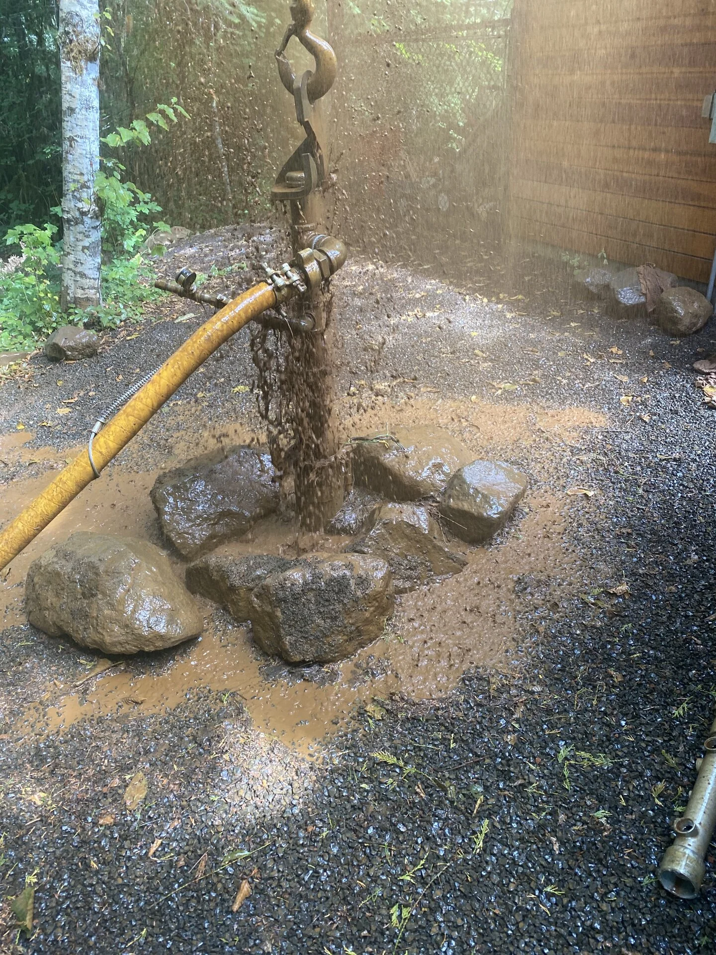

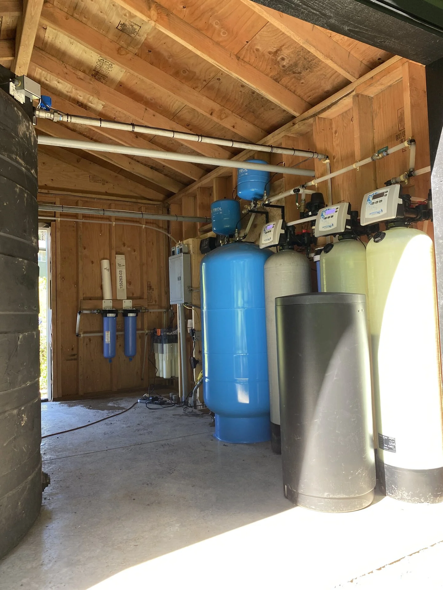

I’ve been in the water well business my whole life. I’ve seen a lot of great wells and the worst of them.

Closing this one out. Installed backwashing filter and a feed pump to raise the PH slightly. Backwash is set for every 5 days in the middle of the night and the pump injects per gallon used. Water test results were actually pretty good - just sediment and ever so slightly low PH. Mounted in the crawl space.
