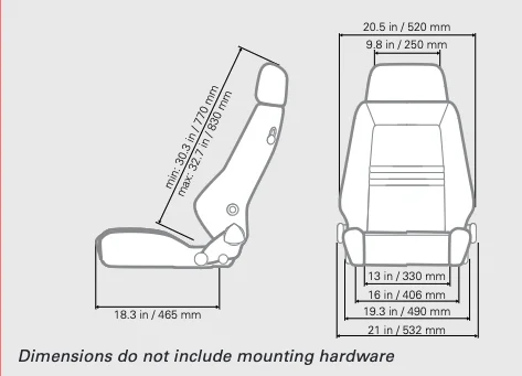

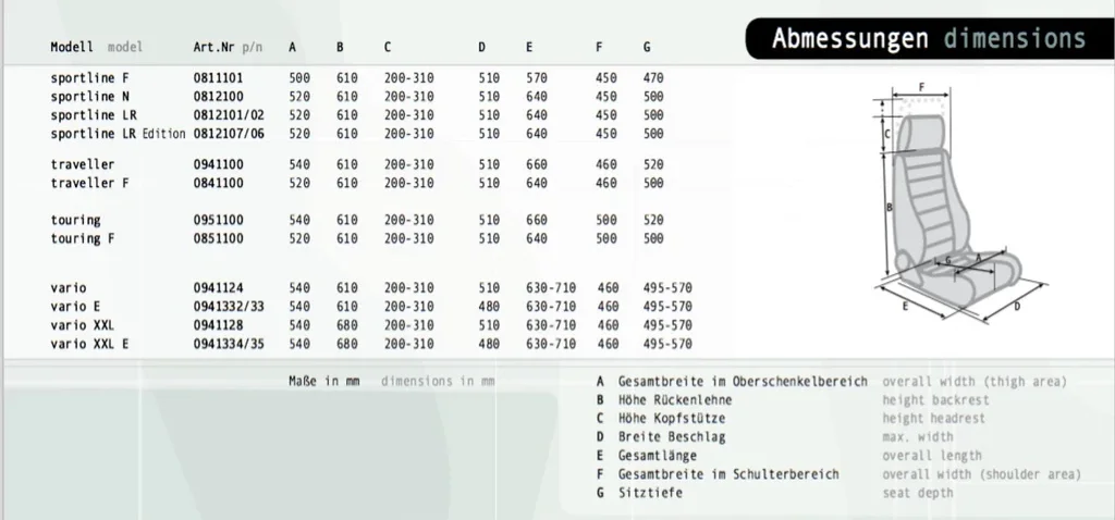

The Scheel Mann Vario F dimensions:
The Recaro Specialist dimensions:
Seems like the Recaro Specialist is a better fit.

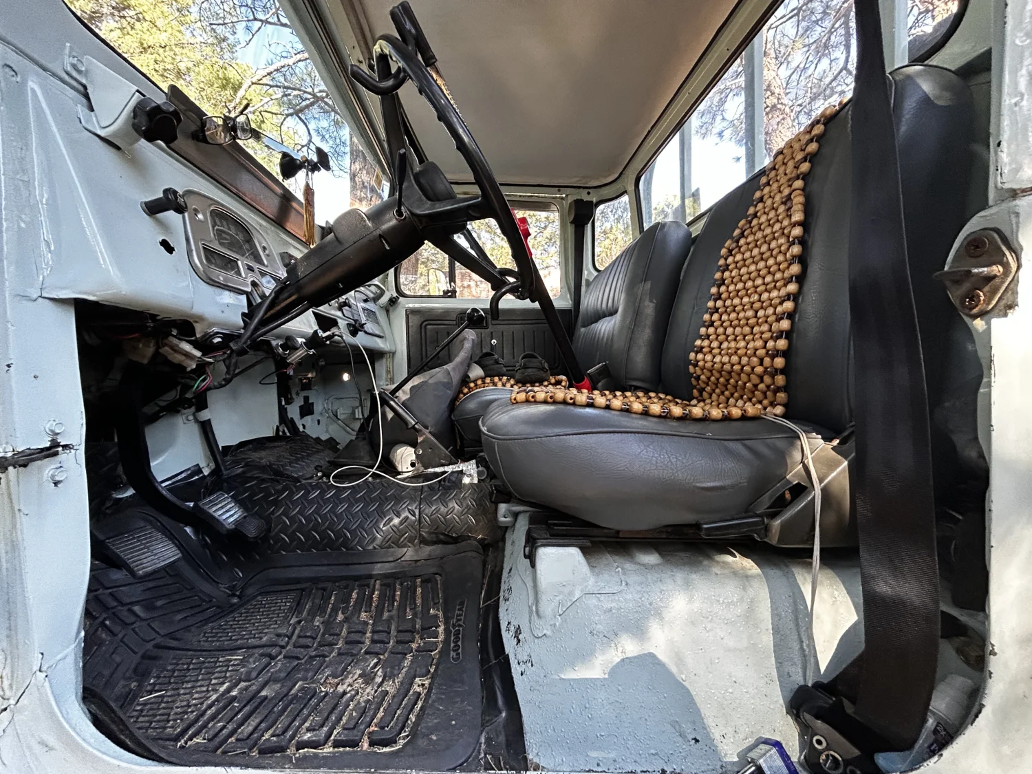

How about a photo of your existing seats?
Mine also sits back against the rear bulkhead, but I find it just about right (I'm 5' 10"). Maybe mine is thinner at the back than yours?
I have a 120L long range tank under my seats though so my seat sits higher by around an inch.
This does make it a bit tighter against the steering wheel, but might give you a bit more leg length if the base isn't too thick

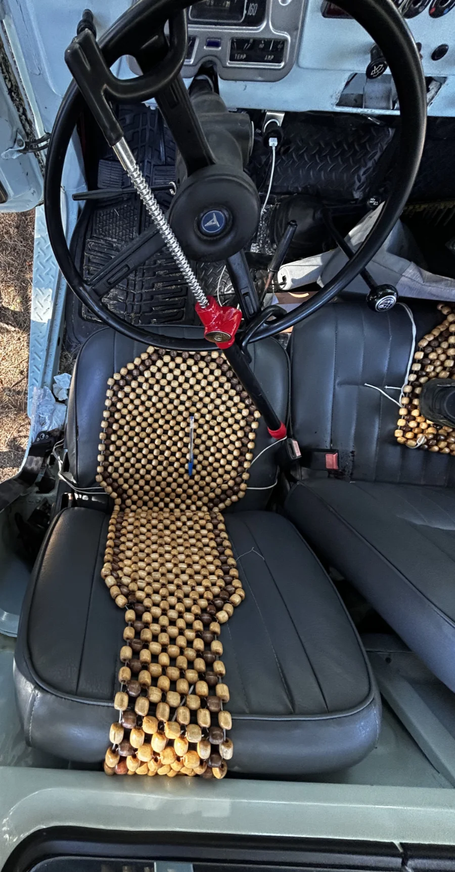

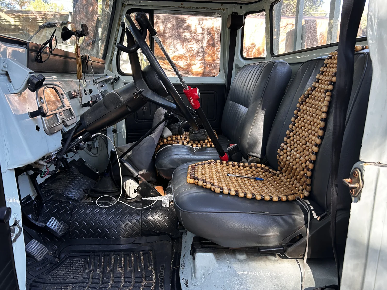

Here are photos of my seats.
From the measurements I took of the OEM seats as well as the online measurements of the Recaro & Scheel Mann, seems like the Recaro Specialist would work just fine. Again, a tilt steering column would probably solve the issue of ease of ingress/egress. The other issue is leg room. The Recaro Specialist seems to have the same depth as the OEM seats: question it how the overall thickness/depth of the seat will work with that back wall/bulkhead...
