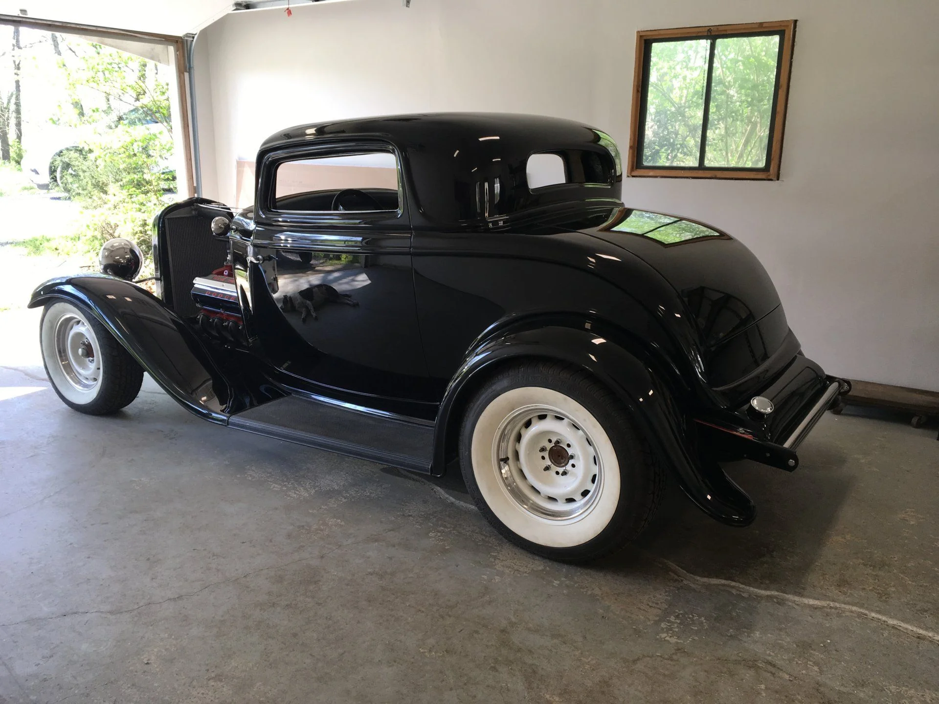

The steering idea is way out in left field. Bare with me. I also have a '32 ford 3 window that is mostly complete. It's got a Clear Steer steering box installed. It's quite slick really. Alows you to aim the column a little flatter, at any height on the firewall, and as low as you want in the engine compartment. It also prevents the pole vault effect in a front end collision. Not sure I'll use it but it's a consideration having experience with it.

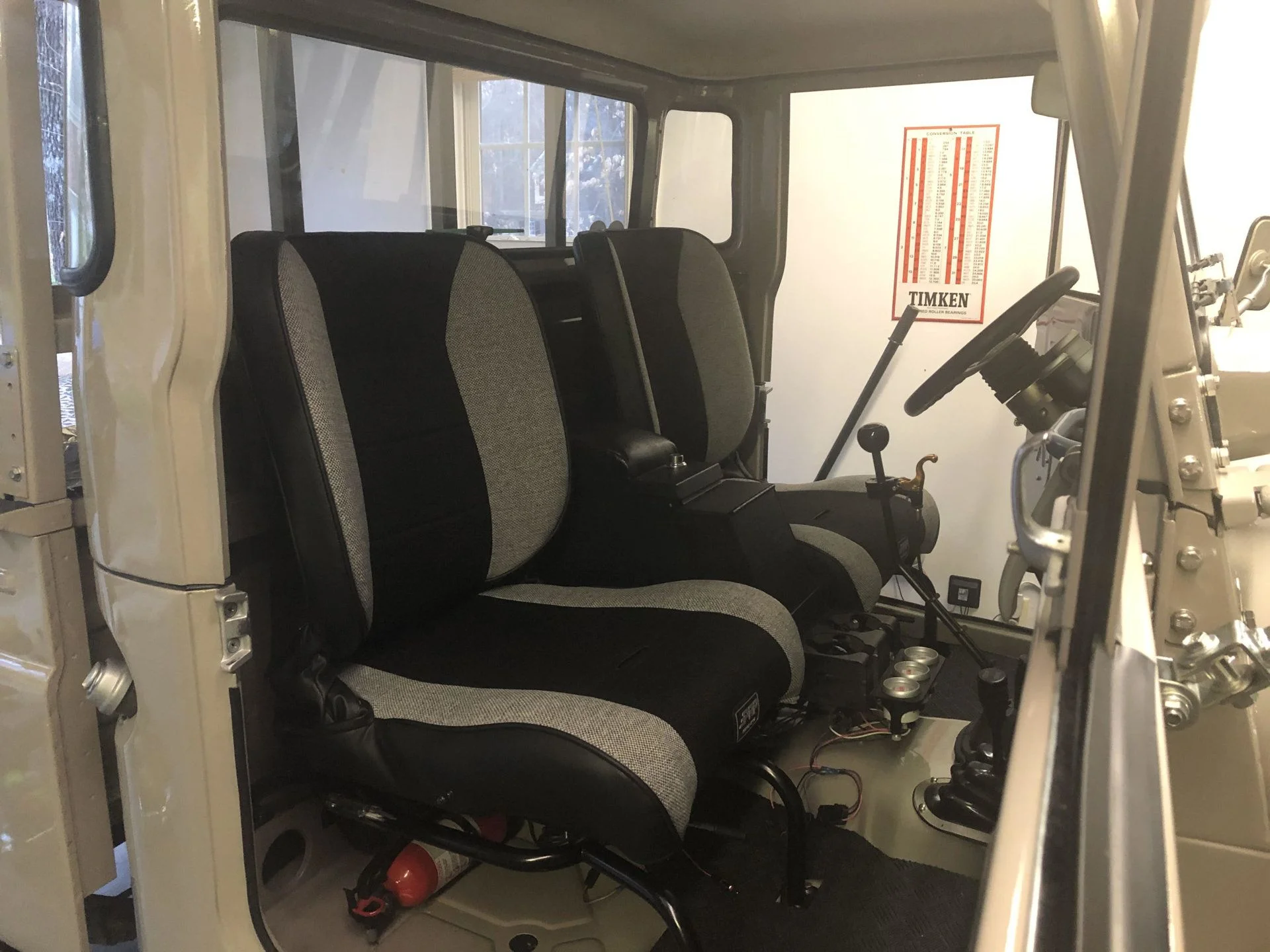

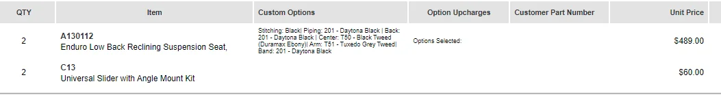

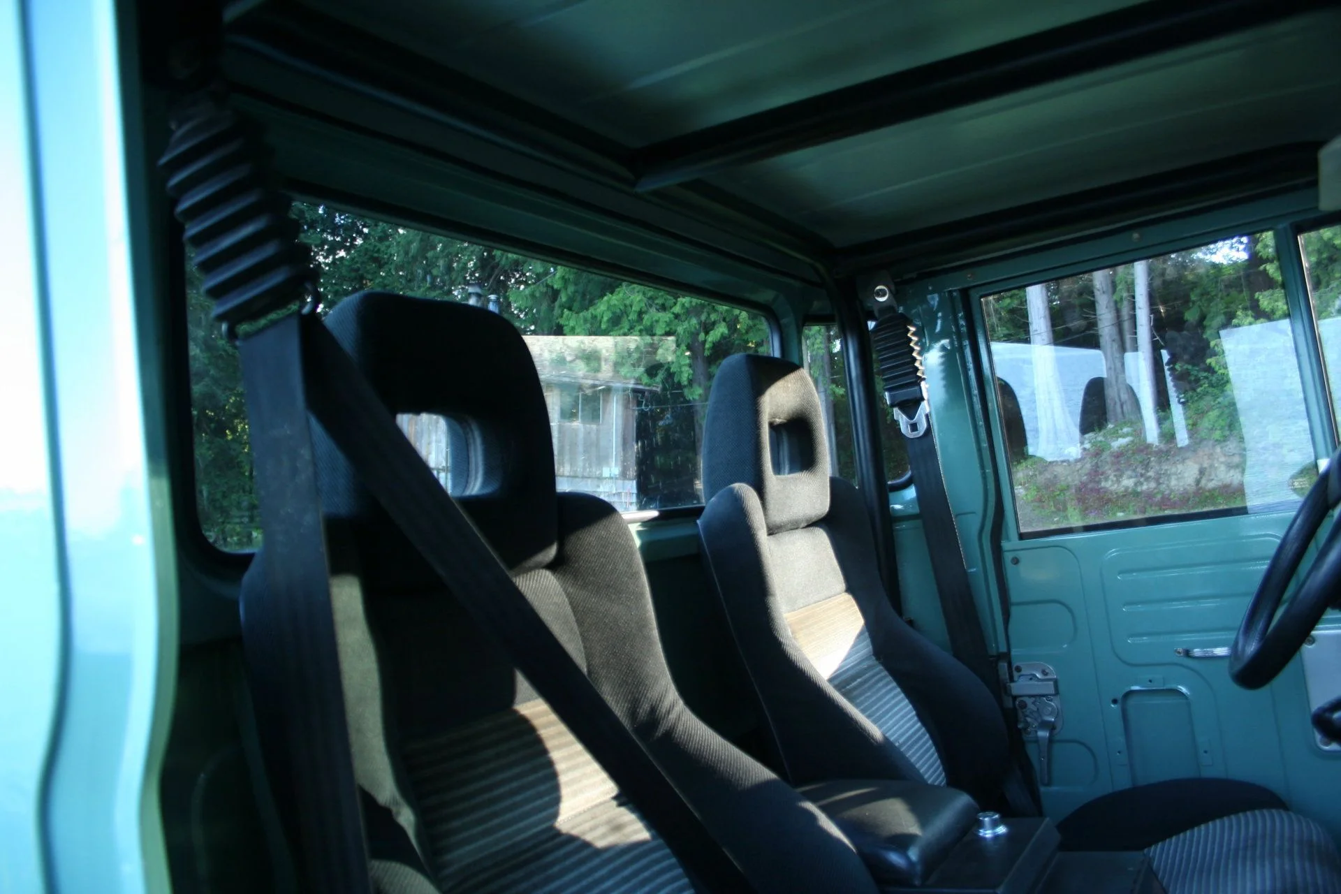

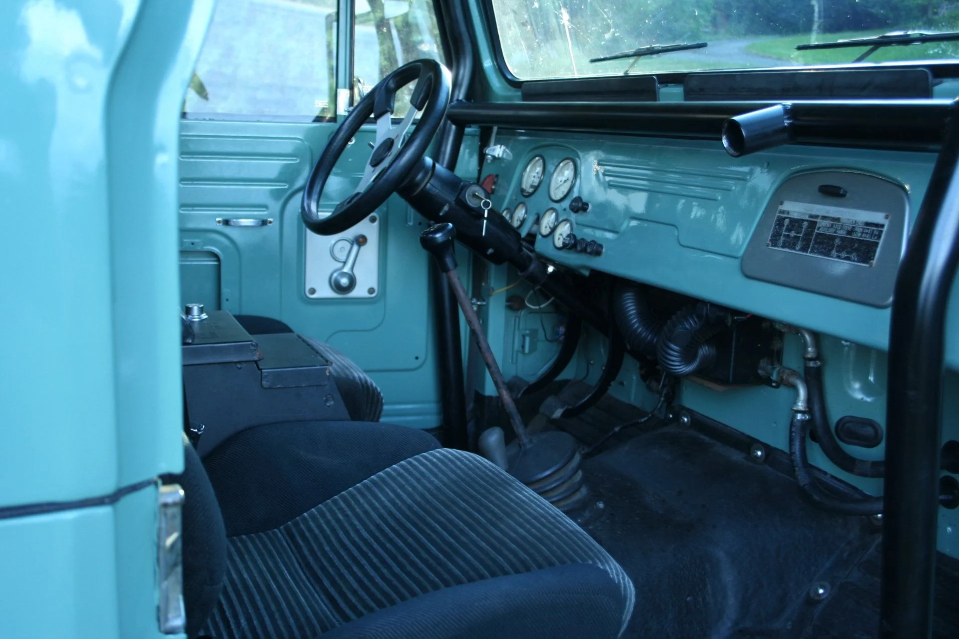

I run a Flaming River tilt column and a 13.5 inch MoMo wheel connected to a Saginaw box. I decided to go with a (slightly more period correct looking?) low-back PRP seat. I was very happy to dump the high-back Corbeau reclining suspension seats. I go 6ft and 225lbs, so maximizing the room and comfort was a work in progress. The high back seats forced the drivers seat to a more vertical position than I would like by their contacting the rear window glass.
Nice seats. Just a little too fancy looking for my taste in an old FJ45. Just went to their site and found something a little tamer. They do have a smaller footprint then the Tacoma seats I measured out to try. Just maybe I'll pull my Taco driver seat and sit it in the Cruiser and just try it out. I think I'd like something similar, used, and in need of upholstery. That way I could add heat and the finish look I want that matches whatever I decide to paint the truck.

@Cirbo wouldnt still have the pn's for which prp's you used? My back still hurts from the stock seats. Yours seemed to give at least another inch or two of leg room
