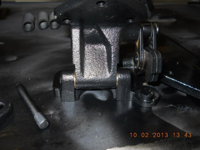

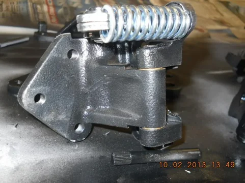

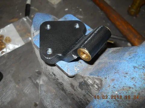

Take a look at these......

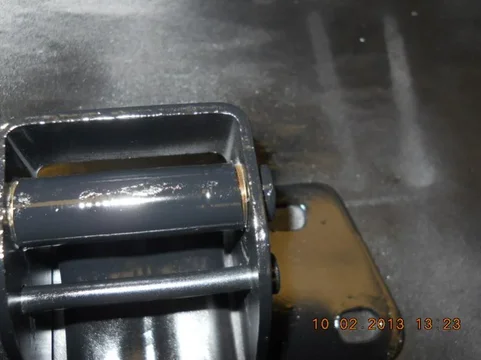

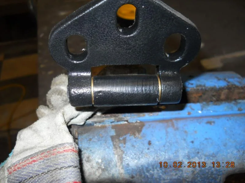

I tested these today. No drilling, no resizing, just a little technique. Then touched up the paint.
WHAT DO YOU THINK?
They are tight as a tick. You will have to use both hands to open the door the first few times......

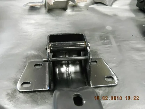

I realized after I did these two that I didn't remember which way the hinges are put together! I have to look at some of my other hinges to verify assembly is correct, then I can proceed with the others.
The hood hinge needs an e clip on the catch rod, and it will be finished. It is very difficult to disassemble without destroying the pin. The pin is an odd shape that is mushroomed on the end to hold it in place. I had to grind a small amount off to get it apart, and carefully mushroom the end again. It looks mostly OEM. I think it would go unnoticed by even the pickiest observer. I am actually pretty proud of the job I did on it.

ok, you going to tell us how you pressed them in there, without drilling. I understand if trade secret. :)
They do look great!
Oh, it's a trade secret alright! I will get a guy in the shop to video me assembling one and see if I can post.

Great job! They look terrific and if they are tight all the better! Thanks for taking this task on to become our hinge expert!!!!

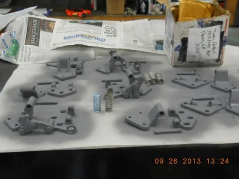

I finished the assembly of Delancy's today. The only thing left is the other hood hinge, which I am trying to put off indefinitely. What a pain. I realized my dilemma today. With the hinges in pieces, I do not know which way the hinges align. I kept the pairs together, but I had to photo some hinges on doors that I have just to be sure. Once I got to the shop, I was uncertain if the hinges were flip-flopped for the opposite side (PS vs DS.) Having said that, before I send them out to Delancy, I will have to remove all 8 hinges from my doors, mark them, and use them as a template to be sure that they are assembled correctly. For a newbie like me, it is not obvious how they go together.
Check out the stack! sorry about the poor lighting and black background.

I have not tested them with a door yet. I will be sending out this week to Delancy. They appear an exact replacement to the OEM. I am going to send his old ones back with him, in case he doesn't like them. They should work great.
I finished the other hood hinge yesterday. Upon closer inspection, it appears to be slightly bent. I think it will be fine, though. I have to find and e clip for it also.

They look Fantastic!!! Really look great - if they work as good as they look, I think this is something that will help every pig keeper out there. I always wear my seat belt and always check my door closed fit just to make sure I don't fall out.
