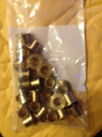

Delancy, where did your bag of bushings come from?
Scrapdaddy, Beno, said that he could not find where a bushing is used on a 40 door hinge. So, where can I get me some?

A Mudder who sells to repair 40 hinges. I'm not sure they'll work with the 8mm pin, but trying to confirm.
Gladly send these, today, if they'll prove beneficial to the cause.
Be back with link.

Ok, I am ready to give it a shot. I will order springs today. Send me an upper and lower DS front hinge and 4 of your bronze beauties, and I will rework them. If you like them, then we can talk about money, later. I figure if the Driver door works good, then the others will be a cinch. If the bushings will not work, I will just send it back to you. We will reuse the old pin, bead blast everything, prime and epoxy paint black. Sound good?
sure, send the bushings too. I am hoping for a miracle here....The only thing that i know that cannot be touched is the extension arm that stops the door from opening too far. That part is pressed in place. It has plastic bushings in it, but this part does not support weight. It should last a long long time without attempting a rebuild.
