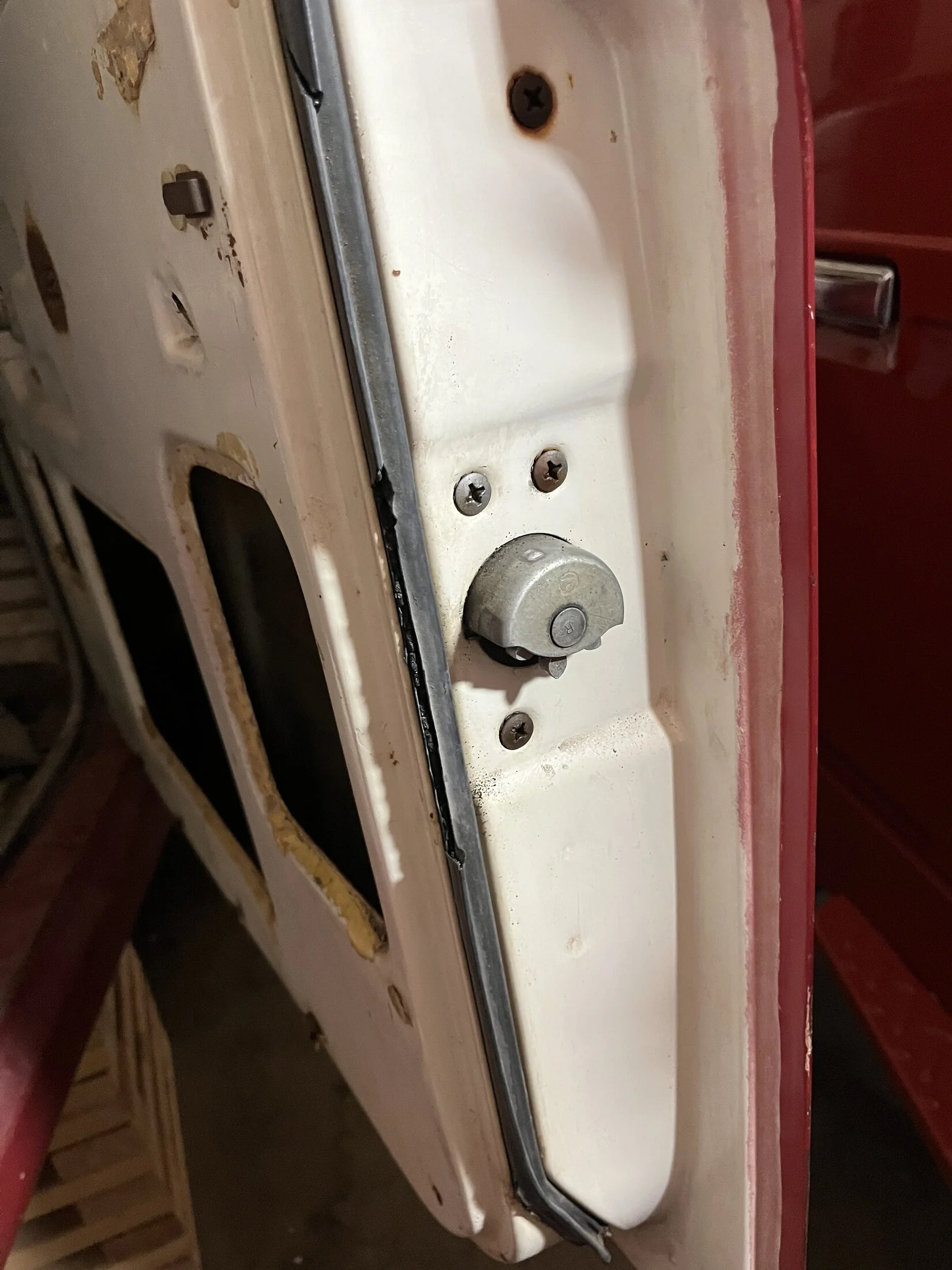

Thanks for trying but that is the newer style. There is a groove/dent in the top on this one. The older style is round across the top of the whole piece. Again, I very much appreciate the effort.

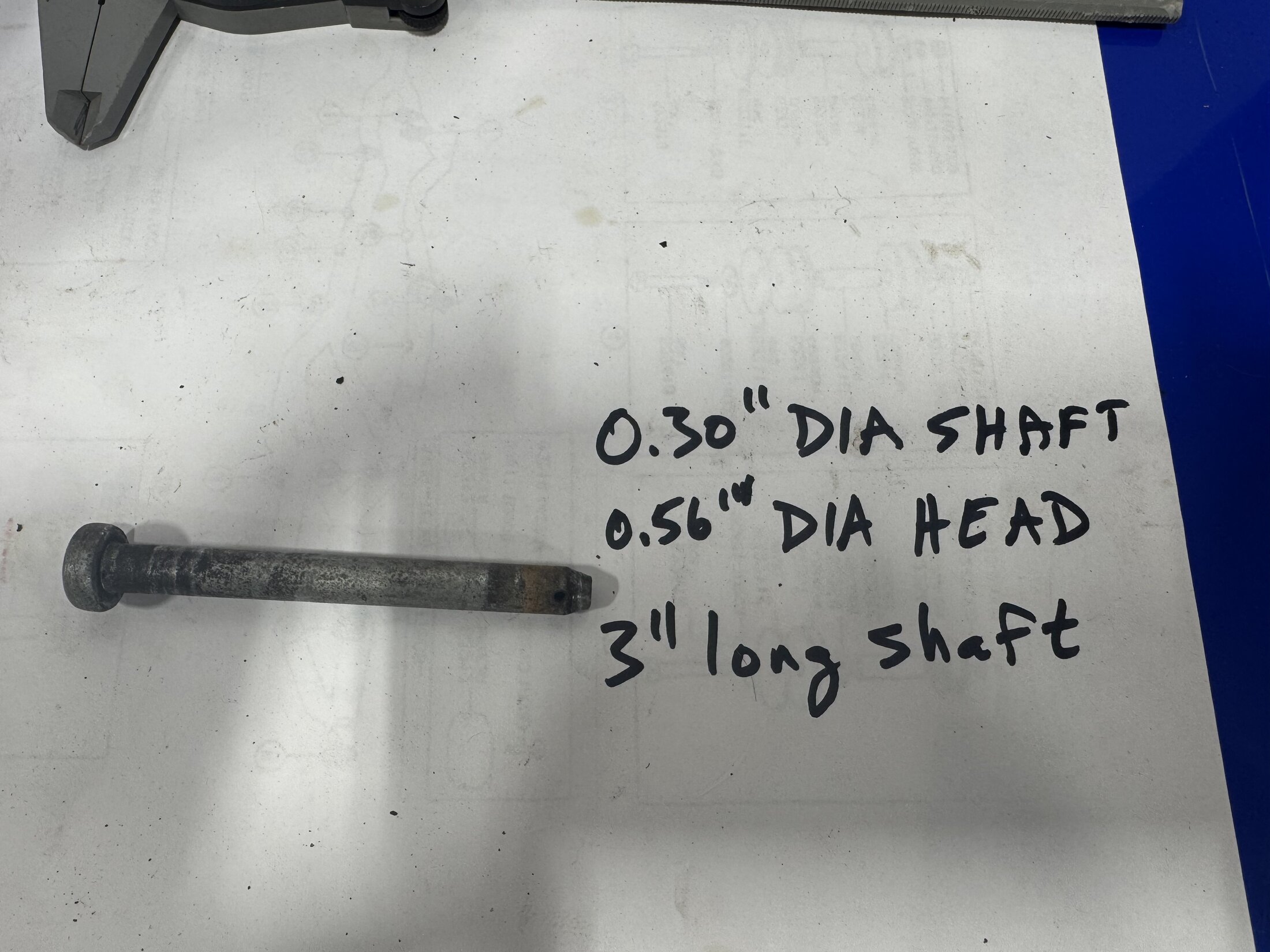

The 3" shaft length was to the middle of the taper +/-

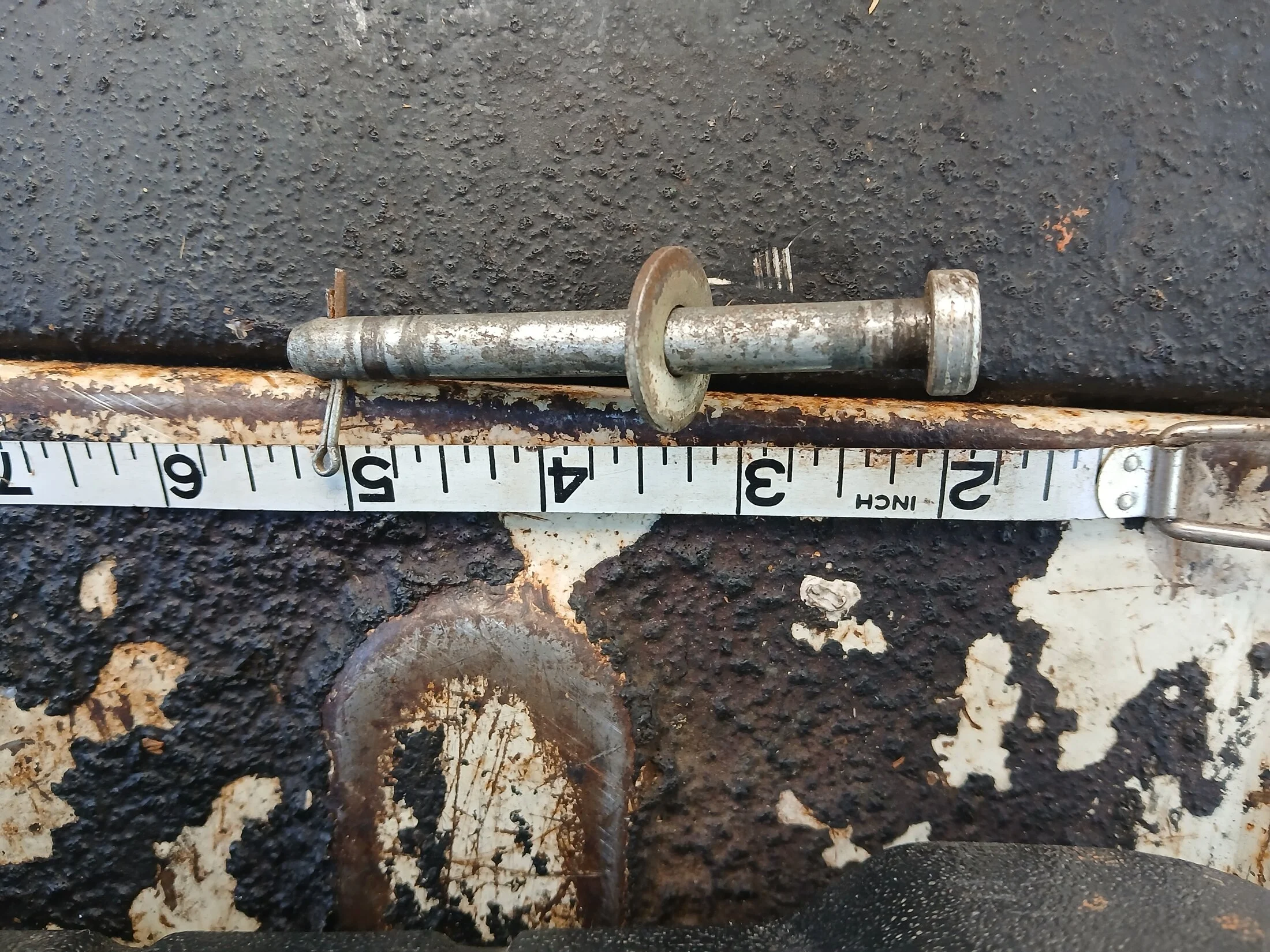

This one might be a tad long but would certainly work:
Perfect, thank you very much! I am going to take latch mechanism out of the door tomorrow and see if it can be repaired.

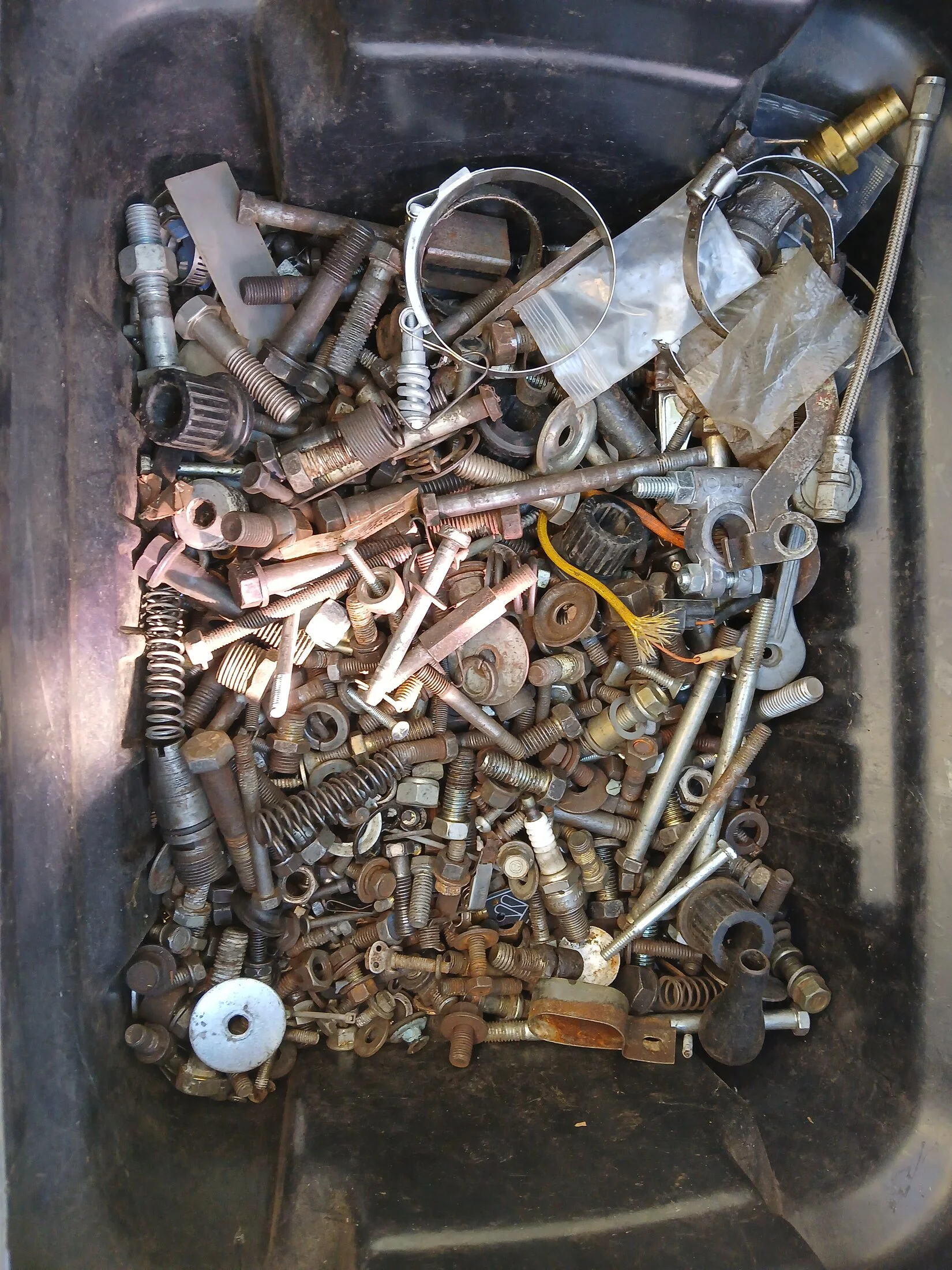

I looked in a spare pieces bin, found one so far. I have more places to look.

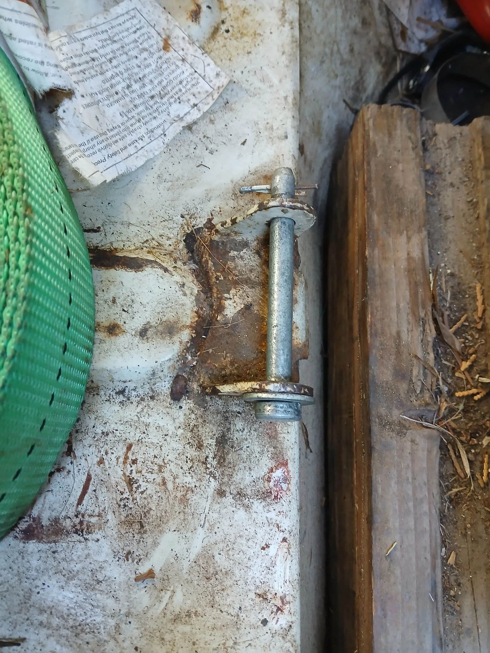

Wouldn't an M8 bolt work?

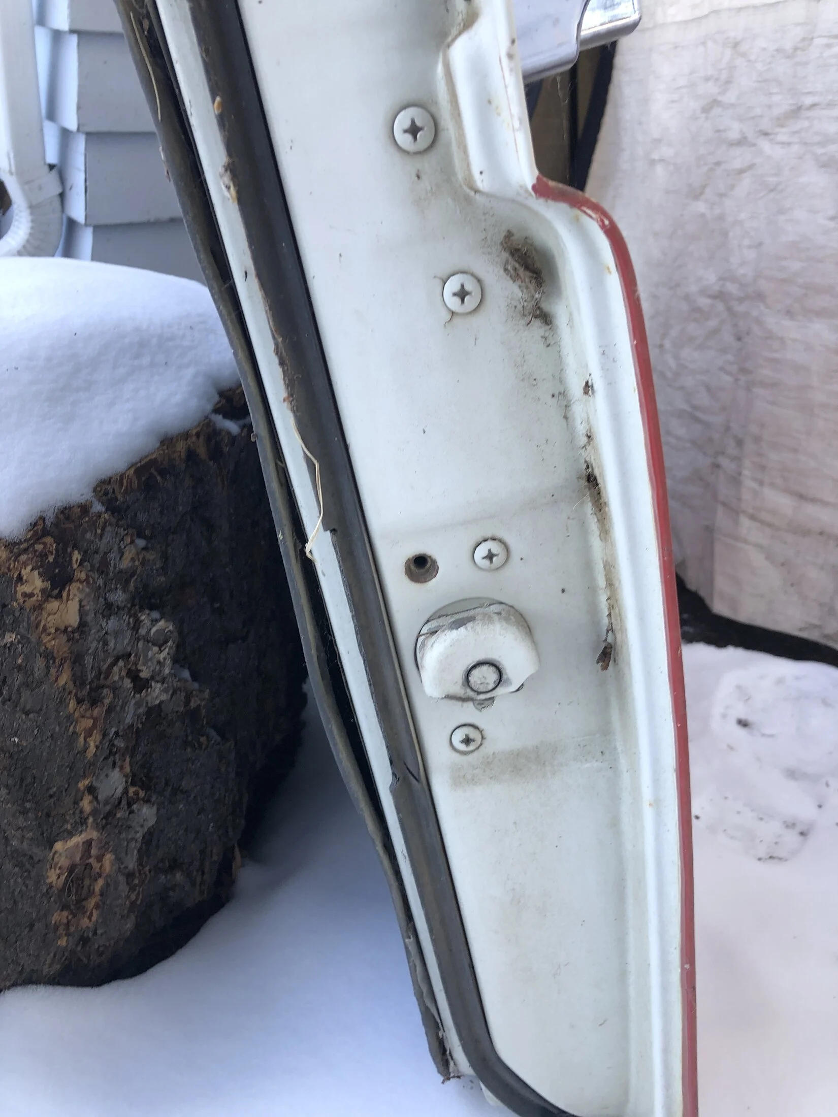

Success! The newer style latch mechanism will substitute for the old style. Had to adjust striker a little too.
If anyone is reading this the new style latch did not work. Door would close and latch safely but after only a dozen shuts(?) the striker was making a notch in the new latch housing and was destroying it. So I cleaned , lubricated and flipped an arm/lever around inside the old latch and got it to function again. I also adjusted striker and now door closes and latches perfectly. It is a good thing too, because I was never able to scare up an "old style latch".
