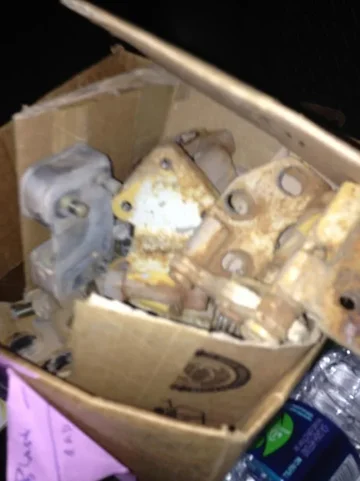

The (60) bushings from SouthBoston were slated to ship direct to you today, so betting it'll be tomorrow or Monday when you receive.
I picked up the hinges off the 72 yesterday,
and will be shipping to you separate of the large load, via UPS, tomorrow.
I'll have to wait for these to return to swap for those on the 76 that will be your future cores, because Britt wanted the ones you already rebuilt to align doors with body panels (he said you did a nice job, by the way) and I can't remove anything from the 76 that I can't immediately replace, due to the title debacle.

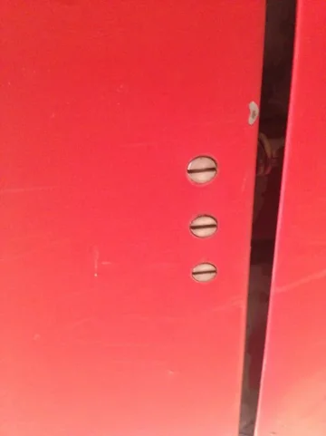

By the way, what is going on with the red door? It looks like cam locks on an IKEA desk.
Good question, but I didn't realize the magnitude if the issue until it dawned on me that the other front PS door I have, that's in better condition, is incompatible.
It looks like they bolted a small heavy gauge stick of angle to the inner hinge face of the door, then attached it to the outer skin with the Ikea fasteners, with hinge bolted to the angle.
Probably explains the new hinges that were in the back seat, but unsure how to reinforce the hinge recess in the door itself, now.
