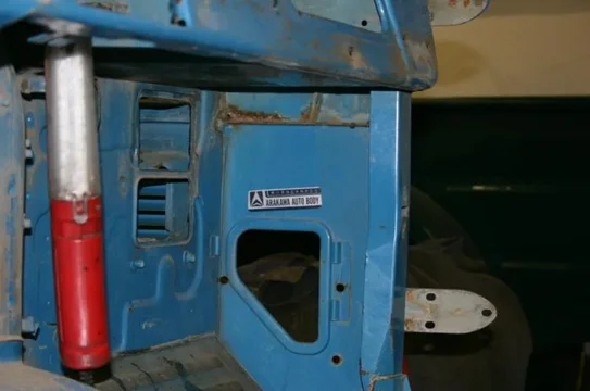

Here's something funny: the Arakawa sticker is crooked! I can't imagine that any of the POs cared enough to replace it, so I'd put money on that being the way it was applied at the factory. Think I should put the replacement on in the same spot?
And here's something I need to get off of there tomorrow.
This placard's days are numbered.

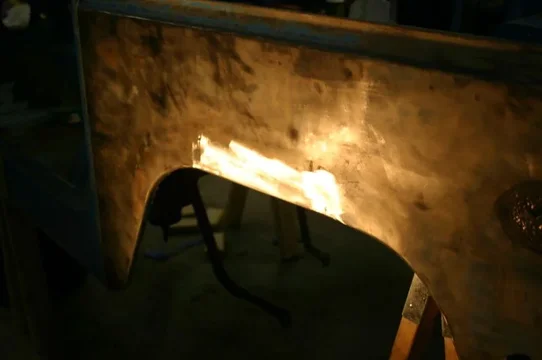

airplane stripper... the stuff works...
we used it on a FJ40 tub a couple decades ago, from caked on 4 layer paint to bare metal in 1/2 hr... that was the entire tub!!
i am not recommending it just stateing my experience...

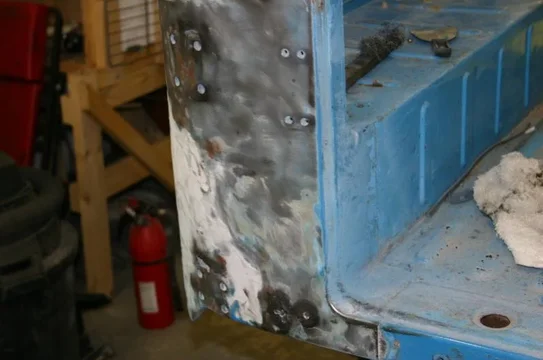

Well, there's more rust and bondo on the right side too. Surprise, surprise.
The bondo is really deep in a few spots.
So, I tried out some of the aircraft stripper we had lying around the shop. Pretty old, and I think the stuff must go bad, but it worked a lot better than the aerosol stuff yesterday. Got most of the paint off of the inside left fender well, and the left side was completely clean.

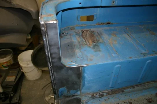

So, since I was getting a little tired of paint stripping, and I needed to let it do it's thing, I decided to tackle one of the easy rust repairs on the left side.
The pics tell the story...
Here's the patch panel I made. (oh so high-tech!)
Here's where it goes (and the rust it is replacing, not totally rotted out, but certainly on the way. Also, bent.
I definitely like to cut inside the lines and later trim out to fit. I use a combination of files and a 120 grit flap disc in the grinder to trim it out.

Just to prove to myself that I can still do some of this bodywork stuff (it's been a while), I hit it with a little primer.
I'm pretty pleased with how it turned out!
It won't stay that way, as at some point the whole thing will get sent out for soda blasting (or some other sort of media blast). I haven't decided if it's better to get it blasted now, to make the bodywork easier, or if I should just strip it as I need to do the bodywork, and get it blasted just prior to paint (unless it takes me a LONG time, we'll be taking it into town for paint anyway).
