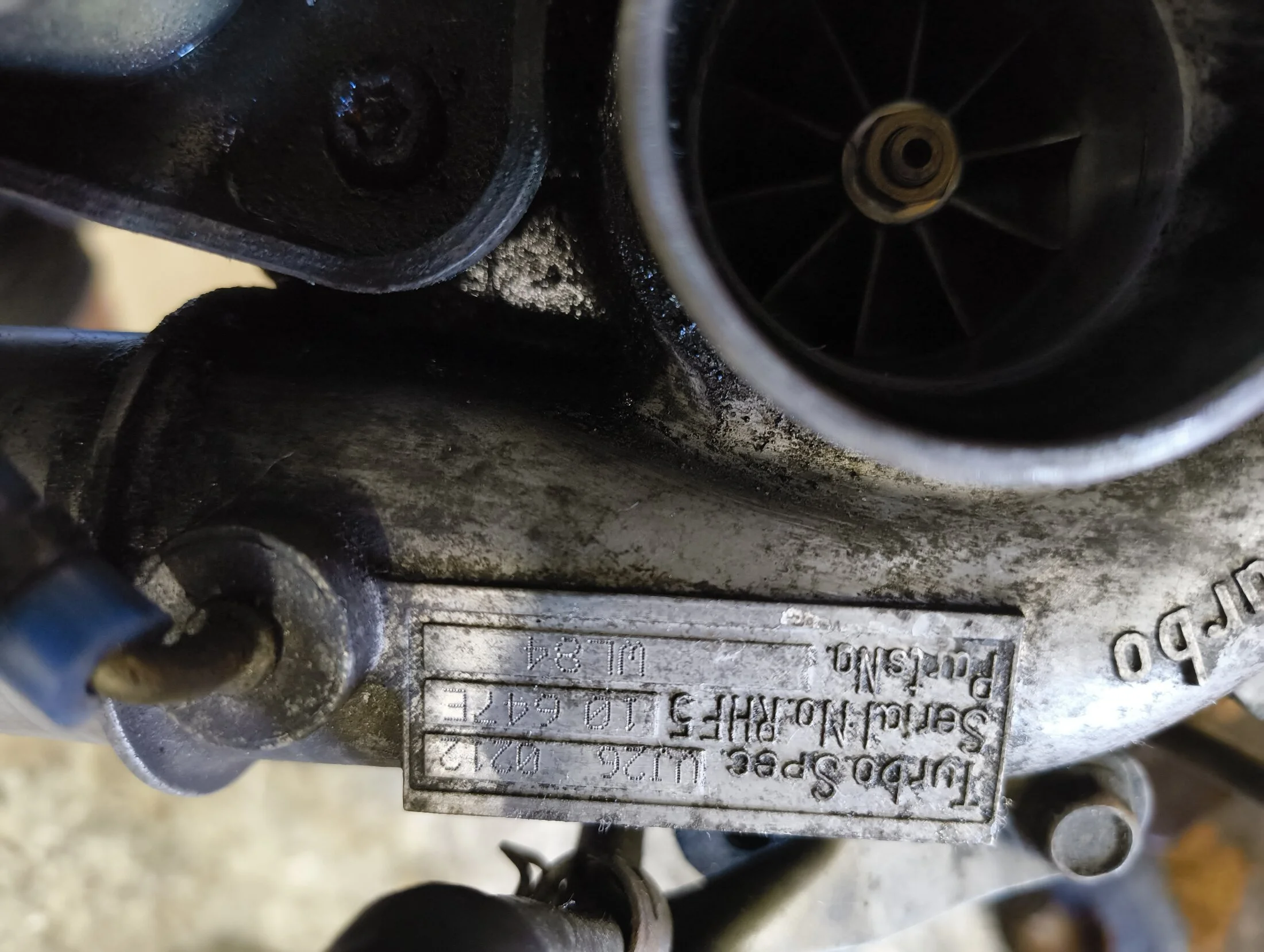

I've had no luck so far finding a TD04 near me that isn't priced ridiculously or needs a rebuild. The only working one is a Maxpeedingrods copy and they don't seem to review well.

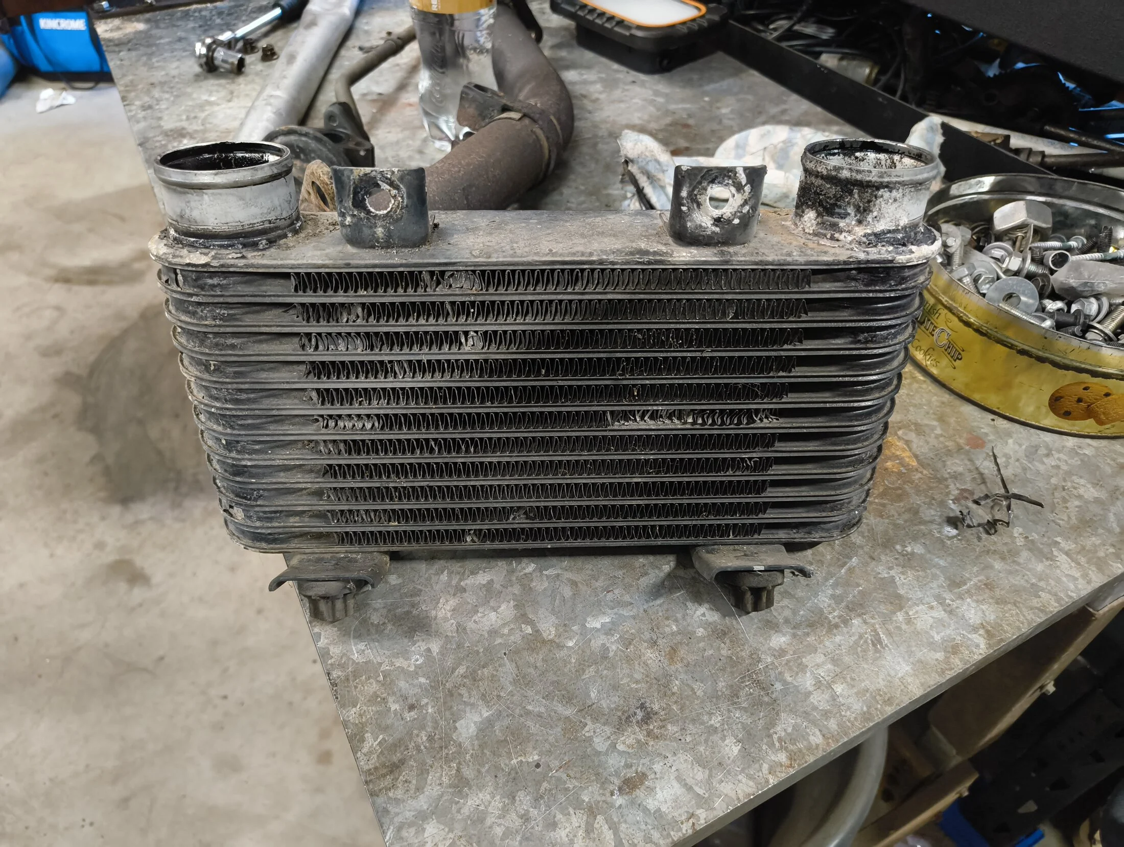

Is the WL84 turbo suitable because I do have one already with intercooler too.

TD04 you'll be looking at aftermarket copies. The Mazda turbo will work but I don't know anything else about them.

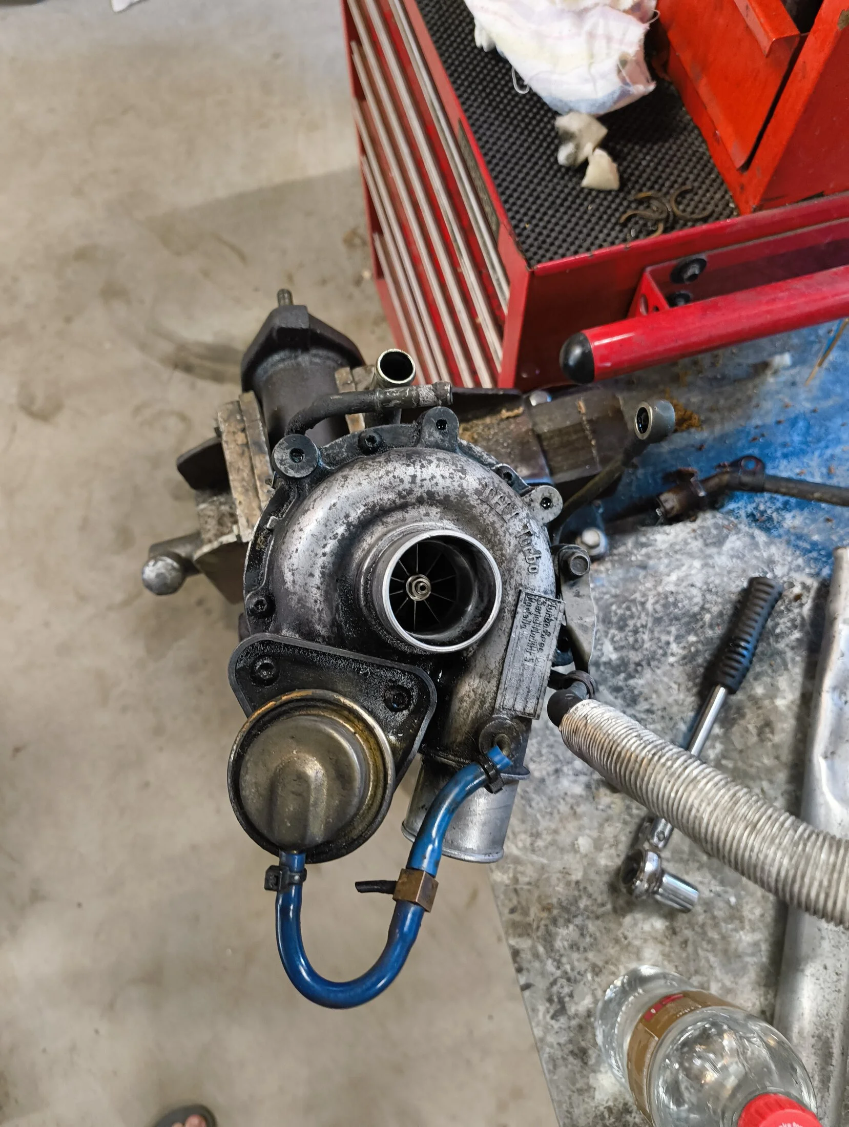

I think I'll pull apart the Mazda this week and just have a look. I might end up just modifying all the parts from it to fit to my ute, plus I remembered yesterday that it actually has a boost controller so I won't have to muck around with wastegates.

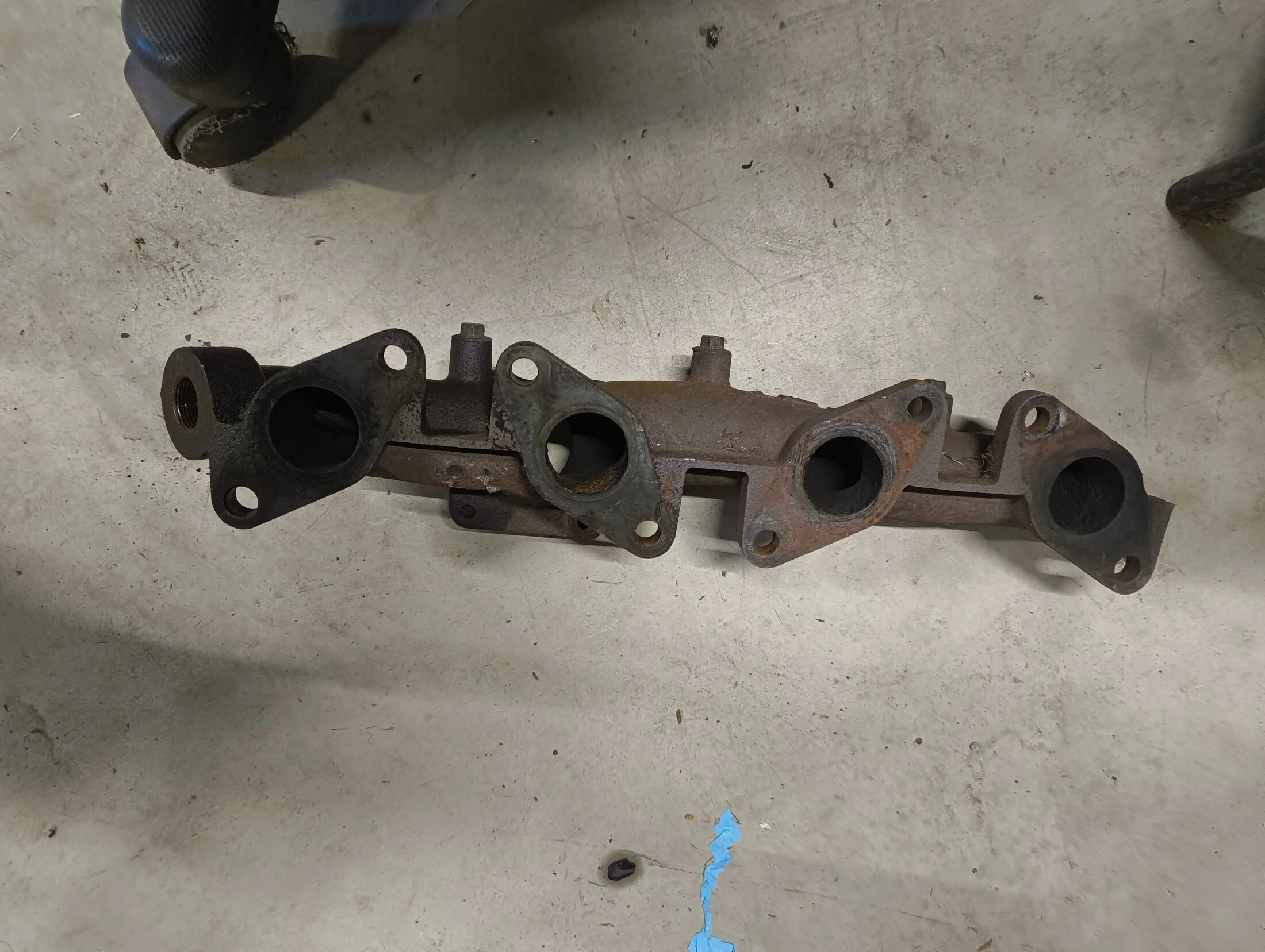

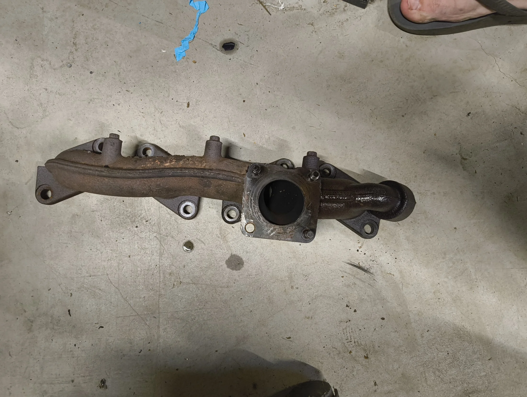

Ok so I've finished pulling all the parts off the Mazda and I think I'll just modify the manifold to fit the 5L as it seems very similar.

The WL-T seemed to have EGR so I'll have to plug that hole somehow.

I'm looking back now on the photos and the blue line that runs to the wastegate actually has a little t-joint in it so I'm just wondering where that could possibly lead to, maybe a gauge?
Now your talking. A pressure sensor needs to tap in somewhere to get a reading.

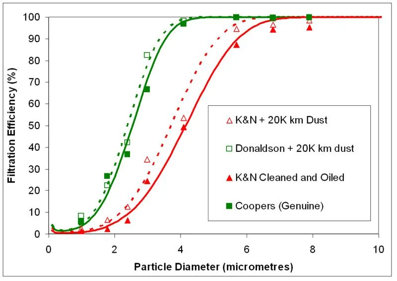

You might have noticed that all heavy machinery run donaldson or equivalent cyclonic filters. Because nothing beats them for the ability to throw out dust and keep filtering.
The 4wd action test was using 5 micron particles which are relatively coarse. Even the 'coarse dust" test has ~11% of it's particles finer than that. The AULRO tests by Ben showed a graph of filtration efficiency vs particle size and it's damning: Air Filter Tests (Finally) - https://www.aulro.com/afvb/technical-chatter/50650-air-filter-tests-finally.html
At 4 micron the K&N filter is only filtering 50% where the coopers (genuine LR) filter is well over 90%. It gets worse as the particles get finer.
I've dusted an engine once so I run a donaldson cyclonic housing now.
