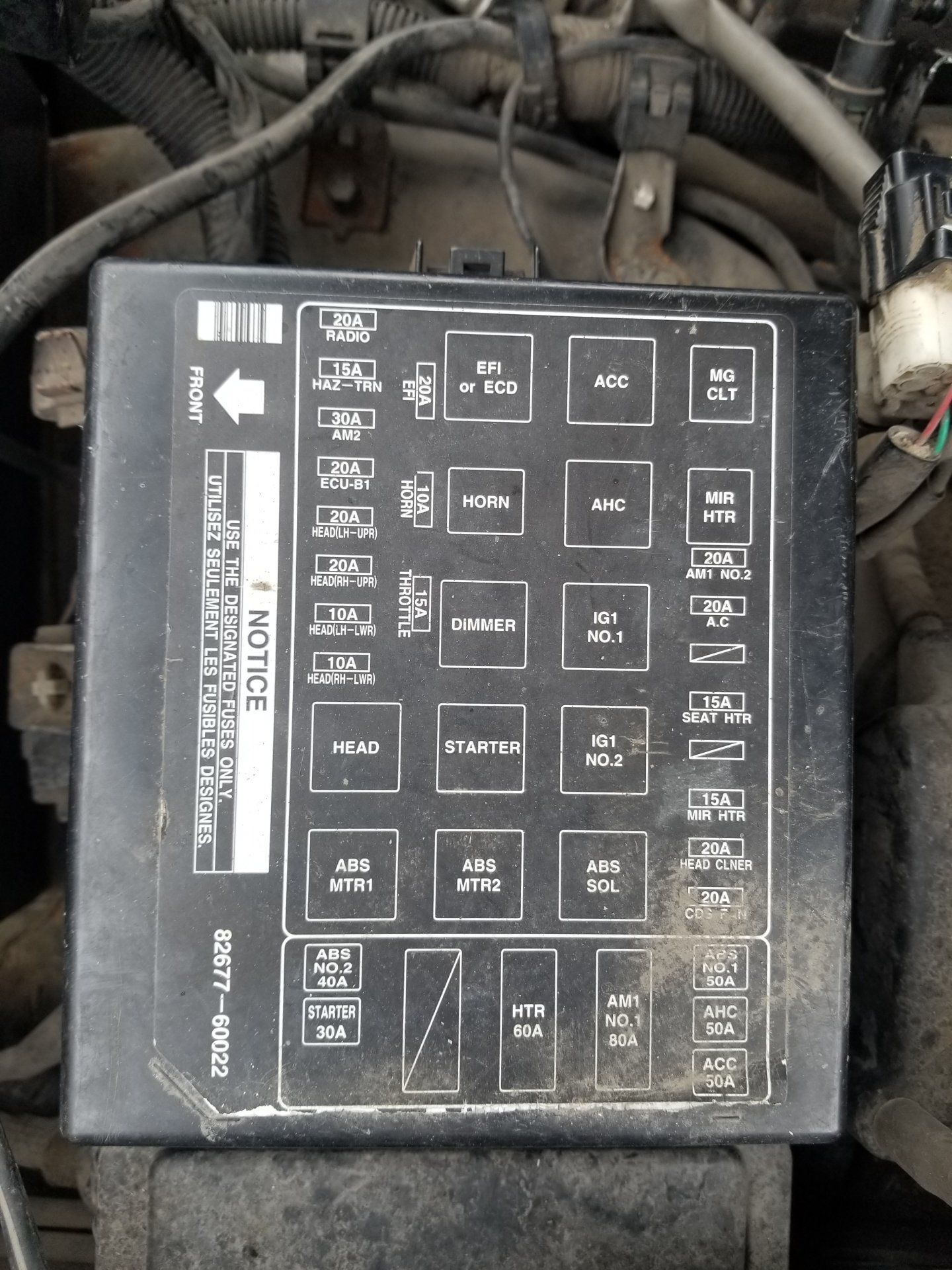

Is it getting spark? There are a couple different EFI and ECU fuses. Maybe you blew one of those.

Hey Jim, thanks. Which fuses should I check?

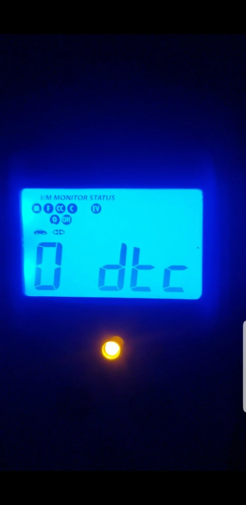

I connected the OB2 reader and got a yellow light with no codes to read.
