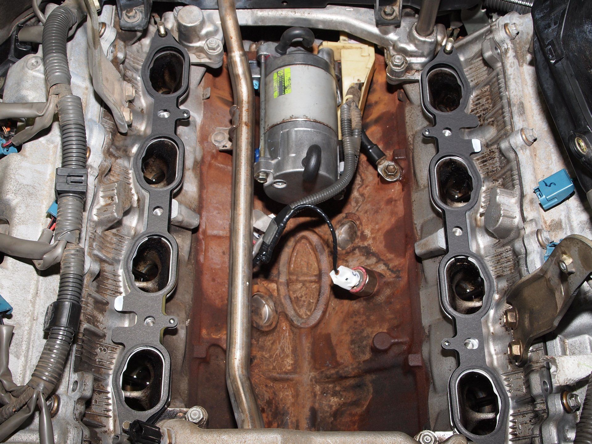

Thank you 2001LC...here are pics of front, drivers & passenger sides...I have arrows in the DS pic showing I replaced 2 PVC hoses & The T joints near the firewall...the T joints crumbled they were in such bad shape. I removed and cleaned the Throttle body and confirmed the butterfly is working properly. I tried starting it today and as soon as it turns over it will die. I did not smell any gas fumes today. Thanks for your time and input...The old start should have damage easy to spot, if you dissect. If it was truly your issue.![]()

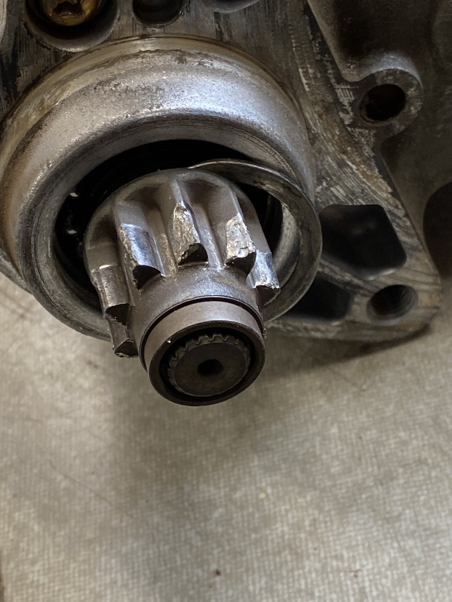

I've seen starter drives falling apart, still no sound. It could make a "loud scratching noise', but not common
Here's one, that was not the typical contact and plunger failure point. The vehicle had remote start, and for years it had starting issue, before brought to me for a starter job. I suspect the remote start or operator of, engaging start, while running (many times)!

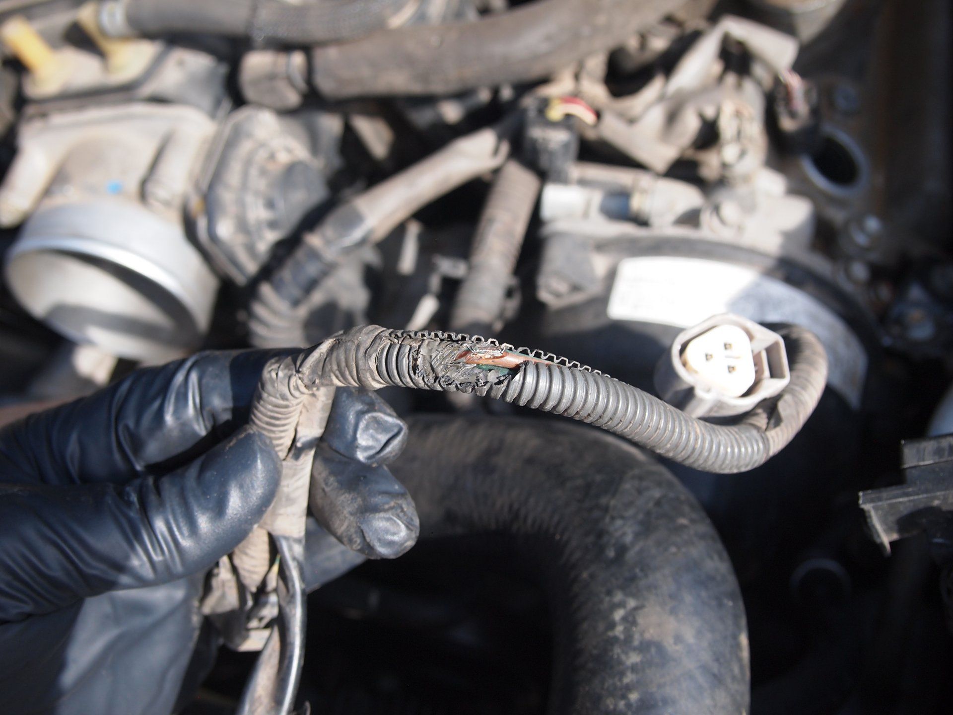

Very often during timing belt job, crank and or cam wires, not properly routed or secured. Post some picture of front of engine down LH side (driver side), may be revealing. In this one, serpentine belt rubbed on crank sensor, oil sending unit wires that were not routed properly. Sometimes the cam sensor wire get rubbed also.View attachment 2491404

Was intake manifold gasket install with proper orientation (white tips up and out)
