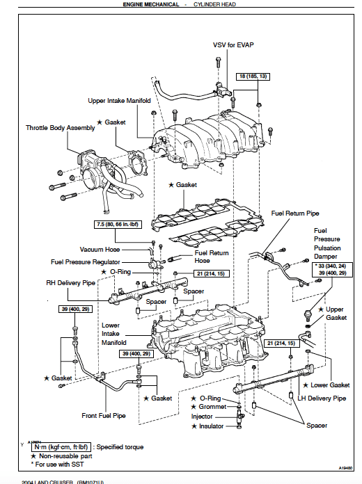

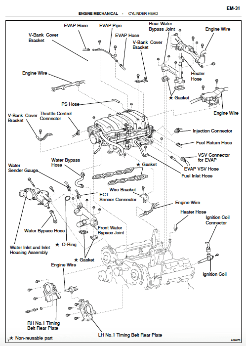

When you removed the intake, did you remove as one entire unit, or did you separate and remove the throttle body in the process? Did you use all new gaskets? RE-Check every connection related to removing the intake:
This is for 03-05 but should give general idea of connections etc

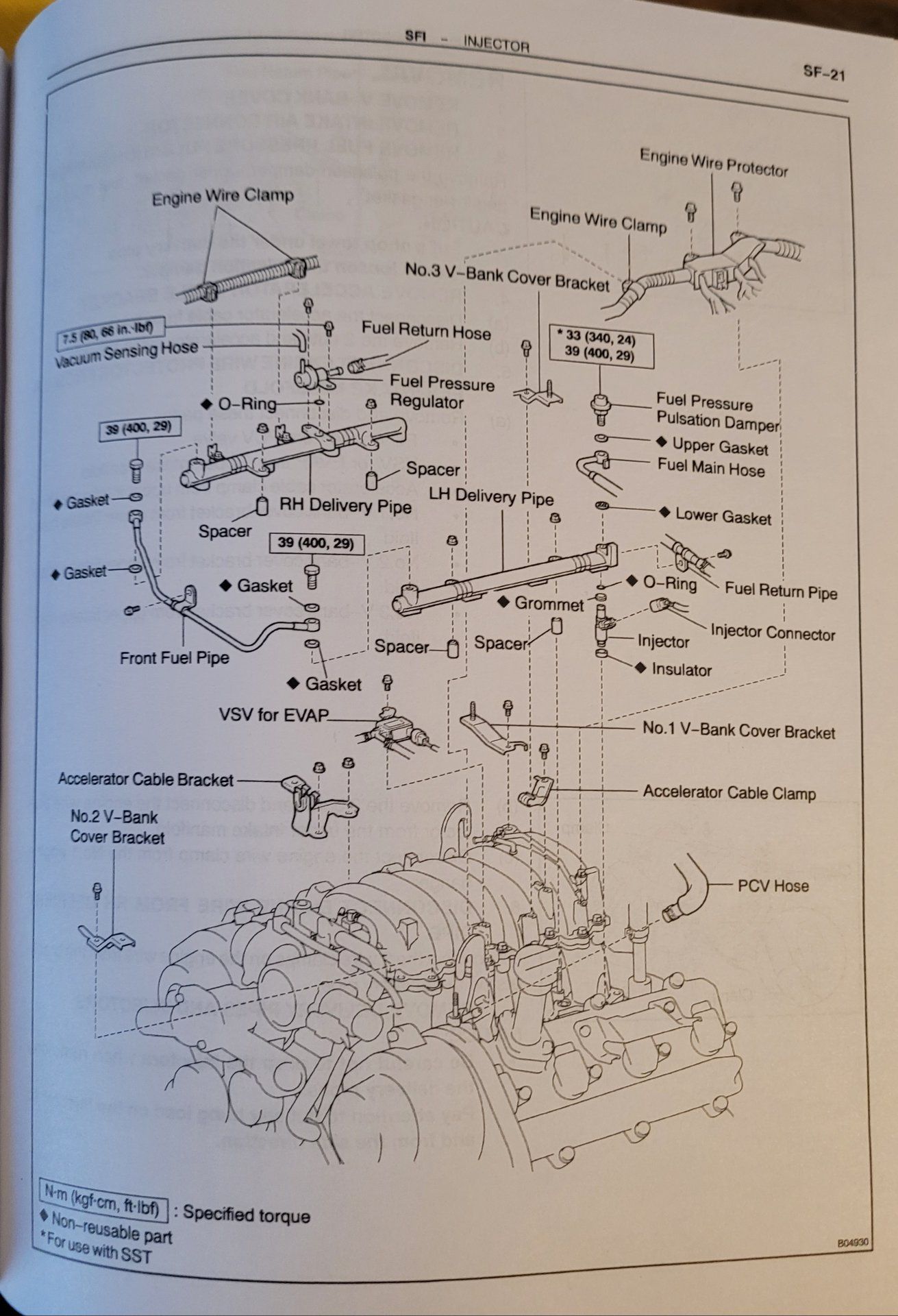

View attachment 2491366View attachment 2491368
Thank you abuck99...looking at the diagrams the one thing that stands out is when I reassembled the fuel pressure pulsation damper, there were no gaskets. I do not remember any gaskets with it when I initially unscrewed it. Do u know if the 2002 LC fuel pressure pulsation damper is supposed to have gaskets? Thank you.
