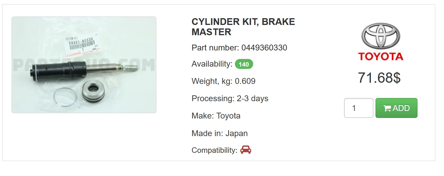

This is the Master Cylinder rebuild kit.
From your observations, it does not appear there is anything wrong with the electric motor (it pumps up the pressure in 35" within spec). A failing motor would result in only manual brakes and a squealing alarm. I rebuilt my MC with the above kit and the electric motor (with new internals from a reputable supplier on eBay) at 315k miles as preventative maintenance (I spend a fair amount of time on mountain trails). I did notice improved pedal response from the new MC kit. There was nothing wrong with the electric motor, per se, but the commutator was worn quite a bit and it was a matter of time.
Partsouq is not going to be the best source for a complete brake assembly. Catching one of the dealers during the 25% off sales will get it in the $1100 range, IIRC. I would either rebuild it with the above kit, or replace the whole thing. It doesn't make economic sense to replace any of the larger parts vs the whole thing.

Something to check - does the pedal get stiffer the more time you pump it (get your mind out of the gutter ;))? If so it is definitely the master cylinder seals I described above.
When driving normally, where you apply the pedal at the end of the block when you hit a traffic light or something, the stroke of the pedal is about the same (long). However when I tried to press the brake once, and then immediately press it again, it was stiffer.
