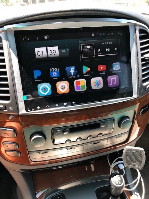

I installed a Seicane 10" touch screen in my LX470. The set-up looks good. The A/C controls work very well through via touch screen controls. That said the rest of the system is glitchy. It's really like having two stereos. The AM/FM radio on the stereo work ok. When you switch over to the Apps section of the stereo, you literally turn off the existing stereo to turn on the App functions for Pandora, Apple music, etc.
I understand what you mean regarding the glitchy app switch over and that is definitely a problem for me. I have that similar issue in my DD Ford F-150 and it sucks. So may be indicative of the way the software is written. Very poor for sure. Are there other options and the biggest question I have is the A/C controls.

Merbesfield- I am not aware of any other App or stereo on the market currently which will give you the AC functionality you are looking for. There are a lot of threads on this topic and most applications seem to be going to a Double Din set-up and keeping the existing AC controller. In my case I also have the Mark Levinson set up to deal with.
