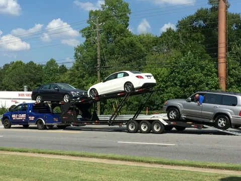

Here it is on the transport heading home. Should be here tomorrow night or Sunday morning.

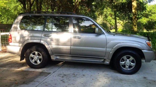

Well here it is. It arrived this morning. Took it for a drive with wife and we like it. It feels solid to me, but im no mechanic. Ill take it to my mechanic and have him look it over. Hopefully he does not find any major issues.
Not sure if the suspension is still in good shape or if its sagging or time to change shocks. The ride felt fine and comfortable. Will keep the step for now for the wife, but it has to go. I wonder if i can get rid of the body side flare molding too?

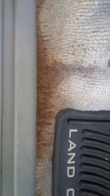

The carpets are dirty so will need that cleaned. Seats have cracks in them too.

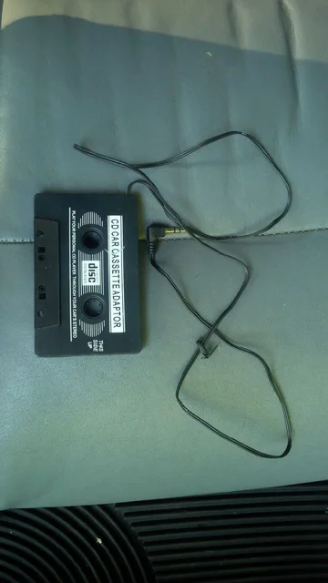

First mod. lol The radio sucks and the front DS speaker is blown/shot to bits. Gotta get a radio and speakers eventually. Not sure how long i will last with the way it is.

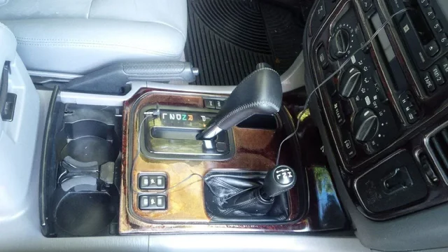

The wood HAS to go. It looks really bad.

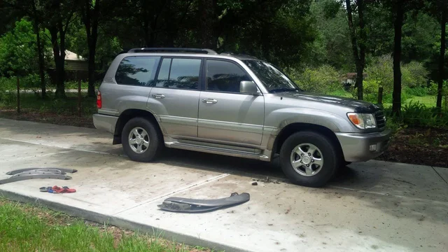

I removed my running boards and fender flares today. I was a little nervous about removing the flares, but there was not as much damage behind them as I thought there might be. It needs some touch up around the back door area, but the front looks really good.
[/url][/IMG]
No. No holes in the body at all. They bolt, screw and rivet in on the back or underside of the fender. When you remove the piece around the bottom of the back door, there are 2 screws that look like they go straight into the body. I cussed a little when I first saw them, but they don't actually go through. I used 3M automotive adhesive remover, an old t-shirt and my thumbnail to remove the glue and gasket remnants left on the body.
This is what's under the flare in front of the rear wheel.
The 2 screws hold clips that that goes inside the lip of the door. One on top, one at the bottom. Undo the screw, fiddle with the clips and they come off easily.
Here's what you're left with after removal.
It's not as bad as it looks. Mostly dirt and adhesive. Here it is after clean up. There is a spot where the flare has rubbed down to bare metal.
That is the worst damage from the flares on mine. The other side was similar, but smaller. It was only the 2 flares in front of the rear tires that caused any real damage. The others just took some cleaning. If you look close, you can still see where the flares were. There is kind of a line or the paint is slightly different where it's been covered for 10 years. I'm hoping after a light compound and polish, you won't be able to tell they were ever there.

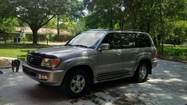

Well flares gone. Such a crime they get put on. Really hate dealer add on's.
I have a 1 inch rust spot on passenger rear that will need touching up before it gets worse. I'm going to have the detailer do a clay bar and the whole truck to get all the gunk off.
