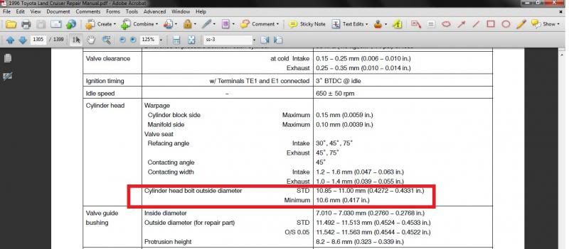

On the head bolts...would you recommend new ones even if they are within spec per the FSM? Those little bastards are expensive. $13 each x 14 bolts! But in the grand scheme of things it's a small amount to pay for peace of mind I suppose...

I've read a lot of conflicting info about the head bolts. The fact is the FSM doesn't say they are one-time use, and in section SS-4 it gives the specs to measure the bolts, so that gives me the impression that they're reusable. I'm torn on the subject....
I'm most likely wrong on this, but maybe the FSM is referring to checking the specs on new bolts. Making sure you got new bolts that are within spec. I hate spending extra money too, but repeating most of the head gasket work would be brutal in mind opinion.
Nope, the FSM refers to checking the old bolts. It says to replace any that don't meet spec with new bolts.
Checking the spec on new parts doesn't seem likely. I'm like you, I hate buying stuff I don't need. If the FSM says they're not reusable, I'd have no problem buying new ones. But I'm just not sure on the head bolts. Here's another screen shot. FSM shows non-reusable parts with a diamond character. Nothing on the head bolts
I wrench for a living, everything I have seen always has a note saying to replace bolts if they are needed or to check them.

I believe if you clean the threads in the block and on the bolts, you will be okay if you lube the threads with the suggested lube in the FSM. I'm thinking motor oil?
These bolts stretch when they are torqued. In doing so, they suffer a reduction in diameter each time. There is a specific section you need to measure.
