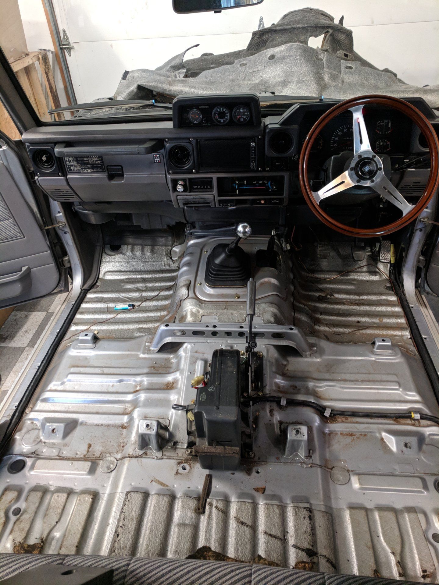

So everything came off of the floor

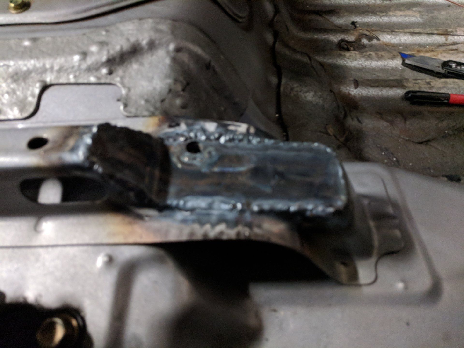

Then the original floor bracket had to be slightly modified:

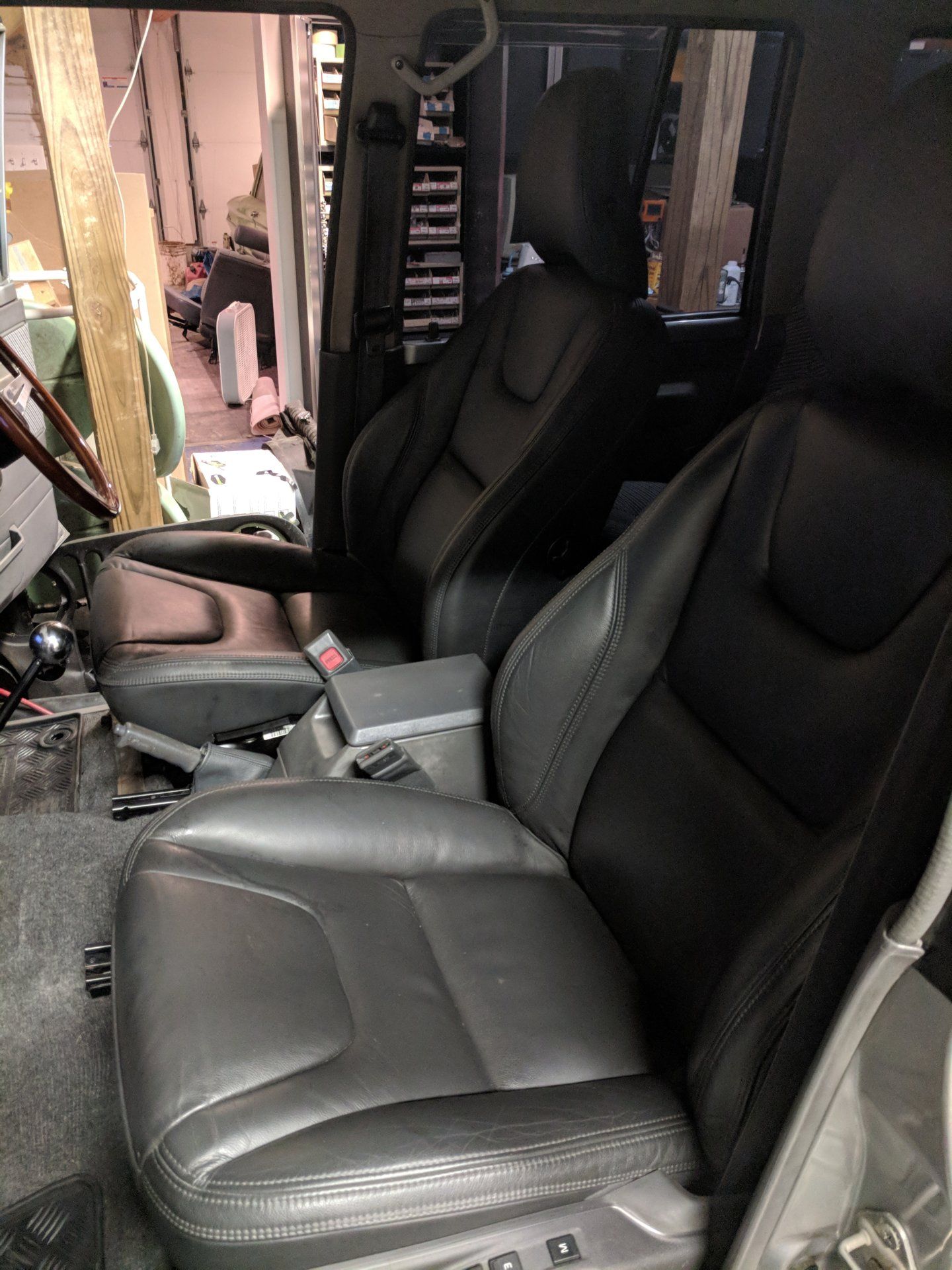

Then after adding some insulation on the floor. I made some brackets for the seat frames, and wired in a converter to supply the 12V power for the seats, and in they went.
They are heated leather seats out of a Volvo S60, but as of right now I still have to figure out how to get the seat heaters to work.

What was wrong with the original seats? I have been thinking of changing my own seats (in the PZJ70) but it is hard to decide on the many aftermarket seats out there for sale.
The original seats just had the typical wear (ie. The drivers side foam had failed on the outside and been ”repaired") the fabric was still in pretty good condition thought.
My biggest reasons for the change were actually increased adjustability, and the leather. Leather sounds like an unnecessary item, but if you like watersports it is really a necessary item to not be soaking fabric seats all of the time.
