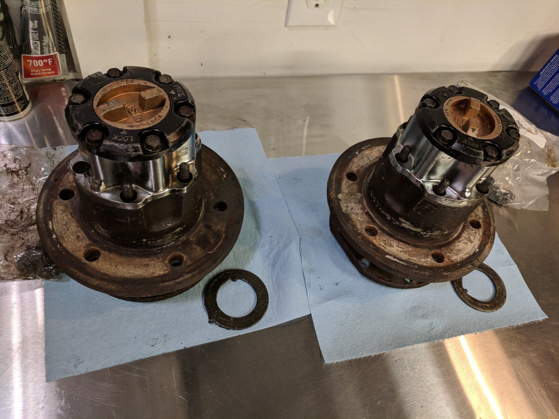

So instead of cutting into a new bumper to get it to fit I switched over to a long neglected project of the front hubs.
It came with the notoriously unreliable power locking hubs, which of course only one of the 2 worked most of the time. So over a year ago had purchased some used manual hubs, and everything to rebuild them. Then the engine blew up and they sat on the shelf for a while so the first step was dusting off the parts

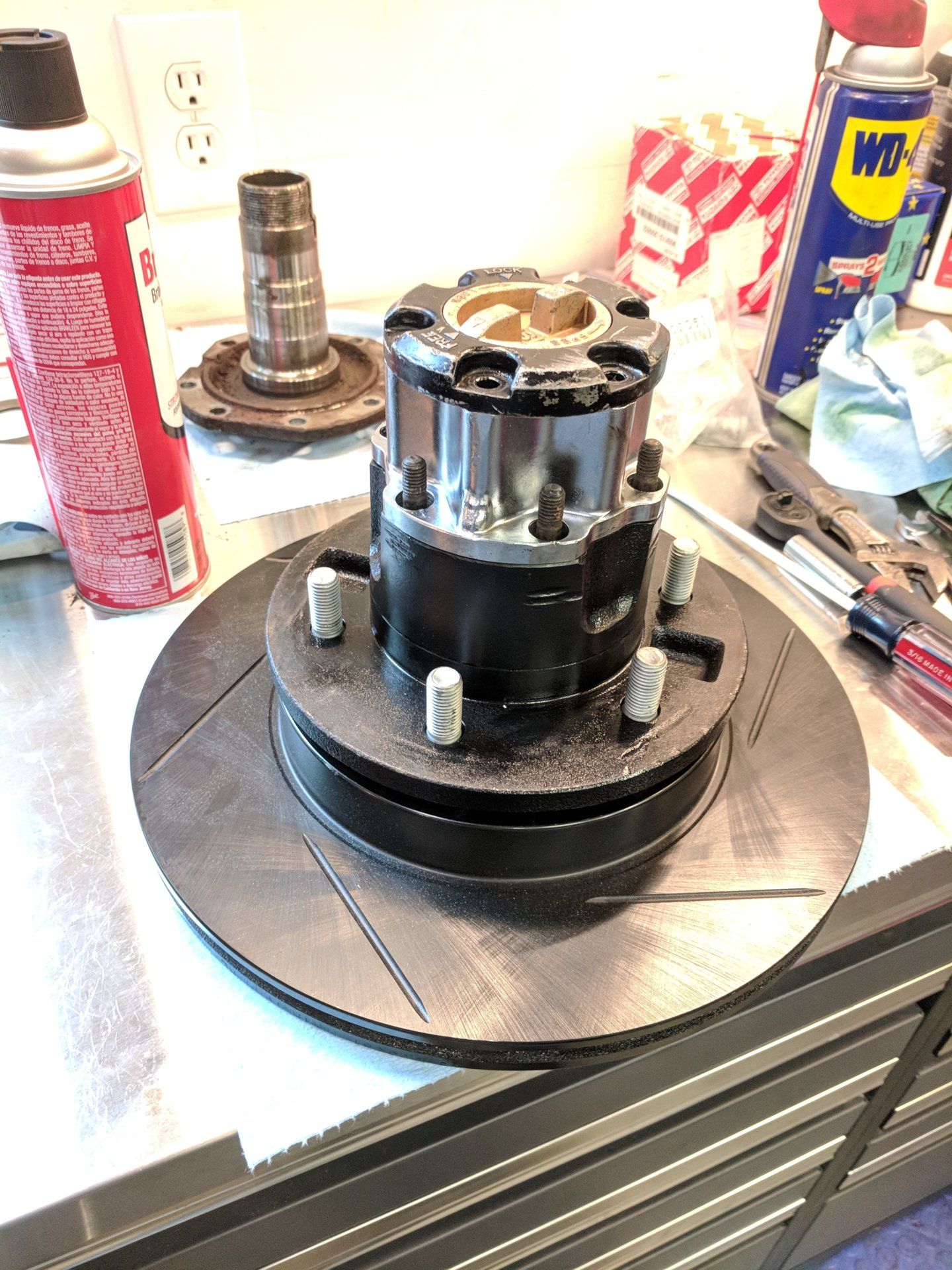

After a little bit of sand blasting they were painted with engine enamel (to withstand the brake rotor temps), and then new slotted brake rotors were attached with new studs.
Did you replace the spindles? Or, did you use a spacer kit?

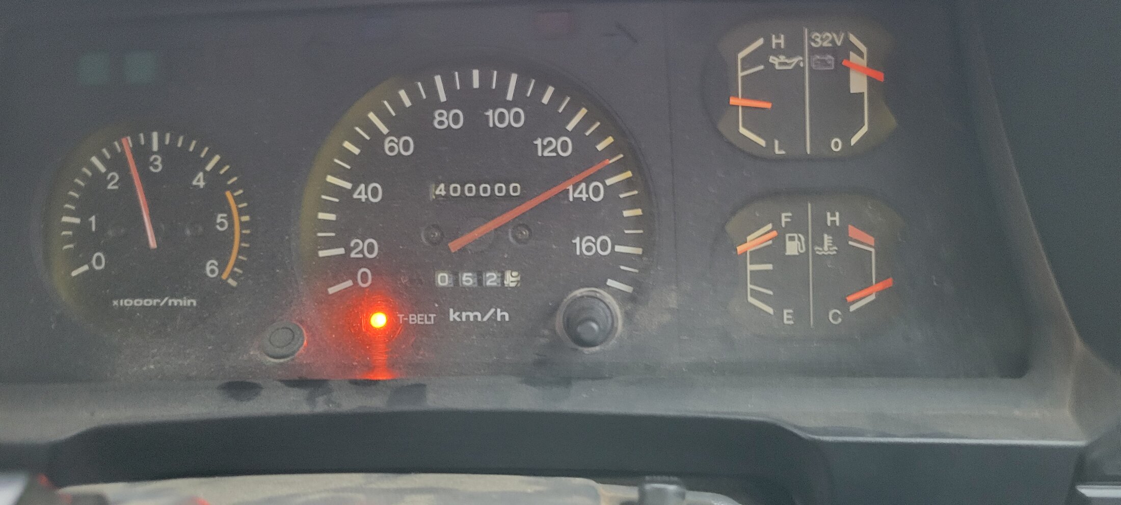

So it has been a little bit, but just hit a milestone so seems like time to update the build thead:
(Note the timing belt light came on just 5km earlier)
I am shooting to make it past 500k.
So in the last 6 years a 100,000km, it has been doing what Landcruiser do best and being a reliable vehicle that does anything asked of it.
Congrats, mine just turned 300k and the T-belt light came on at the same point. I changed mine 30k ago but now I got the urge to change it again! That damn light!
