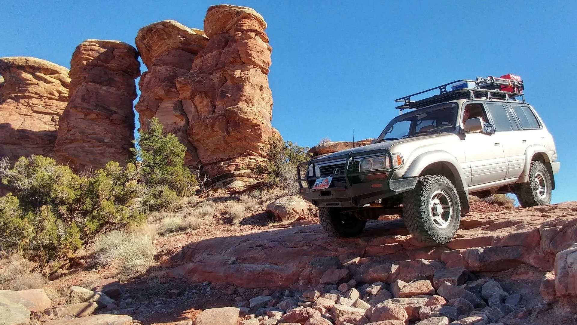

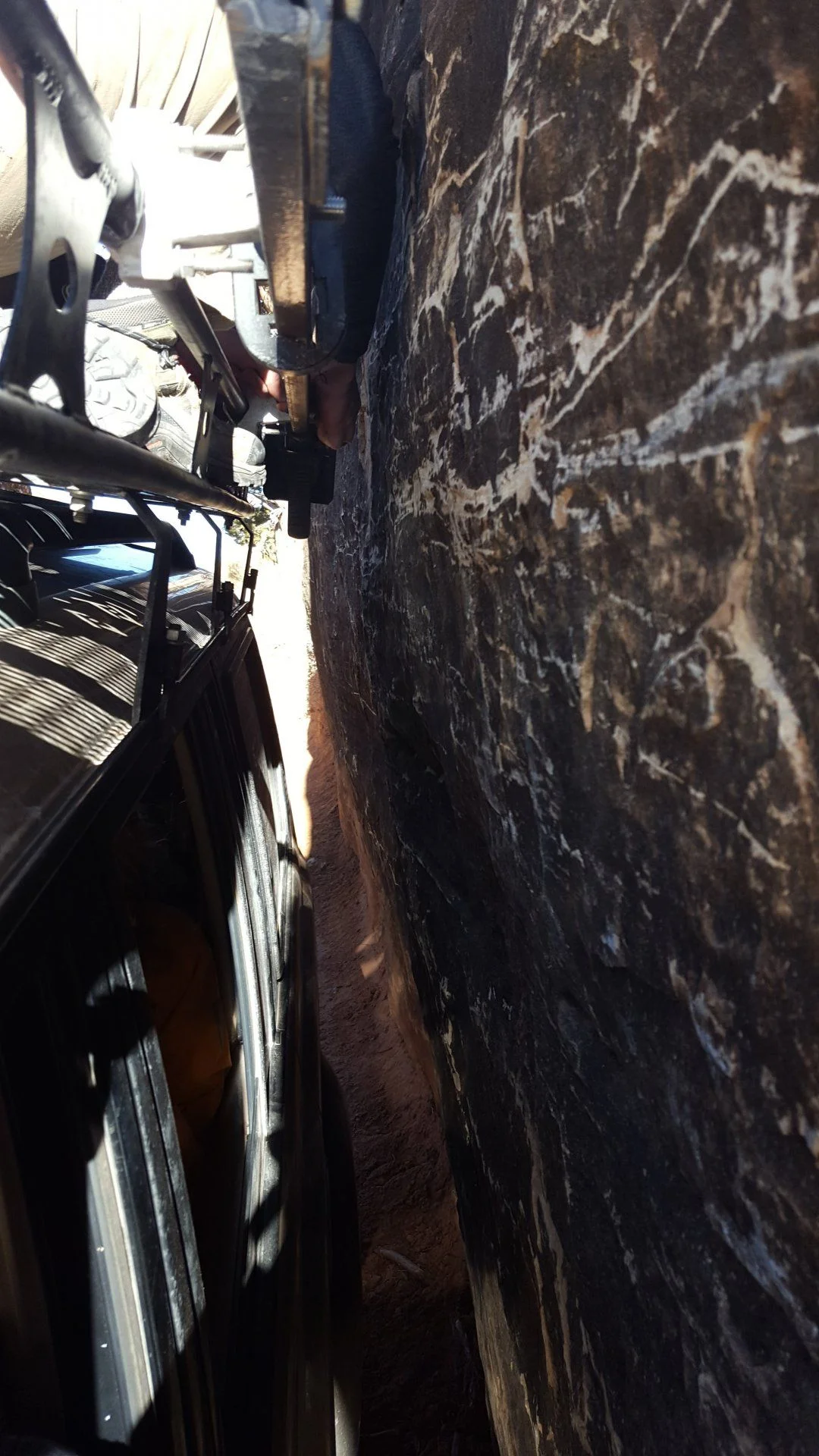

To your question about whether a good roof rack could have prevented this: It depends. Mine prevented body damage on a trail where I had a bad spotter. It's clear from the picture I wasn't the first to take the bad line on this trail and scrape up the top of my truck. Looking at your pictures I think my roof rack in the same situation would have prevented me from getting hung up under the tree, but so would an extra 2 inches of lift on your truck. I imagine there are times the roof rack becomes a snag, as well. I love mine and consider it part of my armor.
As for fender flares, sometimes you just have to become a better driver. Other times, it doesn't matter how good you are, you're going to scrape or have the trail remove them. IMHO, When the first one comes off, they all come off, or you should add armor to protect them.

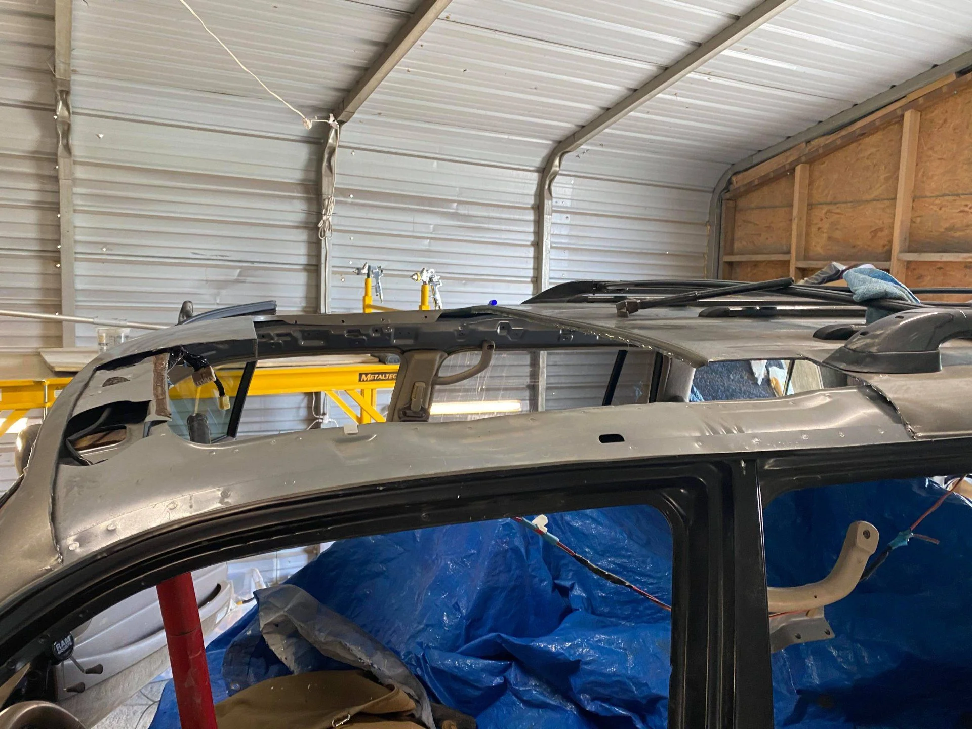

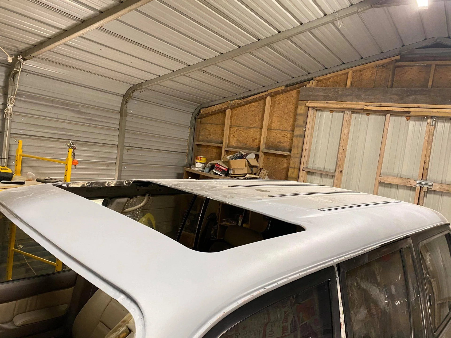

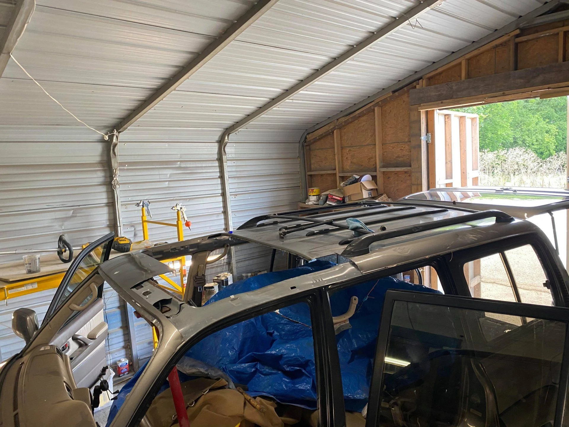

Alright, the shop sent me some pics so I thought I'd share with you fine people. The main roof damage has been fixed and the roof rack will be completely removed and welded up. I'll take it home this weekend and Dynamat the roof while the headliner is off and we'll cut the panel to weld in. Then, back to the shop for all the final grinding, sanding and spraying. As far as I can tell in these pics it's looking great.
