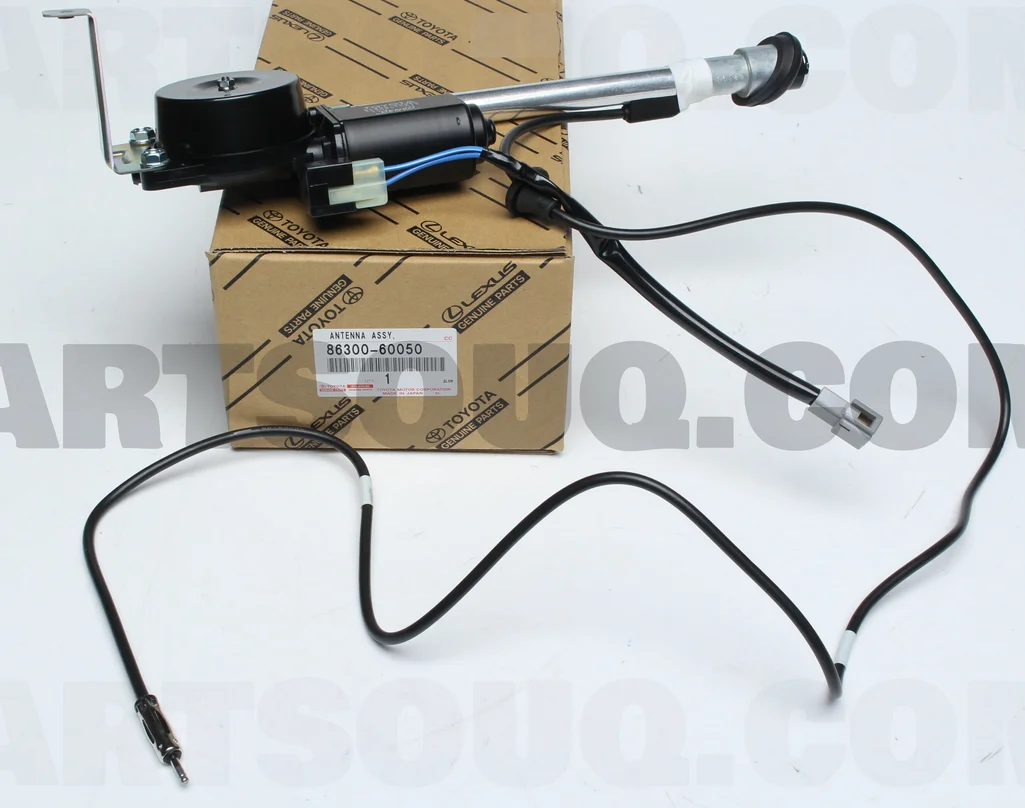

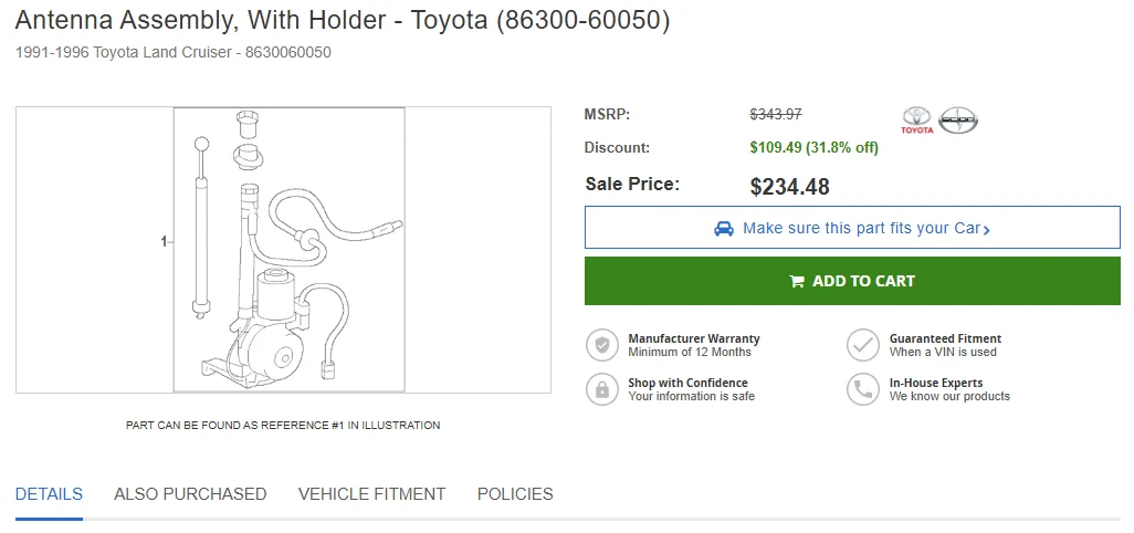

Order the antenna for the '95-'97, 86300-60050; yours isn't available anyway.

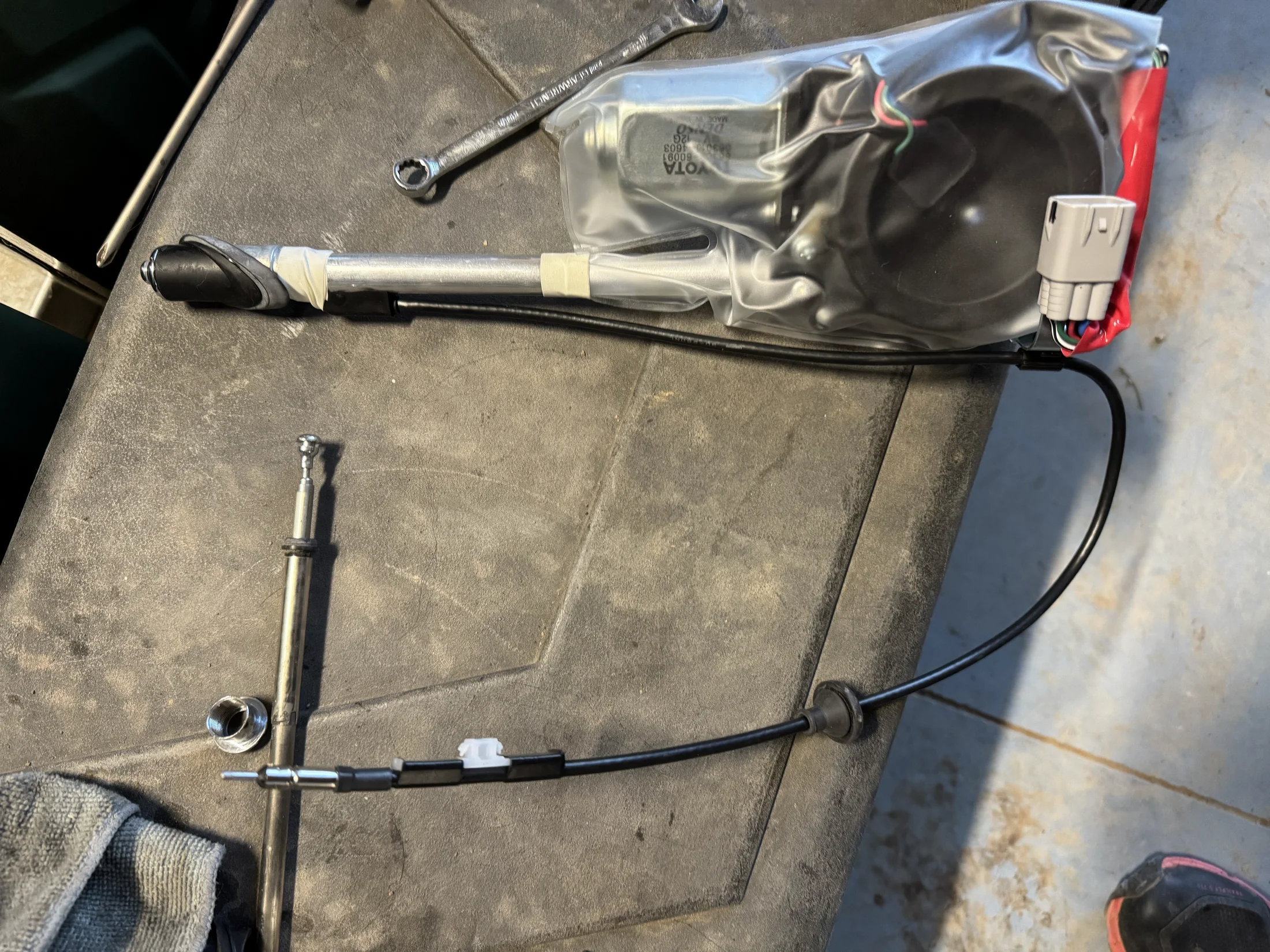

My new antenna assembly came with a new gromet on the wire. Once I had it fished in a firm pull on the cable from the inside popped it into place.

The price has doubled since I bought one two months ago. Sheesh.
I got the -60050 on eBay new for 137 bucks.

Hoping somebody can help me with this same project as I am stuck. Does the new unit plug directly into the back of the stereo? Maybe I bought the wrong one. The cable does not look long enough to reach the stereo as it is attached at the bottom and only has 4 inches or so after the grommet. It also has a clip after the grommet. I assume that plugs into the firewall behind the glove box. How much of the components under the dash should I remove to access the antenna wire? Thank you for any help you can give.
Yes, it plugs into the lower right corner, as you're facing the stereo.
The correct part number is 86300-60050.
