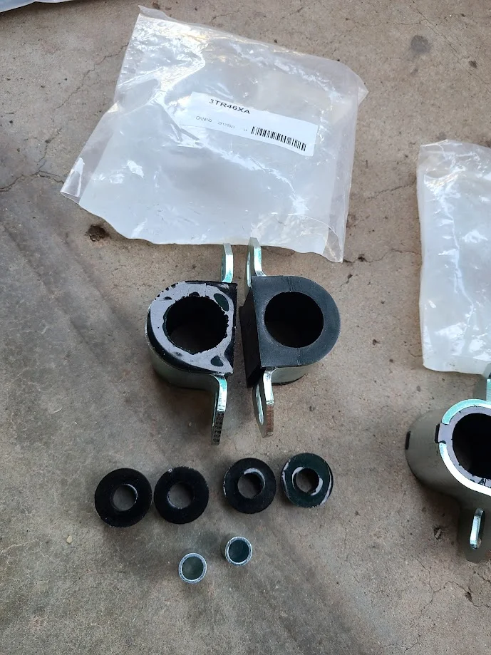

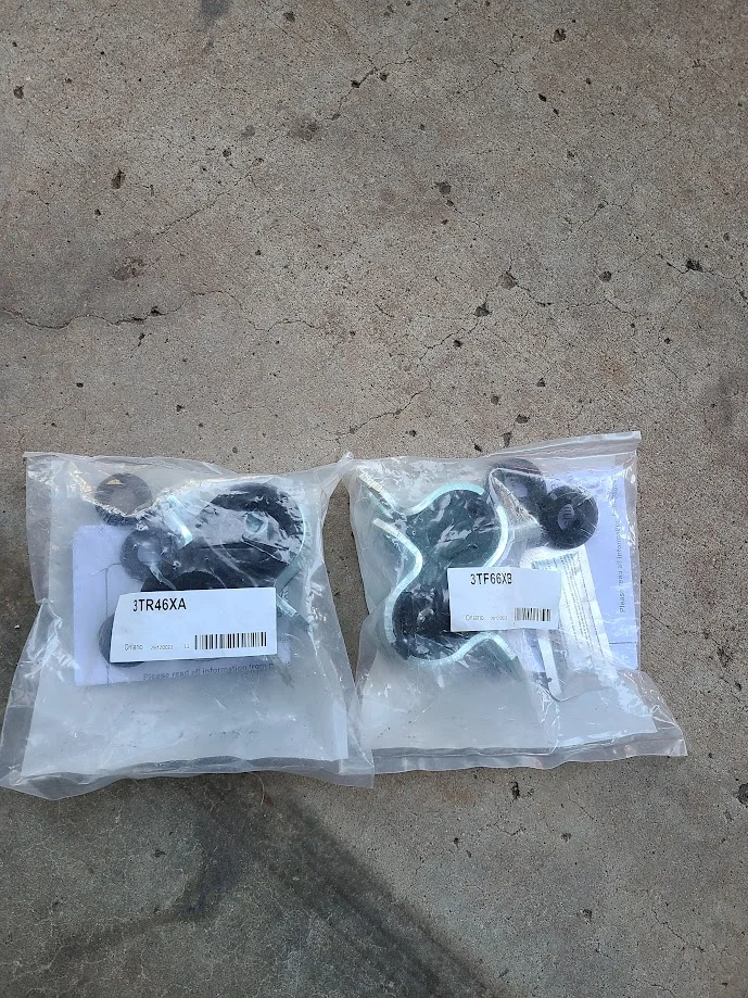

If you have the 33mm front + 30mm rear whiteline sway bars and are wanting to replace the old bushings, here's the info you need. Their USA website doesn't list them but their AUST website does. I had to speak to one of the USA folks to create an invoice for the part numbers in this post. I bought two kits that contain the end link, and mounting bushings as well as the metal mounting brackets, $80 shipped via FedEx for free.

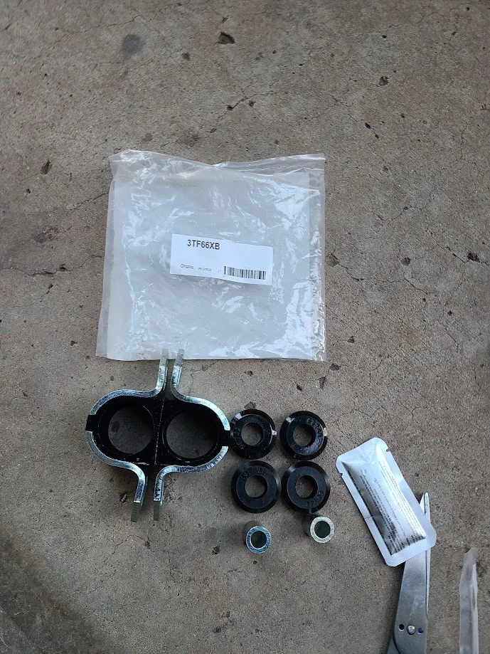

Incidentally, the rear sway bar originally came with rubber one piece end link bushings, and these are now two piece poly bushings, just like the front. The trick to quickly ID which bushings are for which sway bar, the thinner inner metal sleeves are for the rear 30mm bar. They both have 10mm ID but their OD is different.
I wanted to add some more details. The front sway bar "outer" bushings are SKU W23526. These aren't on the Whiteline USA site but are in their AUS site link
If you need the rear outer bushings, they're SKU W22107, which are on their USA site.
I have a call into their CS to find out how to order the front outers.
Alright, finally ordered SKU 23526 from USA Whiteline but they had to separate a kit that also contained the center bushings, which I don't need. So, if you're wanting to order JUST the other bushings + inner sleeves, call up Whiteline, ask for Edward. The other techs were hard to deal with but Edward is awesome. He doesn't know why the USA branch doesn't carry something that the AUS branch does. Cost was $25 shipped.
