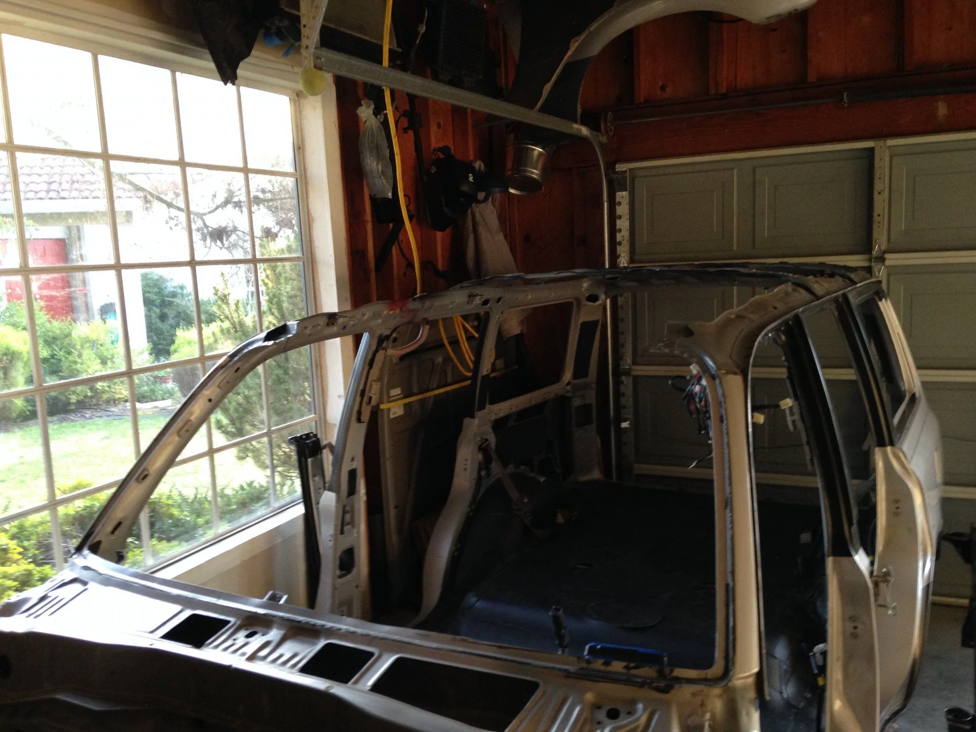

Windrock has changed! There are bamillion spot welds in the gutter and along the tops of both FR and RR glass frames aka under the weatherstripping. Apply a chinesium grade spotweld cutter from Eastwood and just go through the skin to seperate the body panels. It's super thin. Like all body work start really minimally for cuts and go a little deeper as needed. I used a tiny drill bit to put a notch in the center of the OEM spotweld so the spotweld cutter wouldn't walk (as easily). Grind out the brazing on the A and D pillars. It'll be a gold line under the paint that follows the space between the spot welds. That's all that holds the skin on. The roof supports are "glued" but are likely not stuck on anymore. I have done three skins and all of them had separated.
Sawzall the donor skin below the braze mark and gutter and it will fit on the top of a large SUV with some straps and 2x4. I was able to do one by myself, and another with the help of a gimpy friend with one functional arm. It's not that hard. Just based on what I've seen I wouldn't cut in to any of the ABCD pillars. I would recommend only peeling off the skin. The pic below has the top of the windshield frame removed which I don't recommend. It was part of the learning curve and unecessary.
You can 110v mig it back on and use all manner of 3m adhesives to put it back together. Or take it to a shop with a proper spot welder and adhesive dispenser. HTH just a real down and dirty for the roof swap idea. Like most here I'd bet a shop can hammer that out pretty well.View attachment 2371470
