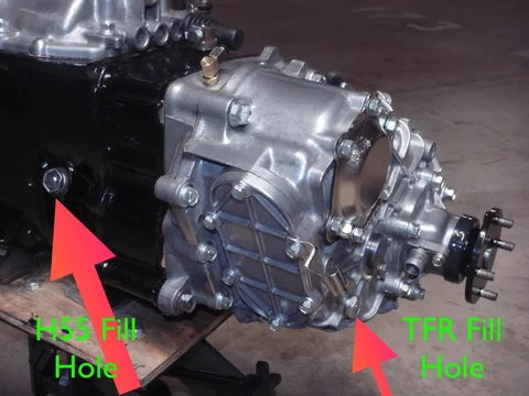

If I recall the fill is on the drivers side up close to the floor. Someone correct me if I'm wrong :)
It will never leak externally. It can leak internally into the transfer case. Check the transfer case oil level too.
It's never leaked oil of any kind (strange I know) but I'll ckeck today
Where's the fill on a H55?

Figures It'd be pouring after work, but I did check the fluids. Roughly an inch below the fill hole on the H55...so low but not "that low"
