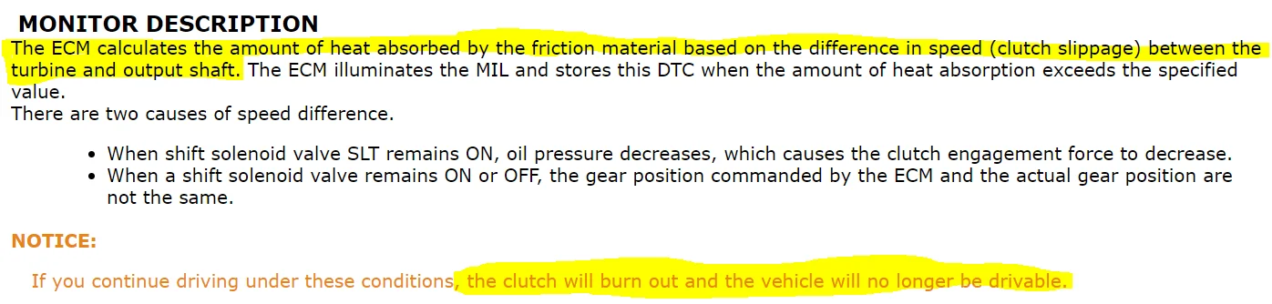

The issue with the valve body wearing out is explained very well here: Diagnosing Solenoid Performance Faults in A761, AB60 & A960 6-Speed Transmissions - https://www.sonnax.com/tech_resources/345-diagnosing-solenoid-performance-faults-in-a761-ab60-a960-6-speed-transmissions

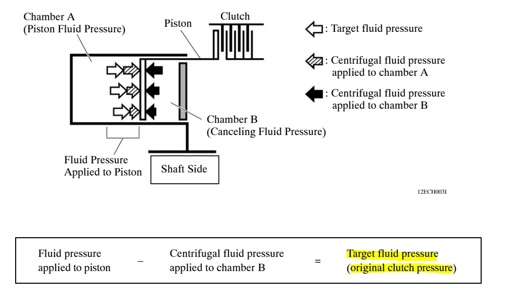

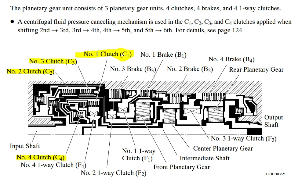

I am starting to think this has more to do with a friction, ultimately. Factors contributing to friction may be the fluid itself, pressure, fluid content, friction surface. The solenoids control fluid to the clutches. If it only happens when the fluid is cool/cold, and has happened mostly with southern cars - hotter fluid temps - then maybe that indicates a slight degradation with the clutches.

There is some school of thought that the clutches get worn badly when it starts throwing the codes so it may already be too late to save.
