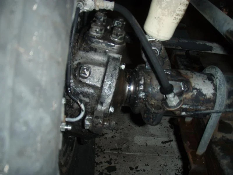

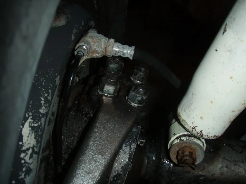

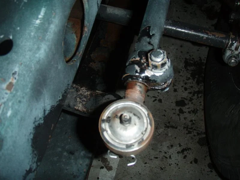

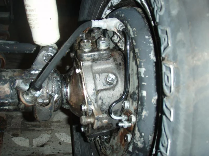

After shots
1st attempt after shots:

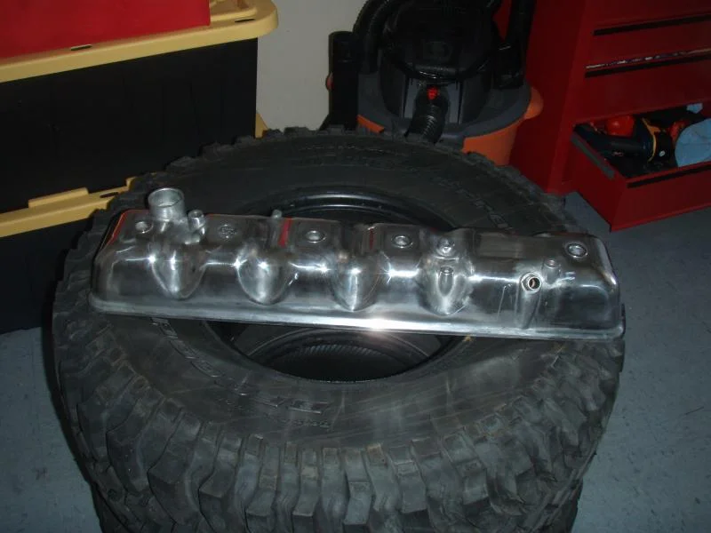

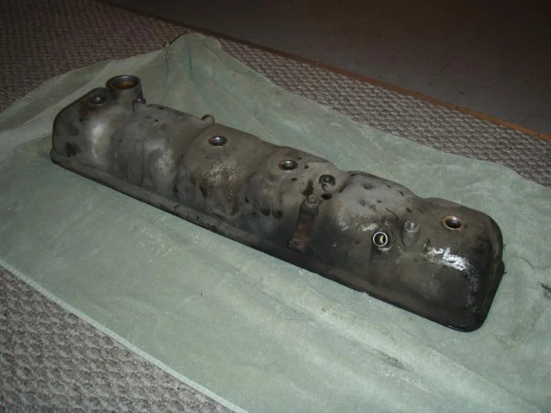

Putty knife, wire brush, oven cleaner, power washer.
How much to make my valve cover look like that?
Rebuilding those knuckles just got quite a bit more pleasant. Good work there. See you in the morning.
Ha! Thanks...I figured it would be better to tear them down minus the inch thick layer of crud.
